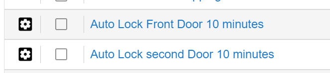

Just create the auto-lock for the first door, and name and save it. Then create an auto lock the same way for the second door and name and save it, and so on.
It'll look something like below in your Apps list:
Gotcha, I didn't catch that the name field was editable.

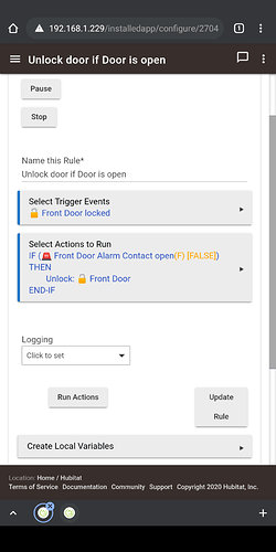

I have a ask for an enhancement. I have the Yale SL zigbee locks. You can manually lock them by pressing your palm against them on the keypad. It's a neat feature but, if the door is open and I accidentally brush up against the keypad the bolt comes out... and since the door is open the bolt slams against the door frame, making no one happy....
My request for enhancement is that you add a check to see if the locks changes state to locked while the door contact sensor is reporting open, and Retract the bolt. Ideallywithout loosing the timer for when the door should Autolock. I assume (I should have verified this) that the Autolock timer doesn't start counting down until after the door is closed.
But automatically retracting the bolt if it comes out when the door is open would be a very nice feature!
Thanks!
I did play with it in RM4. worked well. However, the autolock app stopped locking the door once i put that in. Could have been a coincidence, i'll debug a bit tonight.
I generally like the idea of having all automation related to a behavior in one set of automation so in case an update adds capability there is no risk of accidental conflict.
Just giving you options. I've been using it for a few months without issue.
It's probably an error on my part. I'll fix it tonight.
I'm tempted at moving the entire logic to rule machine, it is amazingly powerful.
Yea, but it does run slower once you build all the logic needed to handle this.
