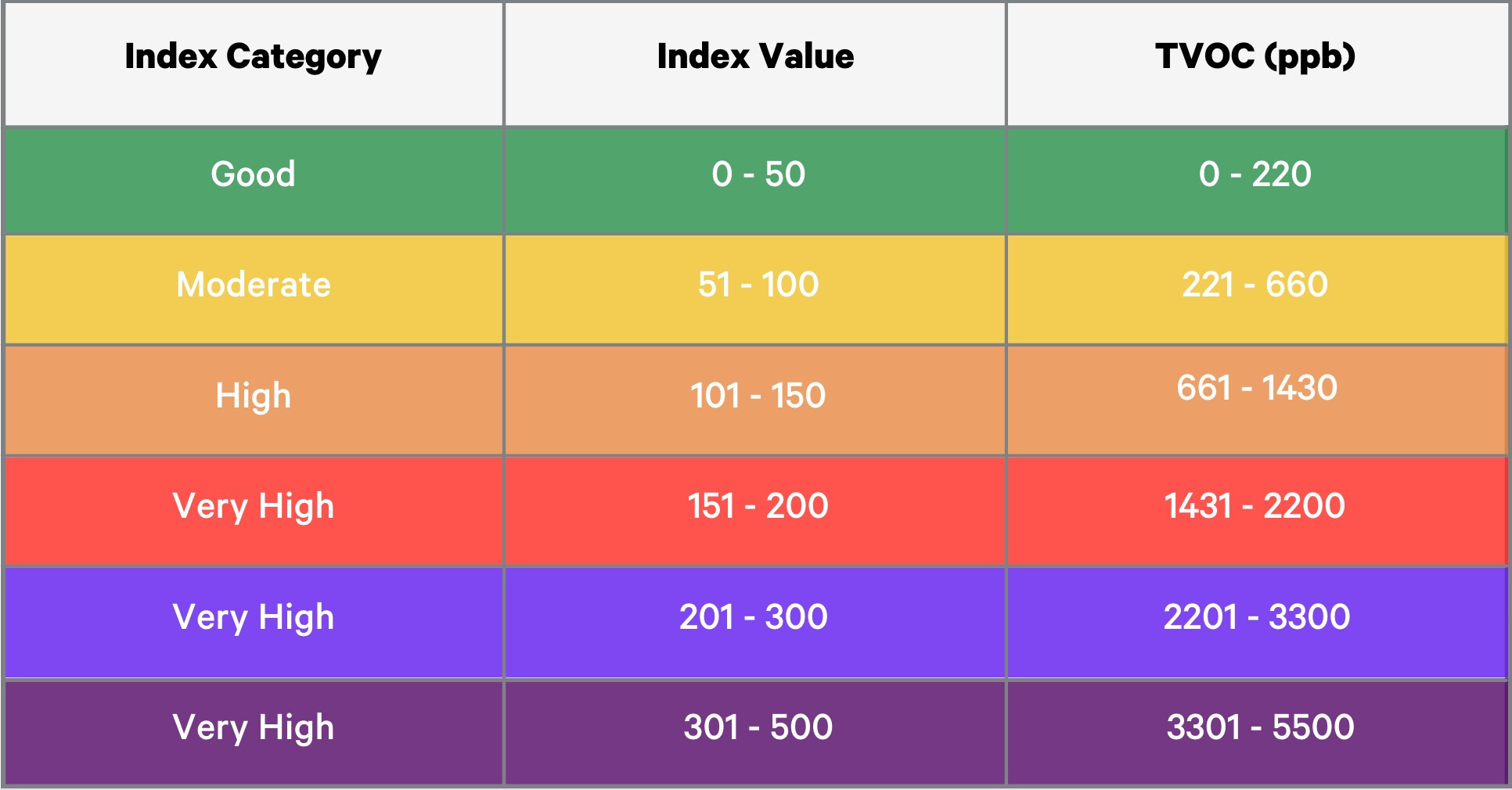

I'm curious how the quality level is gauged. Aqara makes no statements about ranges as far as I can tell.
Here's a chart for another indoor quality meter
Source: Understanding TVOC: What You Need To Know About Volatile Organic Compounds

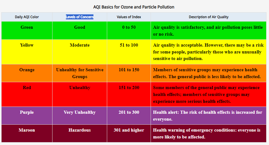

The driver currently uses this guide to determine the 'AirQyalityLevel' aka 'IndexCategory' aka 'Levels of Concern'
Probably none of these methodologies apply to this Aqara TVOC sensor ?
Gotcha. This unit measures in either µg/m³ or ppb, which (I think) are different than AQI (Air Quality Index). I couldn't find a mention of either a ppb or µg/m³ measurement on the page you shared, nor could I find a direct comparison of AQI to TVOC. I did find this overview of TVOC (and a bit on why it's sometimes problematic) from the site I mentioned earlier: Defining TVOC: Why TVOC Is So Difficult To Explain
It makes me think that Aqara's sensor is probably closer to KaiTerra's in terms of ranges. What do you think?

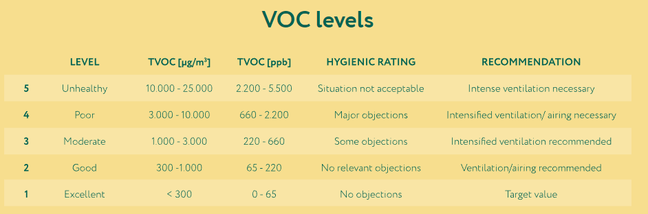

  3. As pointed out above, it's hard to convert ppm to an index as any index I can find uses ug/m3 and not ppm. In order to convert from ppm to ug/m3 it seems you need to know the molar mass of the specific mix being detected ... which is not a capability this sensor provides as far as I can tell. Judging from search results, this is a somewhat common industry problem and various companies have been working around it by making assumptions for the molar mass. In general, i am seeing a factor of somewhere between 3-4.5 being used. In addition to the site above, i also found this to be a good read.
  4. In looking around for this information, I stumbled upon a product page for Frient TVOC sensor, the one Hubitat officially supports. It actually included a scale, by the looks of it they are making the assumption that molar mass is closer to the conservative end of the spectrum above. Conservative seems like a good idea here and while their ranges didn't 100% correlate to the tables in the PDF above, they do generally align and are somewhere in between. So ... I decided to adopt Frient's ranges for my own use:
With that all said, I made some tweaks to your driver code for my own use:
  1. Changed title slightly to distinguish from your version.
  2. Removed GitHub link to prevent loss of changes.
  3. Increased valid range to be reported from 999 to 9999. One of my sensors is on my patio and the first time I started my smoker I realized 999 is far too low as the screen was sitting at 4000+.
  4. Updated the quality designations to align with the image above.
Just wanted to circle back here to thank you all and share in case anyone else finds this useful.

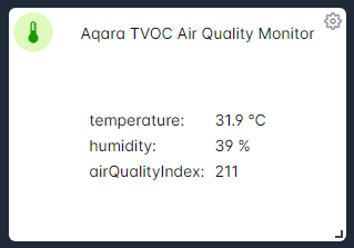

Just got this sensor paired with C-7 and running with this driver. How do you all get the TVOC status to show up in a Hubitat dashboard as a tile? I don’t see any kind of templates for air quality. Does that involve making a custom template?
Just tested it with the new EZ dashboard - it shows this way :
For the old dashboards, you will need to use a Custom attribute option :
Thanks! Will try custom attribute. I’m using a set of heavily customized legacy dashboards. Haven’t even tried EZ dashboards yet.
