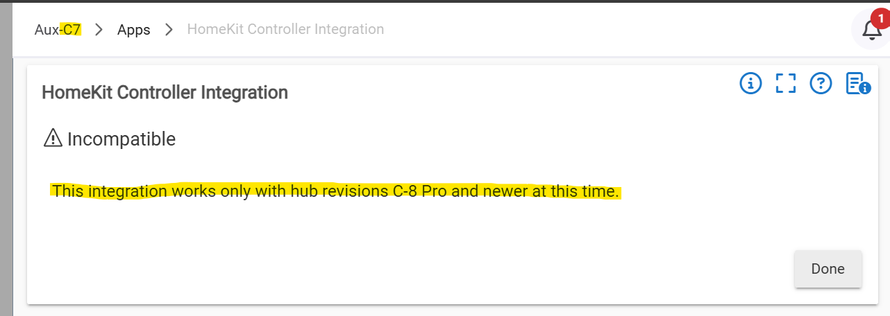

Also, it should be noted that Hubitat has now restricted their "HomeKit Controller" integration to only the C8-Pro and future hub models due to the CPU/Memory constraints as mentioned above by @kkossev.

How do you do this? Is it restricted to C8-Pro?
Sorry, my mistake. Matter is enabled on my C-7 hub, while the HomeKit Controller is enabled only on my developer C-8 Pro hub.
@kkossev and @ogiewon

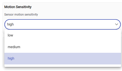

Need some help. I got myself 1 FP300 a couple of days ago. Setting up wasn't a problem. Used the Aqara app to change to Zigbee and paired to a C-7 hub without any hitch.
Everything was in default. When I move into the landing zone, motion was detected. Room state = occupied. But after a few seconds, while still in the landing zone, motion and room state went to inactive and unoccupied. Even when typing this message, the FP300 cannot detect my movement and presence.
Any clues for me? @kkossev
Edit : did a few more scenario test. when moving into the landing zone about 5-6 meters from sensor, motion detected. Sat on couch about 3m away from sensor, motion and room state both turns inactive and unoccupied after a few seconds. However, if I bring the sensor nearer to me sitting on my couch(about 0.3m), everything worked as it should.
Edit 2 :Things seems to be working. Keeping this post for others who may face the same issue, I didn't know and didn't see a child device added, I changed some preferences and clicked save, after briefly pressing the device button, a child device appeared and all was good from there, for now.
Edit 3 : Not working after an hour... I'm at my wit's end..

Have you considered increasing the sensitivity? I'm unsure if this parameter applies only to the PIR sensor or to both the PIR and mmWave sensors.
Did you also calibrate the sensor using the 'Spatial Learning' command?
Hi kkossev,
Yeah I did all you mentioned above. But it wasn't working then. I then left the room for a while. I came back and it is working now, without doing anything. I am also confused but let's see how long it will continue to work.
