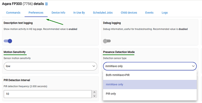

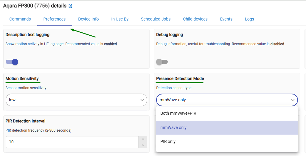

Adjust the sensor to the low-sensitivity mode, and set the appropriate detection distance and angle to avoid interference sources as much as possible, which helps the device determine the absence state quickly. If the issue persists after the adjustment, try switching to the MMW-only mode for use.
HE: Preferences tab, click on the Save button after changing the settings!
