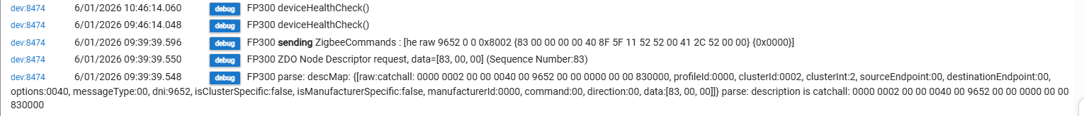

Update: whoever has the latest FP300 firmware already updated, please update again manually the P1 driver - same version 2.1.3, new time stamp "2026/05/31 9:37 AM". I have changed the driver response to the ZDO cluster 0x002 (Node Descriptor Request) and added periodic syncing of the device date/time. We will know the effect after 24 hours...
Update2: Unfortunately, the device went offline after 26 hours ... :frowning:
Last breath was :

I am running a Zigbee sniffer 24 hours now, hopefully it can catch what exactly happens before the 'last breath' registered message.

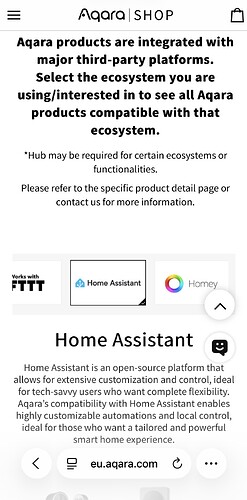

In the past, they have stated that they do not support any integration except though the Aqara hub. Are those using their hub having the same issues?
No idea, but if they don’t want to support other platforms, they shouldn’t provide Zigbee support.
I am pretty sure Aqara provides no documentation whatsoever on how they utilize Zigbee. Thus, I believe all of their Zigbee products have to be reverse-engineered to work with other systems like Hubitat and Home Assistant. It would be really nice if Aqara would follow the Zigbee specifications fully, however they seem to like using custom Zigbee clusters, which is supported by the Zigbee specification, but makes it very challenging to use these devices reliably with any system other than Aqara’s own hubs (especially with no documentation!)
The thing is, they claim to support other platforms like HA, so they need to be more mindful of breaking changes.
Please refer to the “Hub may be required for certain ecosystems…” note above. My guess is they mean one should use an Aqara hub to integrate with third-party ecosystems. I know from my personal experience that Aqara devices work very well when paired to an Aqara M3 Hub, and then integrated to Hubitat and/or Home Assistant via the Aqara hub’s Matter Bridge functionality. Likewise, Aqara devices work very well with Apple Home using either the HomeKit or Matter protocol via their Aqara hubs.
