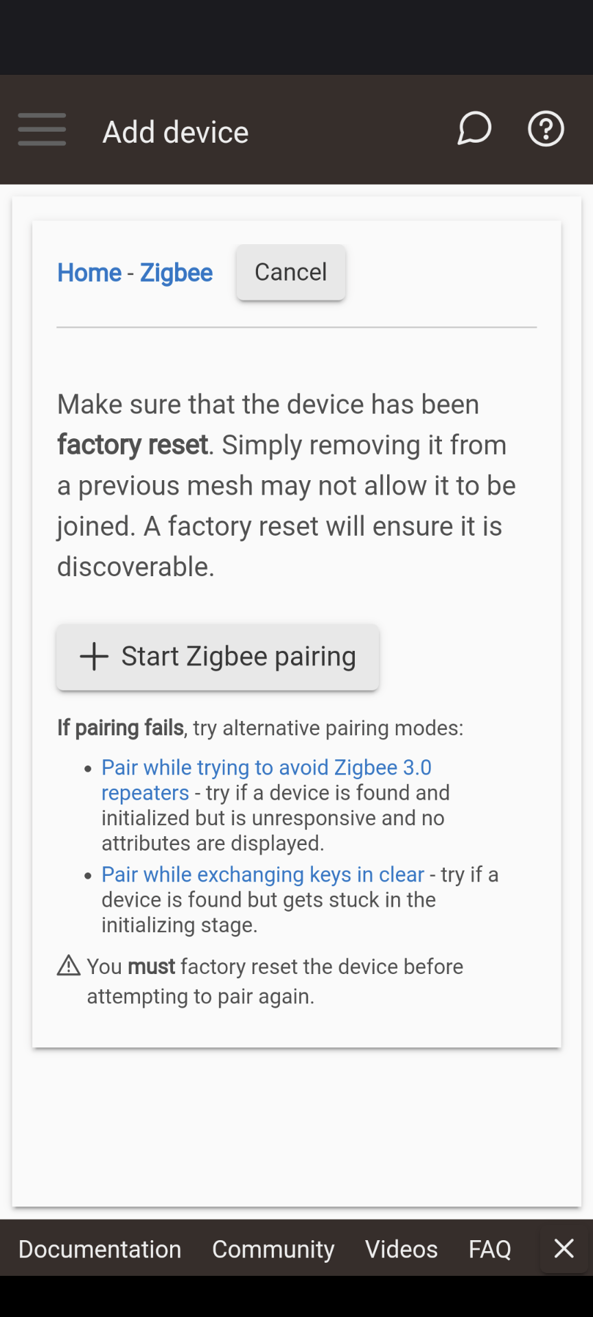

[update 0] I was able to pair while on channel 20, but only if I chose the option to disregard Zigbee 3.0 repeaters. I had the sensor about 4 inches from the hub. If I tried without the option, it could not get past initialization.

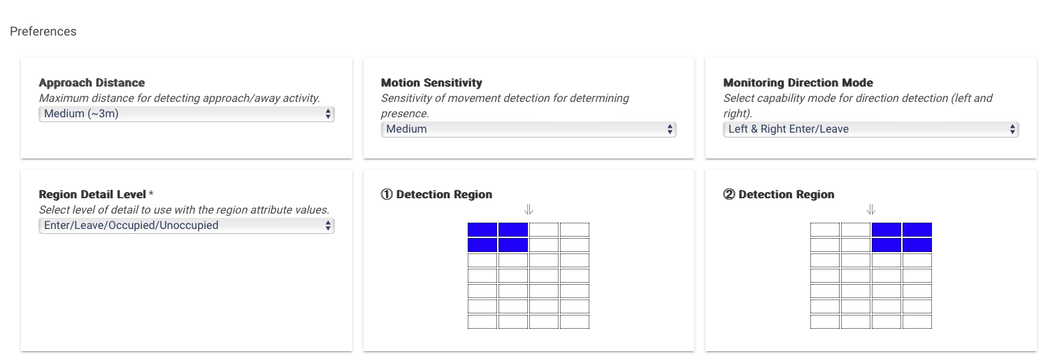

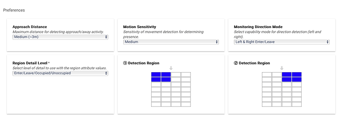

Below is a screenshot of the default settings I have found to work best for me so far. Only once I confirm these basics are working correctly do I start changing any of these values

A clarification - the screenshot is from Jonathan's 'Aqara Human Presence Sensor FP1' new driver w/ regions detection.

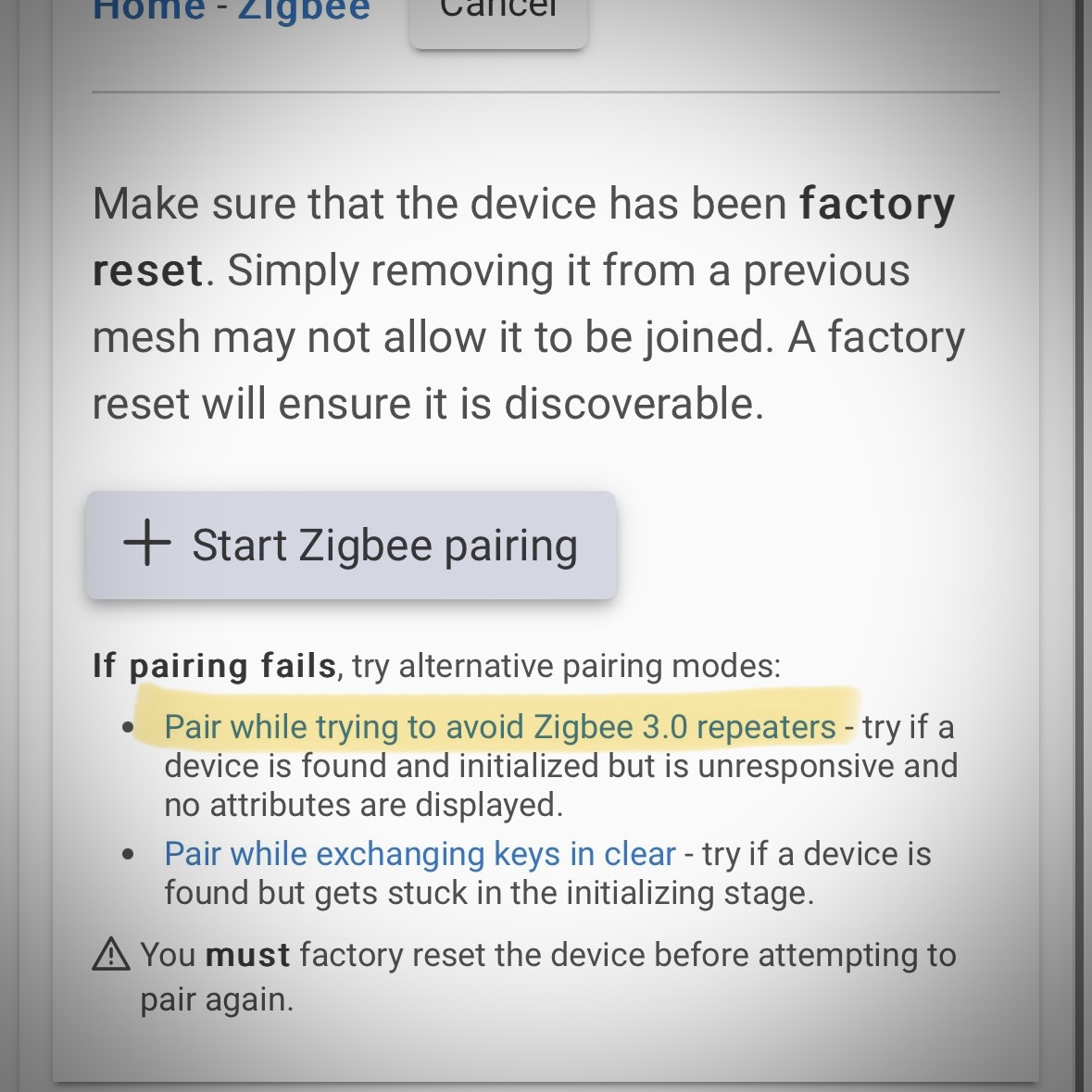

I suspect this feature may be exclusive to the C8 hub but on the updated zigbee pairing screen (similar to @fisher.omega’s post above) I clicked the text link labeled “Pair while trying to avoid Zigbee 3.0 repeaters”, then held the button on the back of the FP1 down until the blue light began to pulse and the device paired as new and began communicating almost instantly. - I didn’t even have to pair the second time.

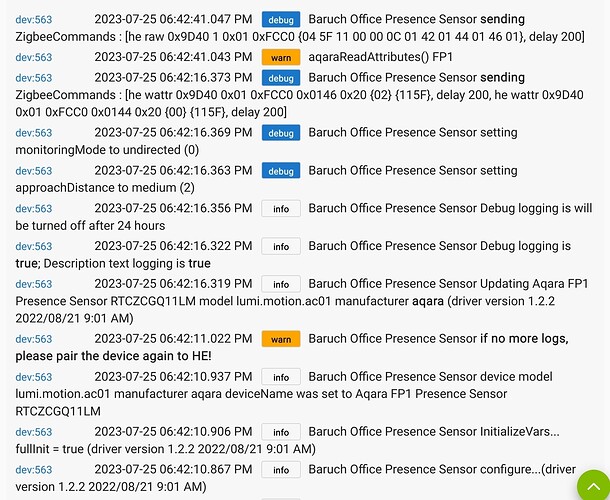

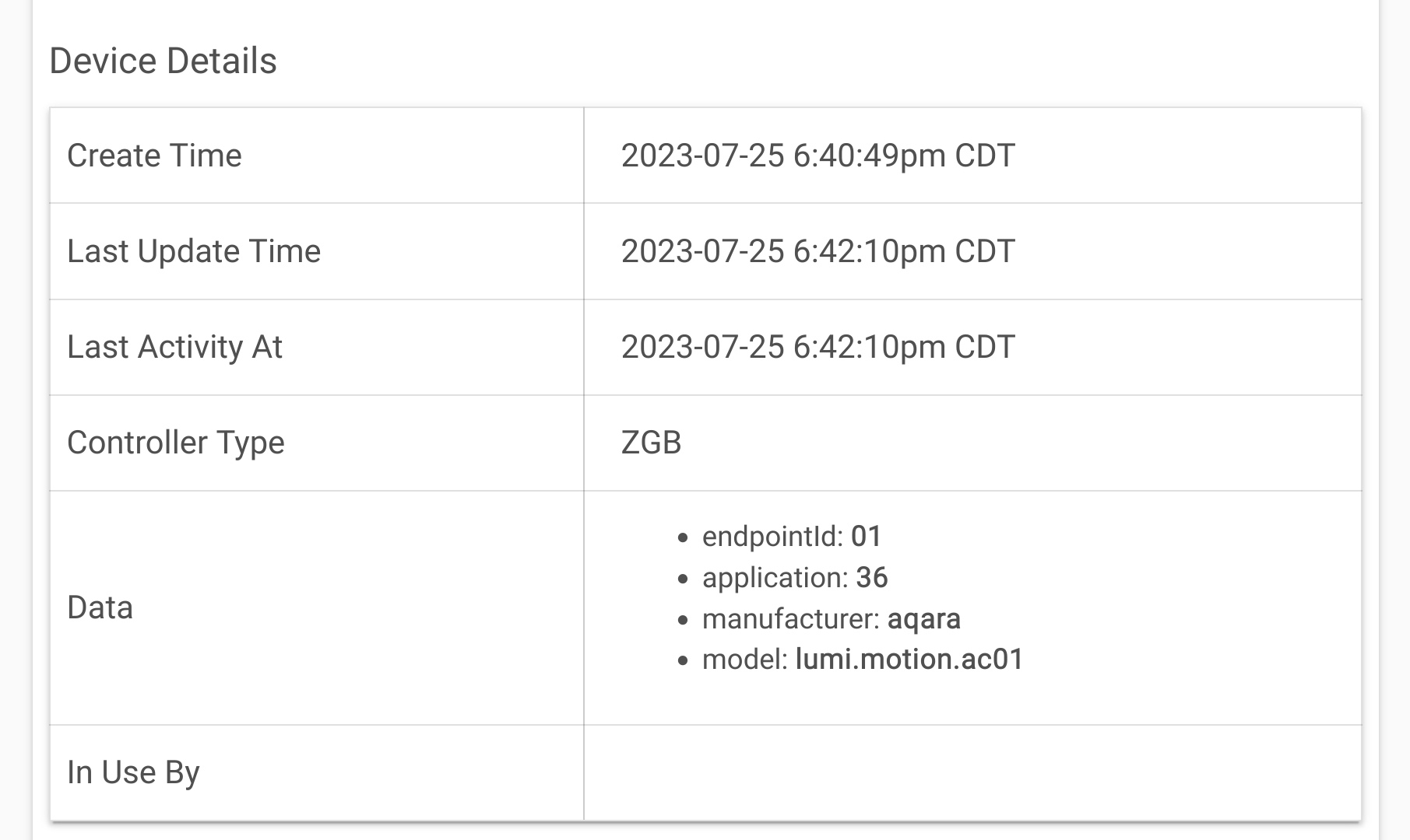

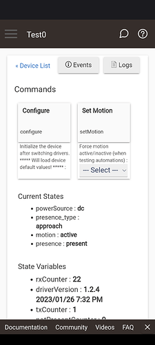

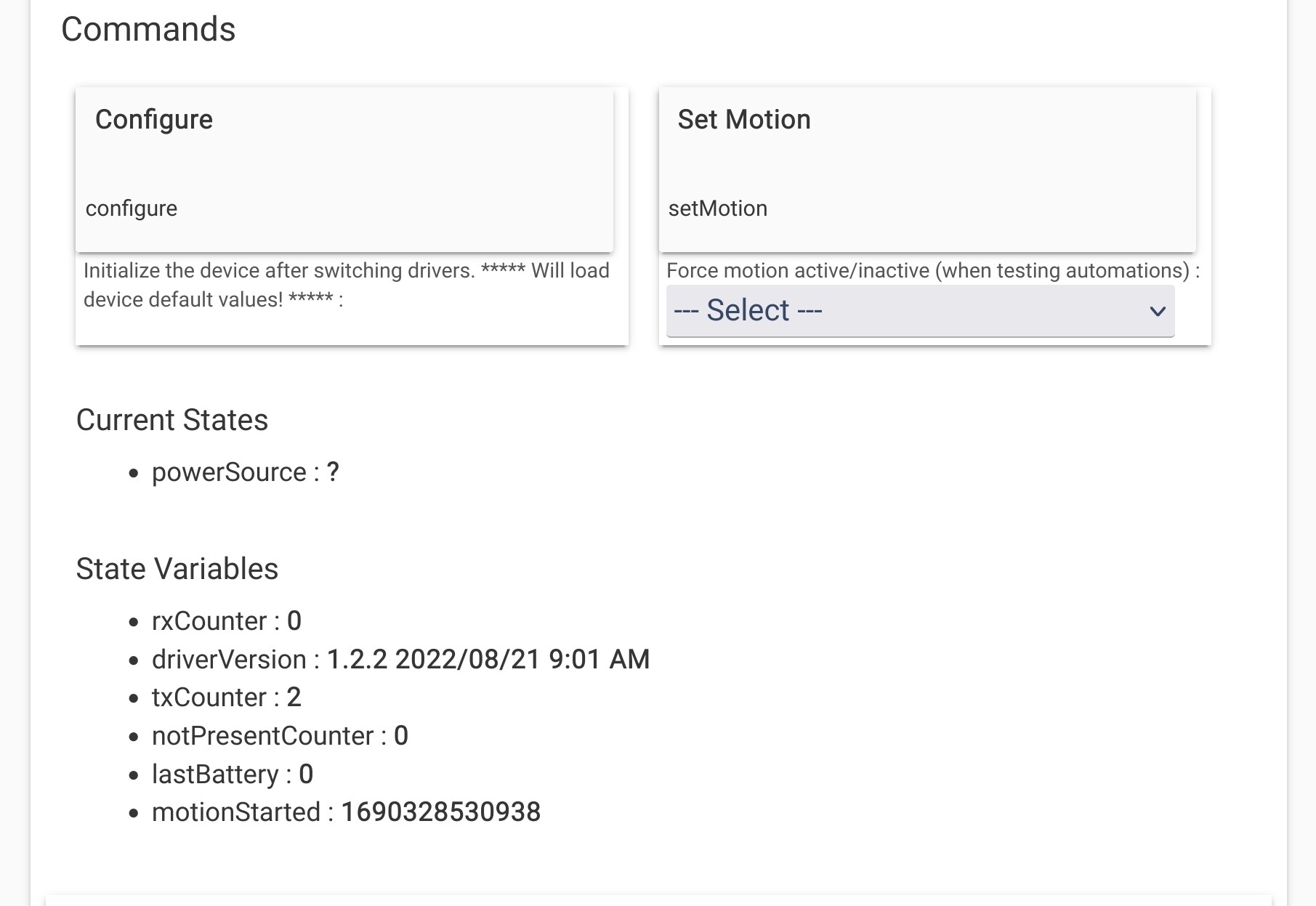

After a successful pilot with one FP1 (thanks again for the outstanding work, @kkossev!) I purchased another one, and it paired flawlessly with "trying to avoid Zigbee 3.0 repeaters," showing all the properties immediately. The problem is - it looks like it is not responding!

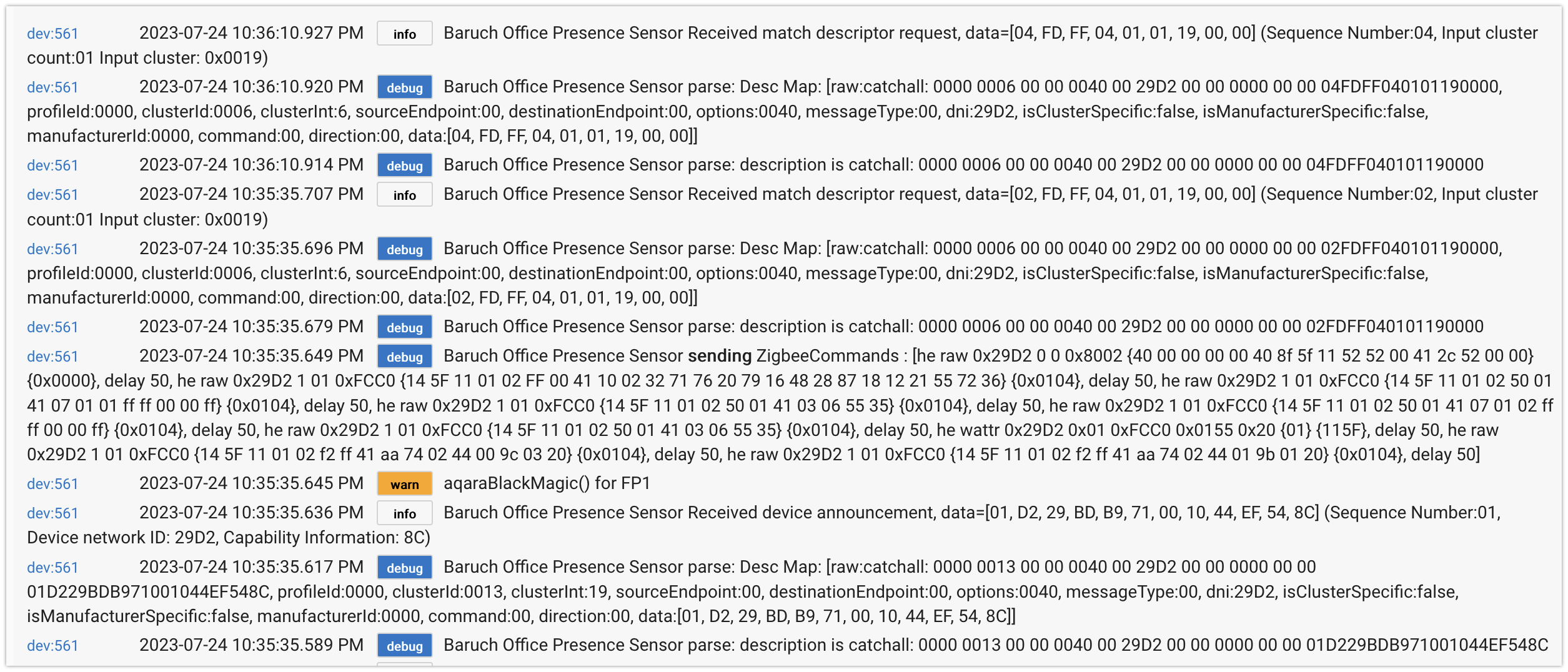

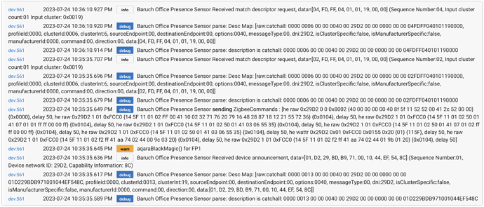

When I restart it, it looks like it communicates (logs below), but it still shows "not present" regardless of what's happening in front of it, and also it's the last time it does something; the Last Activity will be this startup time. @kkossev can you take a look?

It paired and worked some days later after I tried different pairing strategies - pair it close to the hub, pair it away from the hub but close to a Zigbee 3.0 repeater, pair it by selecting the option “Pair while trying to avoid Zigbee 3.0 repeaters”... eventually one of these worked.

Remember that after pairing it as a new device, you usually need to pair it once again (without removing it this time!). This strange need for pairing at least two times is not only for the FP1 radar, but also for some other Aqara devices.
Something is still off. I paired it near the hub, saw the line in the logs about pairing again, paired it again and now the log looks normative (although I am not sure what to expect there), but the device has only the powerSource State variable. Las time it happened you pointed out that the Data section of the Device Details had incorrect information. I was on a lookout for that, but it looks legit this time.
Any ideas?
There is no 100% working receipt on how to successfully pair problematic Zigbee devices to a C-8 hub... If you succeed, let us know.
Pairing close to the hub and with repeaters avoidance did the trick.
