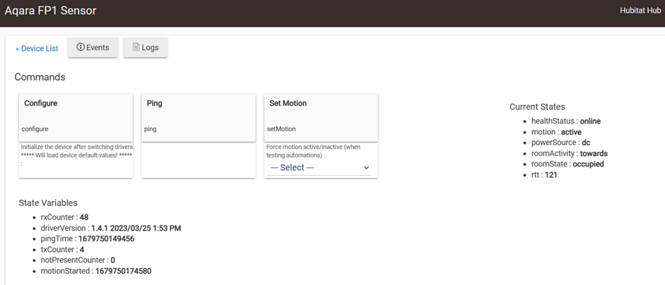

I am still convinced that there is a difference in speed of detecting motion between the stable version and the development version.
It took 3 steps into my bedroom for the lights to activate using stable driver.
However, it takes 5-6 steps for the lights to activate using the development driver.
Please let me know if there are any specific logs or tests you would like me to do, thanks.

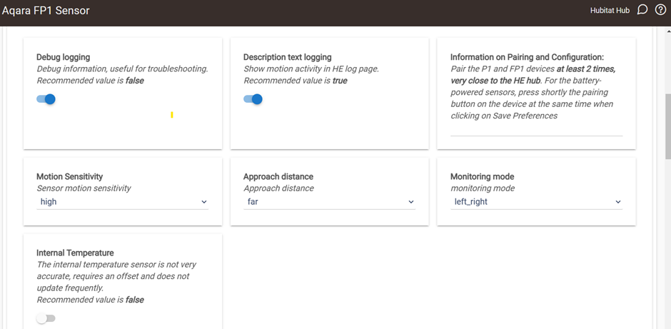

Device
Log
dev:8662023-03-25 01:23:09.303 PMdebugAqara FP1 Sensor parse: Desc Map: [raw:A5A501FCC062F700412D03281505213900082136010A214F850C20141020011220006520016620036720016820006920006A20016B2003, dni:A5A5, endpoint:01, cluster:FCC0, size:62, attrId:00F7, encoding:41, command:0A, value:03281505213900082136010A214F850C20141020011220006520016620036720016820006920006A20016B2003, clusterInt:64704, attrInt:247]
dev:8662023-03-25 01:23:09.290 PMtracehealthStatus online
dev:8662023-03-25 01:23:09.286 PMdebugAqara FP1 Sensor parse: description is read attr - raw: A5A501FCC062F700412D03281505213900082136010A214F850C20141020011220006520016620036720016820006920006A20016B2003, dni: A5A5, endpoint: 01, cluster: FCC0, size: 62, attrId: 00F7, encoding: 41, command: 0A, value: 2D03281505213900082136010A214F850C20141020011220006520016620036720016820006920006A20016B2003
dev:8662023-03-25 01:17:53.167 PMdebugAqara FP1 Sensor (0x06B) FP1 unknown parameter, value: 3
dev:8662023-03-25 01:17:53.165 PMdebugAqara FP1 Sensor (0x6A) FP1 unknown parameter, value: 1
dev:8662023-03-25 01:17:53.163 PMdebugAqara FP1 Sensor approach_distance is far (0)
dev:8662023-03-25 01:17:53.154 PMdebugAqara FP1 Sensor unknown tag=68 dataType 0x20 rawValue=0
dev:8662023-03-25 01:17:53.144 PMdebugAqara FP1 Sensor monitoring_mode is left_right (1)
dev:8662023-03-25 01:17:53.143 PMdebugAqara FP1 Sensor (tag 0x66) sensitivity is high (3)
dev:8662023-03-25 01:17:53.094 PMinfoAqara FP1 Sensor Motion is active 99s
dev:8662023-03-25 01:17:53.092 PMinfoAqara FP1 Sensor roomState (presence) is occupied
dev:8662023-03-25 01:17:53.089 PMdebugAqara FP1 Sensor (0x65) roomState (presence) is occupied (1)
dev:8662023-03-25 01:17:53.087 PMdebugAqara FP1 Sensor unknown tag=12 dataType 0x20 rawValue=0
dev:8662023-03-25 01:17:53.085 PMdebugAqara FP1 Sensor unknown tag=10 dataType 0x20 rawValue=1
dev:8662023-03-25 01:17:53.083 PMdebugAqara FP1 Sensor unknown tag=0C dataType 0x20 rawValue=20
dev:8662023-03-25 01:17:53.082 PMdebugParent NWK is 854F
dev:8662023-03-25 01:17:53.080 PMdebugAqara FP1 Sensor unknown tag=08 dataType 0x21 rawValue=310
dev:8662023-03-25 01:17:53.078 PMdebugRSSI is 57 ? db
dev:8662023-03-25 01:17:53.075 PMdebugdecodeAqaraStruct len = 92 valueHex = 2D03281505213900082136010A214F850C20141020011220006520016620036720016820006920006A20016B2003
dev:8662023-03-25 01:17:53.068 PMdebugAqara FP1 Sensor parse: Desc Map: [raw:A5A501FCC062F700412D03281505213900082136010A214F850C20141020011220006520016620036720016820006920006A20016B2003, dni:A5A5, endpoint:01, cluster:FCC0, size:62, attrId:00F7, encoding:41, command:0A, value:03281505213900082136010A214F850C20141020011220006520016620036720016820006920006A20016B2003, clusterInt:64704, attrInt:247]
dev:8662023-03-25 01:17:53.057 PMtracehealthStatus online
dev:8662023-03-25 01:17:53.053 PMdebugAqara FP1 Sensor parse: description is read attr - raw: A5A501FCC062F700412D03281505213900082136010A214F850C20141020011220006520016620036720016820006920006A20016B2003, dni: A5A5, endpoint: 01, cluster: FCC0, size: 62, attrId: 00F7, encoding: 41, command: 0A, value: 2D03281505213900082136010A214F850C20141020011220006520016620036720016820006920006A20016B2003
dev:8662023-03-25 01:16:14.580 PMinfoAqara FP1 Sensor Detected motion
dev:8662023-03-25 01:16:14.578 PMinfoAqara FP1 Sensor roomState (presence) is occupied
dev:8662023-03-25 01:16:14.575 PMdebugAqara FP1 Sensor (attr. 0x0142) roomState (presence) is occupied (1)
dev:8662023-03-25 01:16:14.572 PMdebugAqara FP1 Sensor parse: Desc Map: [raw:A5A501FCC00842012001, dni:A5A5, endpoint:01, cluster:FCC0, size:08, attrId:0142, encoding:20, command:0A, value:01, clusterInt:64704, attrInt:322]
dev:8662023-03-25 01:16:14.562 PMtracehealthStatus online
dev:8662023-03-25 01:16:14.559 PMdebugAqara FP1 Sensor parse: description is read attr - raw: A5A501FCC00842012001, dni: A5A5, endpoint: 01, cluster: FCC0, size: 08, attrId: 0142, encoding: 20, command: 0A, value: 01
dev:8662023-03-25 01:16:14.381 PMinfoAqara FP1 Sensor presence type is towards
dev:8662023-03-25 01:16:14.375 PMdebugAqara FP1 Sensor parse: Desc Map: [raw:A5A501FCC00843012006, dni:A5A5, endpoint:01, cluster:FCC0, size:08, attrId:0143, encoding:20, command:0A, value:06, clusterInt:64704, attrInt:323]
dev:8662023-03-25 01:16:14.363 PMtracehealthStatus online
dev:8662023-03-25 01:16:14.361 PMdebugAqara FP1 Sensor parse: description is read attr - raw: A5A501FCC00843012006, dni: A5A5, endpoint: 01, cluster: FCC0, size: 08, attrId: 0143, encoding: 20, command: 0A, value: 06
dev:8662023-03-25 01:16:14.347 PMinfoAqara FP1 Sensor region 2 state is occupied
dev:8662023-03-25 01:16:14.345 PMdebugAqara FP1 Sensor (0x0151) received region report: regionId=2 value=4 (cluster=0xFCC0 attrId=0x0151 value=0x0204)
dev:8662023-03-25 01:16:14.341 PMdebugAqara FP1 Sensor parse: Desc Map: [raw:A5A501FCC00C510141020204, dni:A5A5, endpoint:01, cluster:FCC0, size:0C, attrId:0151, encoding:41, command:0A, value:0204, clusterInt:64704, attrInt:337]
dev:8662023-03-25 01:16:14.329 PMtracehealthStatus online
dev:8662023-03-25 01:16:14.327 PMdebugAqara FP1 Sensor parse: description is read attr - raw: A5A501FCC00C510141020204, dni: A5A5, endpoint: 01, cluster: FCC0, size: 0C, attrId: 0151, encoding: 41, command: 0A, value: 020204
dev:8662023-03-25 01:16:14.250 PMinfoAqara FP1 Sensor region 1 state is occupied
dev:8662023-03-25 01:16:14.248 PMdebugAqara FP1 Sensor (0x0151) received region report: regionId=1 value=4 (cluster=0xFCC0 attrId=0x0151 value=0x0104)
dev:8662023-03-25 01:16:14.244 PMdebugAqara FP1 Sensor parse: Desc Map: [raw:A5A501FCC00C510141020104, dni:A5A5, endpoint:01, cluster:FCC0, size:0C, attrId:0151, encoding:41, command:0A, value:0104, clusterInt:64704, attrInt:337]
dev:8662023-03-25 01:16:14.228 PMtracehealthStatus online
dev:8662023-03-25 01:16:14.226 PMdebugAqara FP1 Sensor parse: description is read attr - raw: A5A501FCC00C510141020104, dni: A5A5, endpoint: 01, cluster: FCC0, size: 0C, attrId: 0151, encoding: 41, command: 0A, value: 020104
dev:8662023-03-25 01:16:11.940 PMinfoAqara FP1 Sensor region 2 state is enter
dev:8662023-03-25 01:16:11.938 PMdebugAqara FP1 Sensor (0x0151) received region report: regionId=2 value=1 (cluster=0xFCC0 attrId=0x0151 value=0x0201)
dev:8662023-03-25 01:16:11.935 PMdebugAqara FP1 Sensor parse: Desc Map: [raw:A5A501FCC00C510141020201, dni:A5A5, endpoint:01, cluster:FCC0, size:0C, attrId:0151, encoding:41, command:0A, value:0201, clusterInt:64704, attrInt:337]
dev:8662023-03-25 01:16:11.923 PMtracehealthStatus online
dev:8662023-03-25 01:16:11.920 PMdebugAqara FP1 Sensor parse: description is read attr - raw: A5A501FCC00C510141020201, dni: A5A5, endpoint: 01, cluster: FCC0, size: 0C, attrId: 0151, encoding: 41, command: 0A, value: 020201
dev:8662023-03-25 01:16:11.838 PMinfoAqara FP1 Sensor region 1 state is enter
dev:8662023-03-25 01:16:11.836 PMdebugAqara FP1 Sensor (0x0151) received region report: regionId=1 value=1 (cluster=0xFCC0 attrId=0x0151 value=0x0101)
dev:8662023-03-25 01:16:11.833 PMdebugAqara FP1 Sensor parse: Desc Map: [raw:A5A501FCC00C510141020101, dni:A5A5, endpoint:01, cluster:FCC0, size:0C, attrId:0151, encoding:41, command:0A, value:0101, clusterInt:64704, attrInt:337]
dev:8662023-03-25 01:16:11.821 PMtracehealthStatus online
dev:8662023-03-25 01:16:11.818 PMdebugAqara FP1 Sensor parse: description is read attr - raw: A5A501FCC00C510141020101, dni: A5A5, endpoint: 01, cluster: FCC0, size: 0C, attrId: 0151, encoding: 41, command: 0A, value: 020101
dev:8662023-03-25 01:16:11.515 PMinfoAqara FP1 Sensor presence type is enter (left)
dev:8662023-03-25 01:16:11.511 PMdebugAqara FP1 Sensor parse: Desc Map: [raw:A5A501FCC00843012004, dni:A5A5, endpoint:01, cluster:FCC0, size:08, attrId:0143, encoding:20, command:0A, value:04, clusterInt:64704, attrInt:323]
dev:8662023-03-25 01:16:11.499 PMtracehealthStatus online
dev:8662023-03-25 01:16:11.496 PMdebugAqara FP1 Sensor parse: description is read attr - raw: A5A501FCC00843012004, dni: A5A5, endpoint: 01, cluster: FCC0, size: 08, attrId: 0143, encoding: 20, command: 0A, value: 04
dev:8662023-03-25 01:15:49.579 PMinfoAqara FP1 Sensor RTT is 121 (ms)
dev:8662023-03-25 01:15:49.573 PMdebugAqara FP1 Sensor parse: Desc Map: [raw:A5A50100000A01002036, dni:A5A5, endpoint:01, cluster:0000, size:0A, attrId:0001, encoding:20, command:01, value:36, clusterInt:0, attrInt:1]
dev:8662023-03-25 01:15:49.526 PMtracehealthStatus online
dev:8662023-03-25 01:15:49.523 PMdebugAqara FP1 Sensor parse: description is read attr - raw: A5A50100000A01002036, dni: A5A5, endpoint: 01, cluster: 0000, size: 0A, attrId: 0001, encoding: 20, command: 01, value: 36
dev:8662023-03-25 01:15:49.460 PMdebugAqara FP1 Sensor sending ZigbeeCommands : [he raw 0xA5A5 1 0x01 0x0000 {10 00 00 01 00}]
dev:8662023-03-25 01:15:49.410 PMinfoAqara FP1 Sensor ping...
dev:8662023-03-25 01:15:42.874 PMdebugAqara FP1 Sensor Received Write Attribute Response for cluster:FCC0 , data=[00] (Status: Success)
dev:8662023-03-25 01:15:42.871 PMdebugAqara FP1 Sensor parse: Desc Map: [raw:catchall: 0104 FCC0 01 01 0040 00 A5A5 00 01 115F 04 01 00, profileId:0104, clusterId:FCC0, clusterInt:64704, sourceEndpoint:01, destinationEndpoint:01, options:0040, messageType:00, dni:A5A5, isClusterSpecific:false, isManufacturerSpecific:true, manufacturerId:115F, command:04, direction:01, data:[00]]
dev:8662023-03-25 01:15:42.849 PMtracehealthStatus online
dev:8662023-03-25 01:15:42.847 PMdebugAqara FP1 Sensor parse: description is catchall: 0104 FCC0 01 01 0040 00 A5A5 00 01 115F 04 01 00
dev:8662023-03-25 01:15:42.666 PMdebugAqara FP1 Sensor Received Write Attribute Response for cluster:FCC0 , data=[00] (Status: Success)
dev:8662023-03-25 01:15:42.663 PMdebugAqara FP1 Sensor parse: Desc Map: [raw:catchall: 0104 FCC0 01 01 0040 00 A5A5 00 01 115F 04 01 00, profileId:0104, clusterId:FCC0, clusterInt:64704, sourceEndpoint:01, destinationEndpoint:01, options:0040, messageType:00, dni:A5A5, isClusterSpecific:false, isManufacturerSpecific:true, manufacturerId:115F, command:04, direction:01, data:[00]]
dev:8662023-03-25 01:15:42.650 PMtracehealthStatus online
dev:8662023-03-25 01:15:42.648 PMdebugAqara FP1 Sensor parse: description is catchall: 0104 FCC0 01 01 0040 00 A5A5 00 01 115F 04 01 00
dev:8662023-03-25 01:15:42.533 PMdebugAqara FP1 Sensor (0x010C) received PIR sensitivity report: high (cluster=0xFCC0 attrId=0x010C value=0x03)
dev:8662023-03-25 01:15:42.513 PMdebugAqara FP1 Sensor parse: Desc Map: [raw:A5A501FCC00A0C012003, dni:A5A5, endpoint:01, cluster:FCC0, size:0A, attrId:010C, encoding:20, command:01, value:03, clusterInt:64704, attrInt:268]
dev:8662023-03-25 01:15:42.456 PMtracehealthStatus online
dev:8662023-03-25 01:15:42.453 PMdebugAqara FP1 Sensor parse: description is read attr - raw: A5A501FCC00A0C012003, dni: A5A5, endpoint: 01, cluster: FCC0, size: 0A, attrId: 010C, encoding: 20, command: 01, value: 03
dev:8662023-03-25 01:15:42.298 PMdebugAqara FP1 Sensor Received Write Attribute Response for cluster:FCC0 , data=[00] (Status: Success)
dev:8662023-03-25 01:15:42.294 PMdebugAqara FP1 Sensor parse: Desc Map: [raw:catchall: 0104 FCC0 01 01 0040 00 A5A5 00 01 115F 04 01 00, profileId:0104, clusterId:FCC0, clusterInt:64704, sourceEndpoint:01, destinationEndpoint:01, options:0040, messageType:00, dni:A5A5, isClusterSpecific:false, isManufacturerSpecific:true, manufacturerId:115F, command:04, direction:01, data:[00]]
dev:8662023-03-25 01:15:42.251 PMtracehealthStatus online
dev:8662023-03-25 01:15:42.248 PMdebugAqara FP1 Sensor parse: description is catchall: 0104 FCC0 01 01 0040 00 A5A5 00 01 115F 04 01 00
dev:8662023-03-25 01:15:42.176 PMdebugAqara FP1 Sensor sending ZigbeeCommands : [he wattr 0xA5A5 0x01 0xFCC0 0x010C 0x20 {03} {115F}, delay 200, he raw 0xA5A5 1 0x01 0xFCC0 {04 5F 11 00 00 0C 01}, delay 200, he wattr 0xA5A5 0x01 0xFCC0 0x0146 0x20 {00} {115F}, delay 200, he wattr 0xA5A5 0x01 0xFCC0 0x0144 0x20 {01} {115F}, delay 200]
dev:8662023-03-25 01:15:42.150 PMdebugAqara FP1 Sensor setting monitoringMode to left_right (1)
dev:8662023-03-25 01:15:42.147 PMdebugAqara FP1 Sensor setting approachDistance to far (0)
dev:8662023-03-25 01:15:42.141 PMdebugAqara FP1 Sensor setting motionSensitivity to high (3)
dev:8662023-03-25 01:15:42.105 PMinfoAqara FP1 Sensor Debug logging is will be turned off after 24 hours
dev:8662023-03-25 01:15:42.046 PMinfoAqara FP1 Sensor Debug logging is true; Description text logging is true
dev:8662023-03-25 01:15:42.044 PMinfoAqara FP1 Sensor Updating Aqara FP1 Human Presence Detector RTCZCGQ11LM model lumi.motion.ac01 manufacturer aqara (driver version 1.4.1 2023/03/25 1:53 PM)

dev:8662023-03-25 01:12:47.816 PMinfoAqara FP1 Sensor Motion reset to inactive after 62 s.
dev:8662023-03-25 01:12:47.814 PMinfoAqara FP1 Sensor roomState (presence) is unoccupied
dev:8662023-03-25 01:12:47.786 PMtracehealthStatus online
dev:8662023-03-25 01:12:47.773 PMinfoAqara FP1 Sensor presence type is leave (left)
dev:8662023-03-25 01:12:47.758 PMtracehealthStatus online
dev:8662023-03-25 01:12:36.872 PMinfoAqara FP1 Sensor Motion is active 51s
dev:8662023-03-25 01:12:36.869 PMinfoAqara FP1 Sensor roomState (presence) is occupied
dev:8662023-03-25 01:12:36.830 PMtracehealthStatus online
dev:8662023-03-25 01:11:52.512 PMinfoAqara FP1 Sensor presence type is away
dev:8662023-03-25 01:11:52.495 PMtracehealthStatus online
dev:8662023-03-25 01:11:45.772 PMinfoAqara FP1 Sensor region 2 state is occupied
dev:8662023-03-25 01:11:45.752 PMtracehealthStatus online
dev:8662023-03-25 01:11:45.678 PMinfoAqara FP1 Sensor region 1 state is occupied
dev:8662023-03-25 01:11:45.654 PMtracehealthStatus online
dev:8662023-03-25 01:11:45.573 PMinfoAqara FP1 Sensor Detected motion
dev:8662023-03-25 01:11:45.565 PMinfoAqara FP1 Sensor roomState (presence) is occupied
dev:8662023-03-25 01:11:45.550 PMtracehealthStatus online
dev:8662023-03-25 01:11:44.695 PMinfoAqara FP1 Sensor presence type is towards
dev:8662023-03-25 01:11:44.679 PMtracehealthStatus online
dev:8662023-03-25 01:11:42.700 PMinfoAqara FP1 Sensor region 2 state is enter
dev:8662023-03-25 01:11:42.685 PMtracehealthStatus online
dev:8662023-03-25 01:11:42.624 PMinfoAqara FP1 Sensor region 1 state is enter
dev:8662023-03-25 01:11:42.584 PMtracehealthStatus online
dev:8662023-03-25 01:11:42.502 PMinfoAqara FP1 Sensor presence type is enter (left)
dev:8662023-03-25 01:11:42.483 PMtracehealthStatus online
dev:8662023-03-25 01:11:20.768 PMinfoAqara FP1 Sensor roomState (presence) is unoccupied
dev:8662023-03-25 01:11:20.731 PMtracehealthStatus online
dev:8662023-03-25 01:11:06.045 PMtracehealthStatus online
dev:8662023-03-25 01:11:05.855 PMtracehealthStatus online
dev:8662023-03-25 01:11:05.202 PMinfoAqara FP1 Sensor Debug logging is false; Description text logging is true
dev:8662023-03-25 01:11:05.199 PMinfoAqara FP1 Sensor Updating Aqara FP1 Human Presence Detector RTCZCGQ11LM model lumi.motion.ac01 manufacturer aqara (driver version 1.4.1 2023/03/25 1:53 PM)
dev:8662023-03-25 01:10:50.504 PMinfoAqara FP1 Sensor device model lumi.motion.ac01 manufacturer aqara aqaraModel RTCZCGQ11LM deviceName was set to Aqara FP1 Human Presence Detector RTCZCGQ11LM
dev:8662023-03-25 01:10:50.441 PMinfoAqara FP1 Sensor configure...(driver version 1.4.1 2023/03/25 1:53 PM)
dev:8662023-03-25 01:08:09.914 PMinfoAqara FP1 Sensor presence is not present
dev:8662023-03-25 01:08:09.911 PMinfoAqara FP1 Sensor (attr. 0x0142) presence is not present (0)
dev:8662023-03-25 01:08:09.883 PMinfoAqara FP1 Sensor Motion reset to inactive after 13 s.
dev:8662023-03-25 01:08:09.881 PMinfoAqara FP1 Sensor presence type is right_leave
dev:8662023-03-25 01:07:59.900 PMinfoAqara FP1 Sensor Motion is active 3s
dev:8662023-03-25 01:07:59.893 PMinfoAqara FP1 Sensor presence is present
dev:8662023-03-25 01:07:59.890 PMinfoAqara FP1 Sensor (attr. 0x0142) presence is present (1)
dev:8662023-03-25 01:07:56.848 PMinfoAqara FP1 Sensor Detected motion
dev:8662023-03-25 01:07:56.836 PMinfoAqara FP1 Sensor presence type is right_enter
dev:8662023-03-25 01:07:44.466 PMinfoAqara FP1 Sensor presence is not present
dev:8662023-03-25 01:07:44.456 PMinfoAqara FP1 Sensor (attr. 0x0142) presence is not present (0)
dev:8662023-03-25 01:07:44.442 PMinfoAqara FP1 Sensor Motion reset to inactive after 12 s.
dev:8662023-03-25 01:07:44.440 PMinfoAqara FP1 Sensor presence type is right_leave
dev:8662023-03-25 01:07:35.320 PMinfoAqara FP1 Sensor Motion is active 3s
dev:8662023-03-25 01:07:35.318 PMinfoAqara FP1 Sensor presence is present
dev:8662023-03-25 01:07:35.315 PMinfoAqara FP1 Sensor (attr. 0x0142) presence is present (1)
dev:8662023-03-25 01:07:32.268 PMinfoAqara FP1 Sensor Detected motion
dev:8662023-03-25 01:07:32.266 PMinfoAqara FP1 Sensor presence type is right_enter
dev:8662023-03-25 01:07:25.673 PMinfoAqara FP1 Sensor approach_distance is far (0)
dev:8662023-03-25 01:07:25.658 PMinfoAqara FP1 Sensor monitoring_mode is left_right (1 )
dev:8662023-03-25 01:07:25.656 PMinfoAqara FP1 Sensor (tag 0x66) sensitivity is high (3)
dev:8662023-03-25 01:07:25.639 PMinfoAqara FP1 Sensor presence is not present
dev:8662023-03-25 01:07:25.636 PMinfoAqara FP1 Sensor (0x65) presence is not present (0)
dev:8662023-03-25 01:03:16.148 PMinfoAqara FP1 Sensor presence is not present
dev:8662023-03-25 01:03:16.146 PMinfoAqara FP1 Sensor (attr. 0x0142) presence is not present (0)
dev:8662023-03-25 01:03:16.128 PMinfoAqara FP1 Sensor Motion reset to inactive after 918 s.
dev:8662023-03-25 01:03:16.126 PMinfoAqara FP1 Sensor presence type is right_leave
dev:8662023-03-25 01:03:02.003 PMinfoAqara FP1 Sensor presence type is away
dev:8662023-03-25 01:02:16.491 PMinfoAqara FP1 Sensor approach_distance is far (0)
dev:8662023-03-25 01:02:16.475 PMinfoAqara FP1 Sensor monitoring_mode is left_right (1 )
dev:8662023-03-25 01:02:16.473 PMinfoAqara FP1 Sensor (tag 0x66) sensitivity is high (3)
dev:8662023-03-25 01:02:16.458 PMinfoAqara FP1 Sensor Motion is active 859s
dev:8662023-03-25 01:02:16.455 PMinfoAqara FP1 Sensor presence is present
dev:8662023-03-25 01:02:16.453 PMinfoAqara FP1 Sensor (0x65) presence is present (1)
dev:8662023-03-25 12:57:05.298 PMinfoAqara FP1 Sensor approach_distance is far (0)
dev:8662023-03-25 12:57:05.283 PMinfoAqara FP1 Sensor monitoring_mode is left_right (1 )
dev:8662023-03-25 12:57:05.281 PMinfoAqara FP1 Sensor (tag 0x66) sensitivity is high (3)
dev:8662023-03-25 12:57:05.266 PMinfoAqara FP1 Sensor Motion is active 548s
dev:8662023-03-25 12:57:05.264 PMinfoAqara FP1 Sensor presence is present
dev:8662023-03-25 12:57:05.261 PMinfoAqara FP1 Sensor (0x65) presence is present (1)
dev:8662023-03-25 12:51:58.260 PMinfoAqara FP1 Sensor approach_distance is far (0)
dev:8662023-03-25 12:51:58.244 PMinfoAqara FP1 Sensor monitoring_mode is left_right (1 )
dev:8662023-03-25 12:51:58.242 PMinfoAqara FP1 Sensor (tag 0x66) sensitivity is high (3)
dev:8662023-03-25 12:51:58.228 PMinfoAqara FP1 Sensor Motion is active 241s
dev:8662023-03-25 12:51:58.225 PMinfoAqara FP1 Sensor presence is present
dev:8662023-03-25 12:51:58.223 PMinfoAqara FP1 Sensor (0x65) presence is present (1)
dev:8662023-03-25 12:51:04.683 PMinfoAqara FP1 Sensor presence type is approach
dev:8662023-03-25 12:49:29.222 PMinfoAqara FP1 Sensor presence type is away
dev:8662023-03-25 12:48:03.326 PMinfoAqara FP1 Sensor presence type is approach
dev:8662023-03-25 12:48:00.725 PMinfoAqara FP1 Sensor Motion is active 3s
dev:8662023-03-25 12:48:00.723 PMinfoAqara FP1 Sensor presence is present
dev:8662023-03-25 12:48:00.720 PMinfoAqara FP1 Sensor (attr. 0x0142) presence is present (1)
dev:8662023-03-25 12:47:57.679 PMinfoAqara FP1 Sensor Detected motion
dev:8662023-03-25 12:47:57.677 PMinfoAqara FP1 Sensor presence type is right_enter
dev:8662023-03-25 12:46:53.559 PMinfoAqara FP1 Sensor presence is not present
dev:8662023-03-25 12:46:53.557 PMinfoAqara FP1 Sensor (attr. 0x0142) presence is not present (0)
dev:8662023-03-25 12:46:53.539 PMinfoAqara FP1 Sensor Motion reset to inactive after 16 s.
dev:8662023-03-25 12:46:53.528 PMinfoAqara FP1 Sensor presence type is right_leave
dev:8662023-03-25 12:46:37.237 PMinfoAqara FP1 Sensor Detected motion
dev:8662023-03-25 12:46:37.235 PMinfoAqara FP1 Sensor presence is present
dev:8662023-03-25 12:46:37.232 PMinfoAqara FP1 Sensor (attr. 0x0142) presence is present (1)
dev:8662023-03-25 12:46:36.877 PMinfoAqara FP1 Sensor approach_distance is far (0)
dev:8662023-03-25 12:46:36.858 PMinfoAqara FP1 Sensor monitoring_mode is left_right (1 )
dev:8662023-03-25 12:46:36.856 PMinfoAqara FP1 Sensor (tag 0x66) sensitivity is high (3)
dev:8662023-03-25 12:46:36.832 PMinfoAqara FP1 Sensor Motion reset to inactive after 3 s.
dev:8662023-03-25 12:46:36.830 PMinfoAqara FP1 Sensor presence is not present
dev:8662023-03-25 12:46:36.828 PMinfoAqara FP1 Sensor (0x65) presence is not present (0)
dev:8662023-03-25 12:46:34.189 PMinfoAqara FP1 Sensor Detected motion
dev:8662023-03-25 12:46:34.175 PMinfoAqara FP1 Sensor presence type is right_enter
dev:8662023-03-25 12:41:14.600 PMinfoAqara FP1 Sensor approach_distance is far (0)
dev:8662023-03-25 12:41:14.585 PMinfoAqara FP1 Sensor monitoring_mode is left_right (1 )
dev:8662023-03-25 12:41:14.583 PMinfoAqara FP1 Sensor (tag 0x66) sensitivity is high (3)
dev:8662023-03-25 12:41:14.566 PMinfoAqara FP1 Sensor presence is not present
dev:8662023-03-25 12:41:14.563 PMinfoAqara FP1 Sensor (0x65) presence is not present (0)
dev:8662023-03-25 12:36:06.459 PMinfoAqara FP1 Sensor approach_distance is far (0)
dev:8662023-03-25 12:36:06.443 PMinfoAqara FP1 Sensor monitoring_mode is left_right (1 )
dev:8662023-03-25 12:36:06.404 PMinfoAqara FP1 Sensor (tag 0x66) sensitivity is high (3)
dev:8662023-03-25 12:36:06.389 PMinfoAqara FP1 Sensor presence is not present
dev:8662023-03-25 12:36:06.386 PMinfoAqara FP1 Sensor (0x65) presence is not present (0)
dev:8662023-03-25 12:35:41.060 PMinfoAqara FP1 Sensor presence is not present
dev:8662023-03-25 12:35:41.057 PMinfoAqara FP1 Sensor (attr. 0x0142) presence is not present (0)
dev:8662023-03-25 12:35:41.029 PMinfoAqara FP1 Sensor Motion reset to inactive after 19 s.
dev:8662023-03-25 12:35:41.003 PMinfoAqara FP1 Sensor presence type is right_leave
dev:8662023-03-25 12:35:24.700 PMinfoAqara FP1 Sensor Motion is active 3s
dev:8662023-03-25 12:35:24.695 PMinfoAqara FP1 Sensor presence is present
dev:8662023-03-25 12:35:24.692 PMinfoAqara FP1 Sensor (attr. 0x0142) presence is present (1)
dev:8662023-03-25 12:35:21.894 PMinfoAqara FP1 Sensor Detected motion
dev:8662023-03-25 12:35:21.872 PMinfoAqara FP1 Sensor presence type is right_enter
dev:8662023-03-25 12:30:55.238 PMinfoAqara FP1 Sensor approach_distance is far (0)
dev:8662023-03-25 12:30:55.222 PMinfoAqara FP1 Sensor monitoring_mode is left_right (1 )
dev:8662023-03-25 12:30:55.220 PMinfoAqara FP1 Sensor (tag 0x66) sensitivity is high (3)
dev:8662023-03-25 12:30:55.207 PMinfoAqara FP1 Sensor presence is not present
dev:8662023-03-25 12:30:55.203 PMinfoAqara FP1 Sensor (0x65) presence is not present (0)
dev:8662023-03-25 12:30:24.700 PMinfoAqara FP1 Sensor presence is not present
dev:8662023-03-25 12:30:24.697 PMinfoAqara FP1 Sensor (attr. 0x0142) presence is not present (0)
dev:8662023-03-25 12:30:24.674 PMinfoAqara FP1 Sensor Motion reset to inactive after 1338 s.
dev:8662023-03-25 12:30:24.648 PMinfoAqara FP1 Sensor presence type is right_leave
dev:8662023-03-25 12:25:31.950 PMinfoAqara FP1 Sensor approach_distance is far (0)
dev:8662023-03-25 12:25:31.933 PMinfoAqara FP1 Sensor monitoring_mode is left_right (1 )
dev:8662023-03-25 12:25:31.931 PMinfoAqara FP1 Sensor (tag 0x66) sensitivity is high (3)
dev:8662023-03-25 12:25:31.916 PMinfoAqara FP1 Sensor Motion is active 1045s
dev:8662023-03-25 12:25:31.913 PMinfoAqara FP1 Sensor presence is present
dev:8662023-03-25 12:25:31.910 PMinfoAqara FP1 Sensor (0x65) presence is present (1)
dev:8662023-03-25 12:20:13.708 PMinfoAqara FP1 Sensor approach_distance is far (0)
dev:8662023-03-25 12:20:13.693 PMinfoAqara FP1 Sensor monitoring_mode is left_right (1 )
dev:8662023-03-25 12:20:13.691 PMinfoAqara FP1 Sensor (tag 0x66) sensitivity is high (3)
dev:8662023-03-25 12:20:13.676 PMinfoAqara FP1 Sensor Motion is active 727s
dev:8662023-03-25 12:20:13.673 PMinfoAqara FP1 Sensor presence is present
dev:8662023-03-25 12:20:13.670 PMinfoAqara FP1 Sensor (0x65) presence is present (1)
dev:8662023-03-25 12:14:53.512 PMinfoAqara FP1 Sensor approach_distance is far (0)
dev:8662023-03-25 12:14:53.495 PMinfoAqara FP1 Sensor monitoring_mode is left_right (1 )
dev:8662023-03-25 12:14:53.492 PMinfoAqara FP1 Sensor (tag 0x66) sensitivity is high (3)
dev:8662023-03-25 12:14:53.477 PMinfoAqara FP1 Sensor Motion is active 407s
dev:8662023-03-25 12:14:53.468 PMinfoAqara FP1 Sensor presence is present
dev:8662023-03-25 12:14:53.460 PMinfoAqara FP1 Sensor (0x65) presence is present (1)
dev:8662023-03-25 12:09:21.101 PMinfoAqara FP1 Sensor approach_distance is far (0)
dev:8662023-03-25 12:09:21.084 PMinfoAqara FP1 Sensor monitoring_mode is left_right (1 )
dev:8662023-03-25 12:09:21.082 PMinfoAqara FP1 Sensor (tag 0x66) sensitivity is high (3)
dev:8662023-03-25 12:09:21.066 PMinfoAqara FP1 Sensor Motion is active 74s
dev:8662023-03-25 12:09:21.064 PMinfoAqara FP1 Sensor presence is present
dev:8662023-03-25 12:09:21.061 PMinfoAqara FP1 Sensor (0x65) presence is present (1)
dev:8662023-03-25 12:08:38.698 PMinfoAqara FP1 Sensor presence type is away
dev:8662023-03-25 12:08:33.935 PMinfoAqara FP1 Sensor presence type is approach
dev:8662023-03-25 12:08:10.011 PMinfoAqara FP1 Sensor Motion is active 3s
dev:8662023-03-25 12:08:10.006 PMinfoAqara FP1 Sensor presence is
@kkossev,
Further to the above post, I can confirm that if I select Monitoring mode "undirected", then the motion is detected fast as normal. There seems to be a slight delay when left-right is selected on the development driver.
Logs
dev:8662023-03-26 05:56:05.731 PMdebugAqara FP1 Sensor (0x06B) FP1 unknown parameter, value: 3
dev:8662023-03-26 05:56:05.729 PMdebugAqara FP1 Sensor (0x6A) FP1 unknown parameter, value: 1
dev:8662023-03-26 05:56:05.727 PMdebugAqara FP1 Sensor approach_distance is far (0)
dev:8662023-03-26 05:56:05.721 PMdebugAqara FP1 Sensor unknown tag=68 dataType 0x20 rawValue=0
dev:8662023-03-26 05:56:05.714 PMdebugAqara FP1 Sensor monitoring_mode is undirected (0)
dev:8662023-03-26 05:56:05.712 PMdebugAqara FP1 Sensor (tag 0x66) sensitivity is high (3)

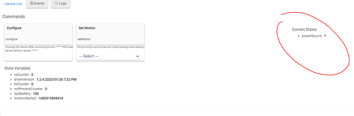

I have the device paired and the driver set. How do I get it to recognize motion?
That typically means it didn't fully pair.
Put Hubitat back into pairing mode.
Press and release the button on the FP1...the blue led near the button should blink once.
Wait for Hubitat to say it found a known device.
Check the attributes.
It seems to pick it up. I've done the pairing thing over and over and it looks the same each time.

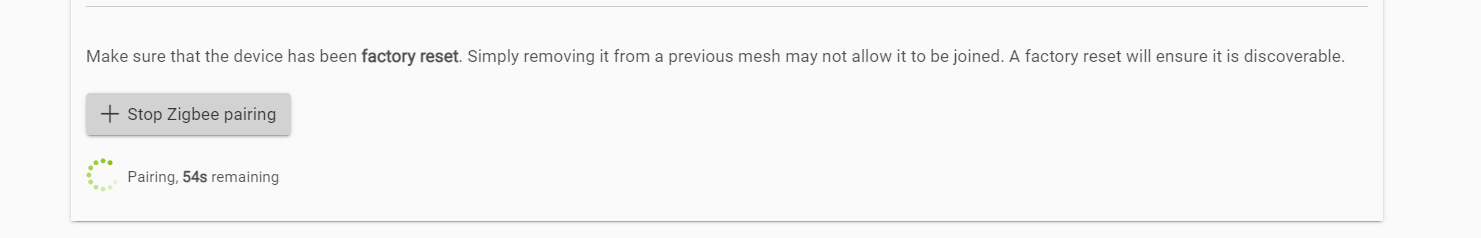

  1. Move the sensor near the hub. Within a few feet.
  2. Delete the device from Hubitat.
  3. Reset the sensor by holding the button until the light flashes.
  4. Put the hub in pairing mode and complete pairing.
  5. Open the device page and see if you still have just the ?
  6. If so, put the hub back into pairing mode then press the sensor button once; make sure the LED flashes.
  7. After the hub finds the known device again, check the device page again.
  8. After the device attributes update, move the sensor back to its final location.

Just had "dc" now.

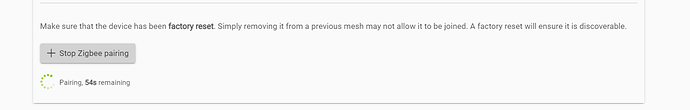

I ended up messing up my ZigBee network with all the pairing. The Aqara sensor ended up not connecting after dozens of attempts.
I can confirm that the pairing of the Aqara FP1 presence sensor on C-8 hub is now broken.
Stays forever at "Found a Zigbee device, initializing..."
Pairing to C-7 is also partially broken. It pairs normally the first time, but when paired again to a C-7 hub, the screen stays on "Pairing...." until it times out :
