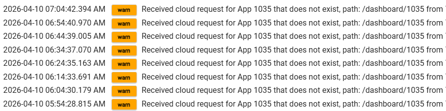

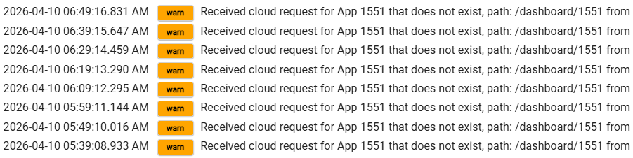

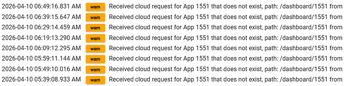

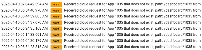

So what are the next steps (are there any next steps?) when we have errors like these and it's "too late" to use this app? (Search results "not found.")
I have two MIA dashboards that have been getting called for a while now, one on each production hub. How to find the caller?
Usually the warning message has an associated IP address. Sometimes that is useful, but if it's something that is using AWS you're back to guessing.
