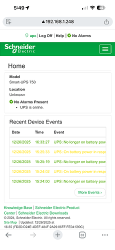

Not sure this is all that helpful to understand the status, but here is what I get when I execute "detstatus -ss" via telnet on my oldest of my five NMC2s:
E000: Success
Status of UPS: Online, Smart Trim, Site Wiring Fault
Last Transfer: UPS battery test
Input Status: Trim
Next Battery Replacement Date: 06/06/2025

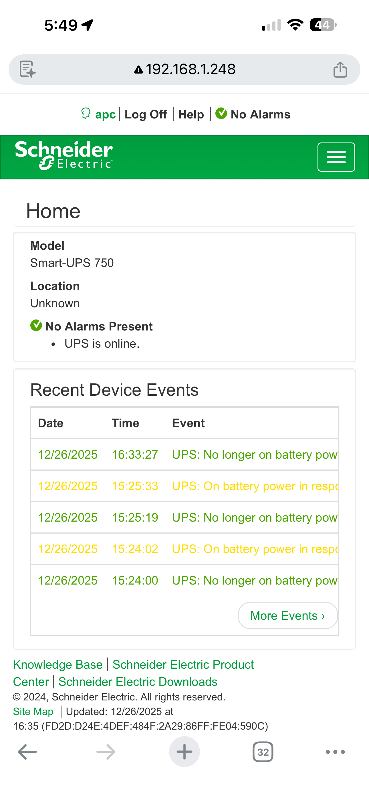

Hey Marc I had some odd behavior today with the driver that I’m trying to trouble shoot. The boss (my wife) brought in a chef to cook for a party. He brought multiple fryers and a bunch of other devices that, no surprise, blew a breaker. Took me a little while to sort it out because a GFI also tripped. But no big deal.
The UPS behaved as expected, as per the screen on the front of the UPS as well as the web UI. It flipped to battery for awhile and then returned to mains power when the drama subsided.
Web UI
However, my HE device never saw any corresponding events, including no change in Online status. Never showed On Battery or any similar terminology.
Here is the device log. These two warnings repeat constantly.
dev:1882025-12-28 05:50:58.177 PM warn [APC SmartUPS Status] resetTransientState(): Detected residual state keys (deferredCommand) during sendUPSCommand
dev:1882025-12-28 05:50:58.176 PM warn [APC SmartUPS Status] sendUPSCommand(): repeated deferral detected for Reconnoiter; forcing full session reset
Any pointers?
