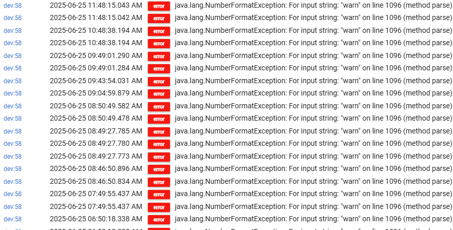

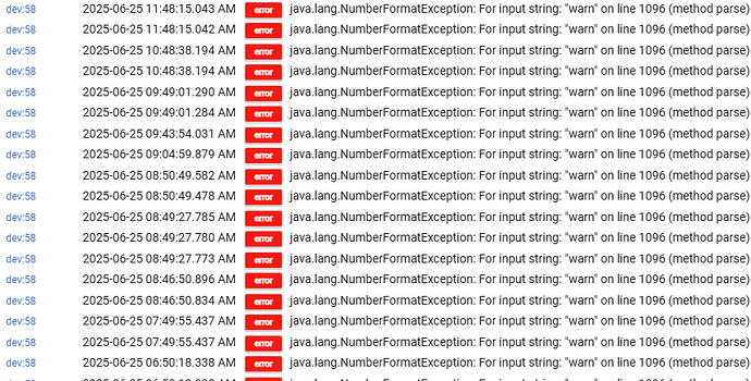

I can't get the LED to stop lighting up. I changed the parameter a couple days ago and it still is flashing at any event. Also there's a bunch of errors in my log
Hello. I reproduced the issue, and it happens if you set "Warn" or any other non-default logging level on the driver from Aeotec Support and then switch to my driver. I will deliver later the safeguard for this in next version of the driver, but you can easily fix this on the current driver by simply selecting a different log level.
Just go the "Preferences" section and set all your preferences to your liking AND also set the Log Level at the bottom to Info, Warn, or any supported option.

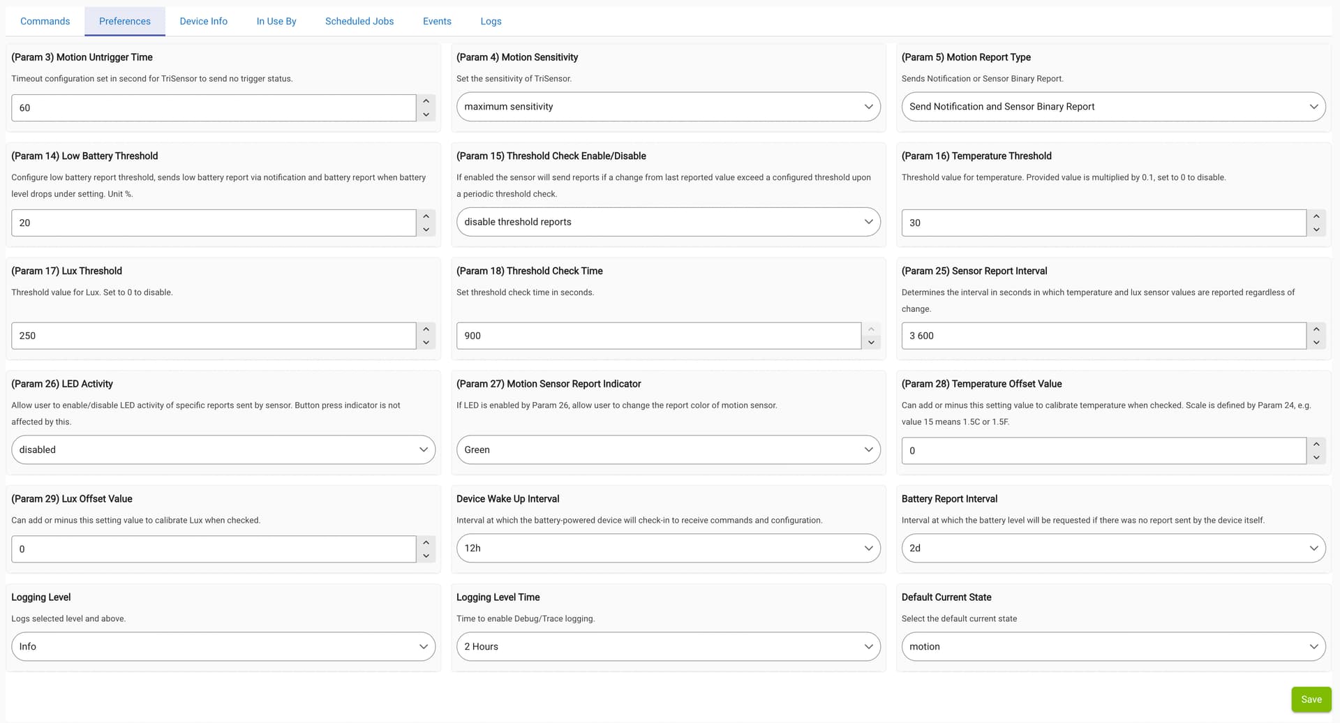

My LED notifications are still flashing on the Aeotec for some strange reason even after I updated the driver.
You need to go to preferences and save again with LED option set disabled. Also you don't need to wait for the wakeup period. You can take the sensor and press the button inside for 3 seconds until it flashes blue, and it will do a wakeup.
