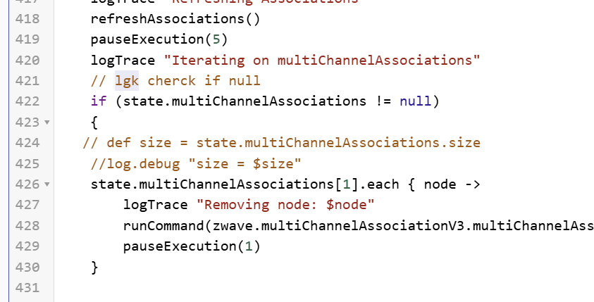

i have a modified version for the gen5 that i made some changes to reduce reporting every 20 secs. and also to get rid of some errors.. it has all the configuration parameters that are missing in the stock built in driver. if anyone is interested.
the gen5 had an error in the code that was stopping updating and only worked on refresh.. similar to what you describe... dont remember what i changed but that could be it.. here is my version
i looked through the code i think i had to add a check for a null value here to fix it.
