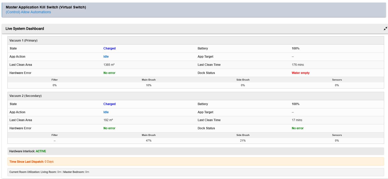

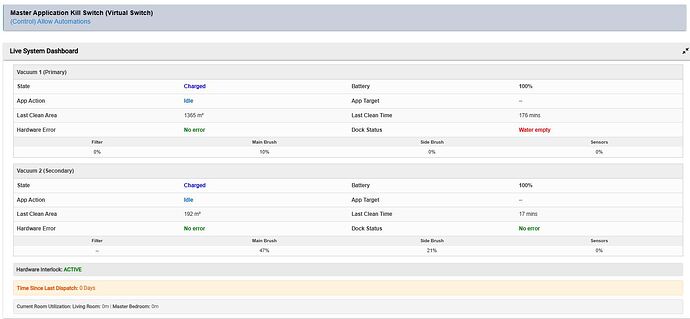

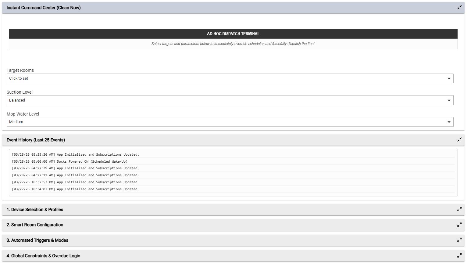

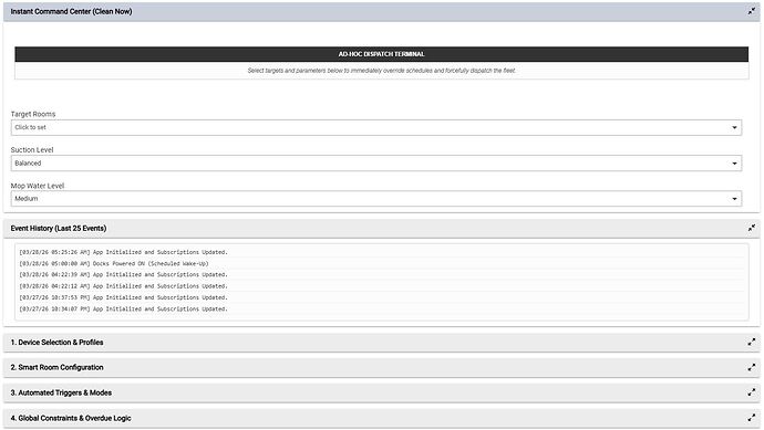

7. Live Dashboard & Instant Command Center The app generates a clean, HTML-based dashboard right in the Hubitat UI. It provides live telemetry across your fleet (Battery, Status, Hardware Errors, Dock Errors, Last Clean Area/Time, and Consumable Lifespans). It also features an Ad-Hoc Command Terminal allowing you to immediately dispatch the fleet to multiple rooms with custom suction and water parameters, bypassing all schedules.

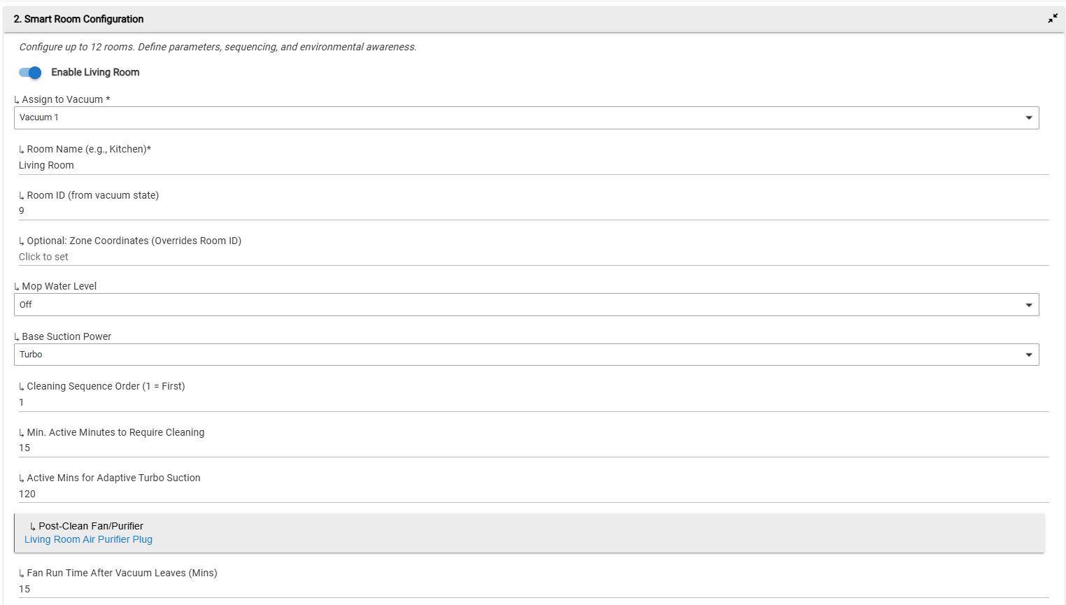

Step 2: Room-by-Room Evaluation The app iterates through your configured rooms (up to 12) and subjects each to a rigorous checklist:
  • Perimeter Check: Is an exterior door (Contact Sensor) open? If yes, skip the room to prevent escape.
  • Climate Check: Is the humidity too high? If yes, skip to protect the motor.
  • Occupancy Tally: Has the room seen enough human traffic (measured in accumulated active minutes) to warrant a clean? If no, skip the room to save hardware wear.
  • Active Presence: Is someone physically in the room right now (Motion/Lights)? If yes, skip the room for now.
Step 3: Dynamic Parameter Adjustment For the rooms that survive the checklist, the app determines how to clean them:
  • Is media playing? -> Force Quiet Suction.
  • Has the room seen incredibly heavy traffic today? -> Force Turbo Suction.
  • Otherwise -> Use the room's baseline configuration.
Step 4: Queueing, Dispatch, and Dust Settling The app sorts the surviving rooms by your preferred sequence order. It dispatches the primary and secondary vacuums simultaneously to their assigned zones. Before the vacuum enters a room, the app can optionally turn on an air purifier or ceiling fan. Once the vacuum finishes that room, the app runs a countdown timer to let the airborne dust settle before turning the fan/purifier back off.

:bar_chart: Live Dashboard Improvements
The internal dashboard has been restructured for better scannability at a glance:
  • Active Intent Tracking: See exactly what the app is "thinking" for each vacuum,
    including dispatched sequences and masked target rooms.
  • Hardware Interlocks: Clearer status indicators for the Master Virtual Switch and Physical Master Switch to help troubleshoot why a vacuum might be staying docked.
  • Activity Logs: A dedicated room-by-room breakdown of total motion activity minutes and recent dispatch statuses.
