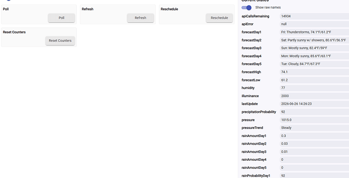

        command "refresh"
        command "poll"
        command "resetCounters"
        command "reschedule"

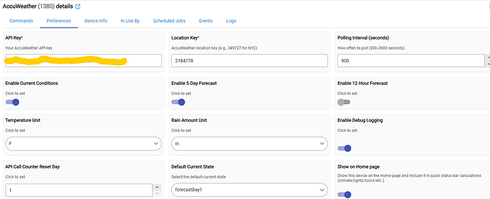

    preferences {
        section("AccuWeather API Configuration") {
            input(
                type: "text",
                title: "API Key",
                description: "Your AccuWeather API key",
                required: true,
                displayDuringSetup: true
            input(
                type: "text",
                title: "Location Key",
                description: "AccuWeather location key (e.g., 349727 for NYC)",
                required: true,
        section("Polling Configuration") {
            input(
                type: "number",
                title: "Polling Interval (seconds)",
                description: "How often to poll (300‑3600 seconds)",
                range: "300..3600",
                defaultValue: 900,
            input(
                type: "bool",
                title: "Enable Current Conditions",
                defaultValue: true,
            input(
                type: "bool",
                title: "Enable 5‑Day Forecast",
                defaultValue: true,
            input(
                type: "bool",
                title: "Enable 12‑Hour Forecast",
                defaultValue: false,
        section("Unit Preferences") {
            input(
                type: "enum",
                title: "Temperature Unit",
                options: ["C", "F"],
                defaultValue: "F",
            input(
                type: "enum",
                title: "Rain Amount Unit",
                options: ["mm", "in"],
                defaultValue: "mm",
        section("Advanced") {
            input(
                type: "bool",
                title: "Enable Debug Logging",
            input(
                type: "number",
                title: "API Call Counter Reset Day",
                range: "1..28",
                defaultValue: 1,
                displayDuringSetup: false

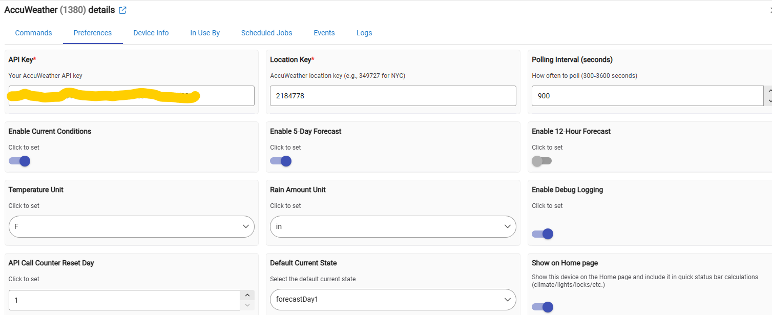

Edit: I missed specifying units. The driver is updated now to let you choose in/mm rain, and F/C temp in preferences.

Open Weather and AccuWeather certainly do not match right now.
Open Weather:
AccuWeather:
This show the problem I was having with Open Weather... it really likes to report 100% chance of rain way too often.
