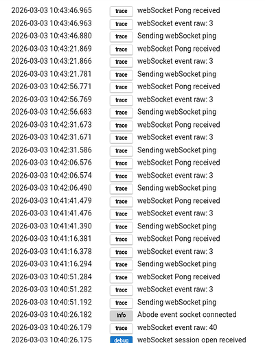

Apparently unrelated to my previous issue I recently noticed that WebSocket events have stopped flowing. After investigating, I found the connection drops at exactly 85 seconds every time — which is the sum of Abode's pingInterval (25s) + pingTimeout (60s).
It appears Abode's Socket.IO server now expects EIO=4 protocol (client sends pings) rather than EIO=3 (server sends pings). The driver connects with ?EIO=3, so neither side initiates pings, and the server disconnects after 85s. @x86cpu can I confirm that I am on the right track here?
In testing I found that
  • ?EIO=3 — connection drops at exactly 85s, every time
  • ?EIO=4 — connection stays alive indefinitely with client-initiated pings getting pong responses
I tested on my local copy but have so far been unable to get a sustained ping to go out. All scheduling methods (runIn, schedule, runEvery*) for a WebSocket keepalive ping register without error but never fire — also a stuck Quartz trigger persists through reboots and unschedule(). But I don't have much experience with this so it could be I am just on the wrong track.
Is anyone else seeing Abode events that stop working, or connections dropping? The driver does auto-reconnect every 5 minutes via checkSocketTimeout, so you might not notice unless you're watching the logs closely — it would just look like periodic reconnects.
I will take a look, so far it's been working for me as-is.
I did a logout/login and no issues still. Even after 3 mins.
So it seems:
EIO=4 (Socket.IO v4): Default for Socket.IO v4. Requires the client to send the CONNECT message packet (40).
EIO=3 (Socket.IO v2/v3): Used in older versions. If a v4 server receives this, it may require the allowEIO3: true option for compatibility.
I am testing changing to EIO=4 with my home Abode.
Ok.. Going back to EIO=3, mainly as:
EIO=3 (Socket.IO v2.x)
Initiator: The client sends the Ping.
Response: The server responds with a Pong.
Packet IDs: Ping is 2, and Pong is 3.
EIO=4 (Socket.IO v3.x and v4.x)
Initiator: The server sends the Ping.
Response: The client responds with a Pong.
I keep seeing server side send a Pong, not a Ping, which is EIO=3 The code should send a Pong to a Ping, or a Ping to a Pong, whatever server side sends. However only seeing server side sending Pong, impllies the EIO=3 use.
