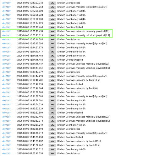

I have a C-8 Pro on 2.4.2.138 with a Z-wave Yale Assure 2 that started creating weird redundant log entries. I haven't noticed any strange or unwanted locking or unlocking, but I've never seen the redundant (but strangely also woreded differently) logs when unlocking the door. I also seem to see way more battery status entries in the logs than I used to see. Not sure why. Nothing seems to function poorly. See image below:
