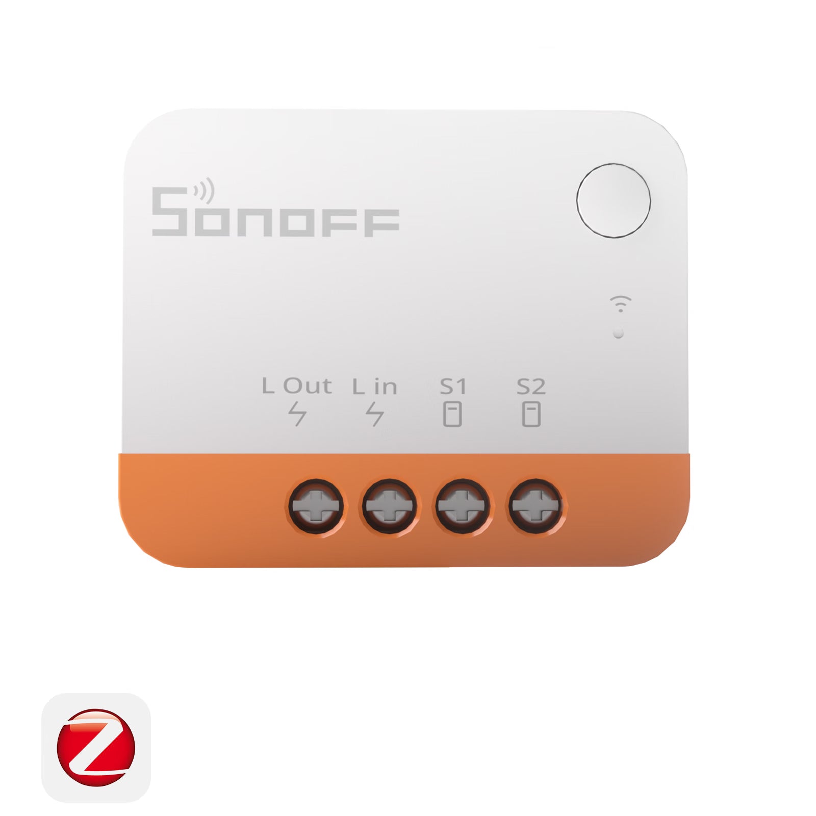

You need a "no neutral" relay. Something like this product from Sonoff would work:

I was thinking something would require a ground at least so there would be a return path to power the relay circuit.
Will order and give it a try. Worst case. 15 bucks if it doesn’t work !

In this case. There is only the single hot going to the switch and the return hot going back to the light. Was wondering how a relay works when there is no neutral but a quick ai search tells me that the relay leaks some current back to the light. Not enough to power the light but enough current to create a small potential across a resistor that will power the relay circuit.

Just be aware that due to the way these devices operate, there will be a few milliamps of current passing through the device, even when it is turned off.
This usually isn't an issue for devices that require a lot of current to operate (like incandescent bulbs), but devices that require very little current (like LED lights) may glow dimly, or flicker, when the relay is off.
So if your under cabinet lighting is LED, you may experience this issue. There are some methods to reduce the problem, should you notice it.
