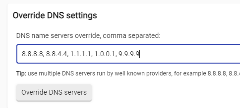

You can manually set the DNS on the hub in the network settings, overriding the DHCP settings. You can do that without setting a full blown static IP.
Maybe just try it like the example as a test?
Then you could go to the ping test and try to ping again, see what IP it resolves to now.

I will try overriding the DNS settings. Any thoughts on why this is not an issue with my two working C8?

I have returned to my cabin. I have implemented the recommended DNS Override settings in my backup C8 and then again tried to replace one of my C7's. Still did not work.
