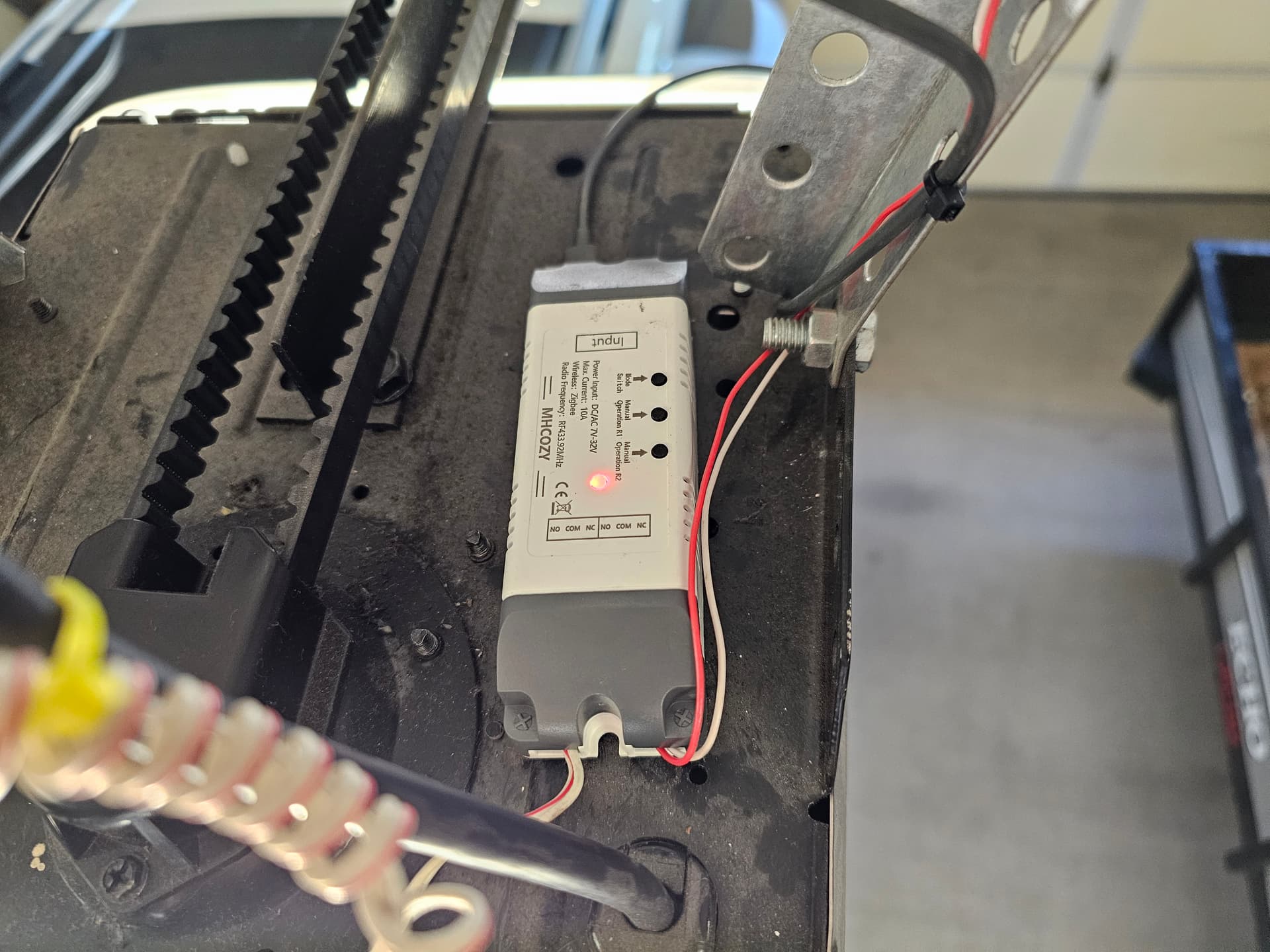

@destructure00 If you want to move away from z-wave (zen-16/17's are great though) You could use these
https://www.amazon.com/MHCOZY-Adjustable-Self-Lock-Momentary-Interlock/dp/B091GS6J5W
Thanks for this - I actually have one of their 2 channel relays running my pool equipment. I'll grab another one and test on the garage door.

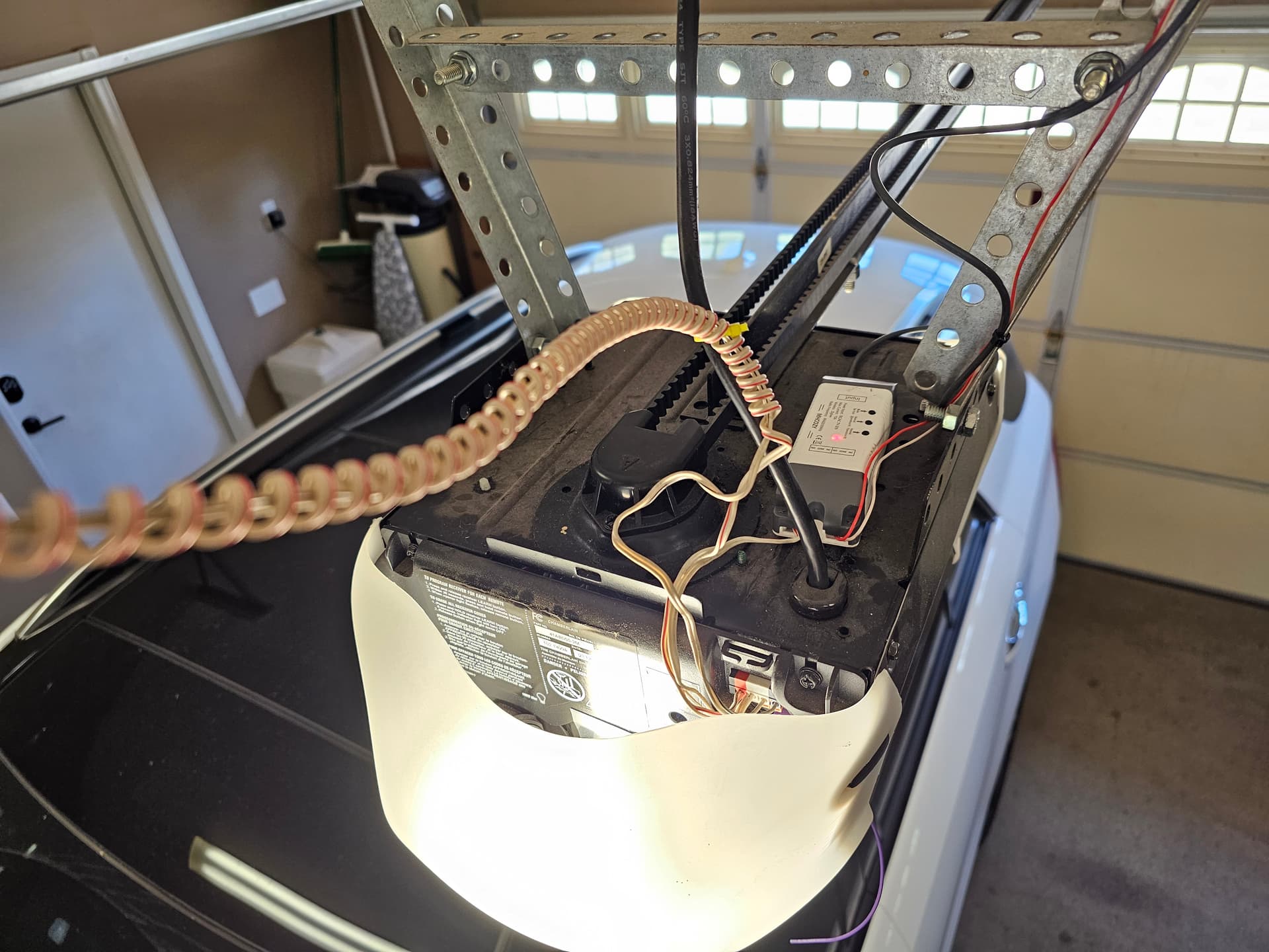

Installed this yesterday. Pleasantly surprised to see that it came in a plastic case...the first one I bought awhile back was just a raw board. Working great so far, paired with two spare contact sensors I had in a drawer and using the Zooz Garage Door app to run it. Had to run some wire across to the second door but not really a big deal. Ordered a second setup for the shop as well.
