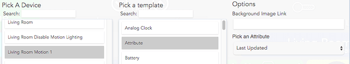

Have you tried using the 'last updated' attribute for the dashboard?
@JNS
Most devices have temperature and other things as well so it would work well, the device would update on other functions

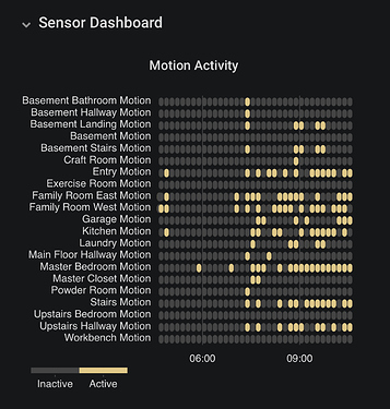

There’s not an easy way of doing this in Hubitat’s UI. Your best bet would be to export motion data into a database and use Grafana.

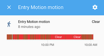

Or you could export the data into Home Assistant which will let you view the history of any device.

:flushed: I'm impressed ! Ok, going to start looking into Grafana....

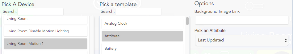

Tile Master!
@bptworld
Thank-you Bryan, I'll try your app
