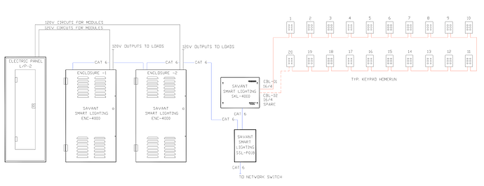

A typical Savant lighting installation in the US looks like this:
In this setup, the wiring to the keypads/switches is all low voltage wiring that does not directly control the load. The low voltage wiring goes to a control panel, which connects to relays also via low voltage control wiring.
So, in the US, removing a Savant system will require new wiring that directly controls the load to be run to each keypad/switch.
Unless a typical Savant setup in Europe different from setups in the US, you will not be able to swap your Savant keypads for zigbee switches.

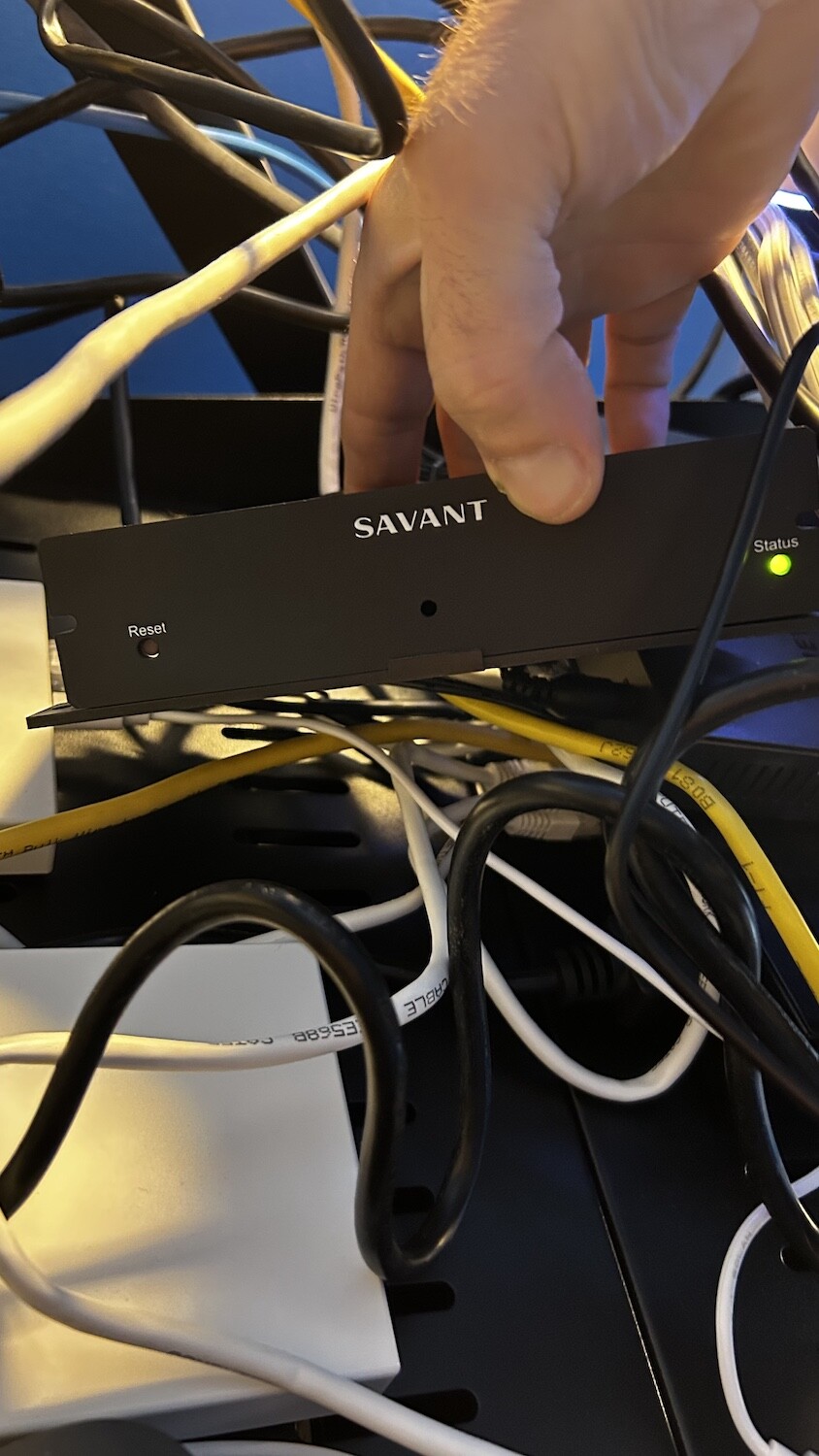

So, a bit more about what I do know about my electrical wiring and the Savant setup:
There is a Savant Host (linux box) connected to my network via ethernet.
Each switch has a USB plug I can connect to from my ipad and Savant Host app, where it'll allow me to update the wifi password/connect to a new wifi network.
All switches are wifi connected, as I suggested above, which makes me wonder if they aren't wired in the way you mention?
When they are not connected to Wifi, or wifi is out, or savant host is unplugged for instance, at every switch, if I hit any button on it, it will control the "dumb" switch, meaning whatever the light switch would control if it was a normal rocker.
I have not seen, definitely know, there is not any other Savant modules, enclosures, SKL-4000, Enc-4000, etc
As far as I am aware, I just have the Savant Host, and about 12 of these Savant lighting switches.
Pretty sure (probably obviously) they are hooked up also with a neutral which allows the slight power to them to be able to stay connected via wifi (which still has a delay or need to be pressed twice to get them to wake and work).

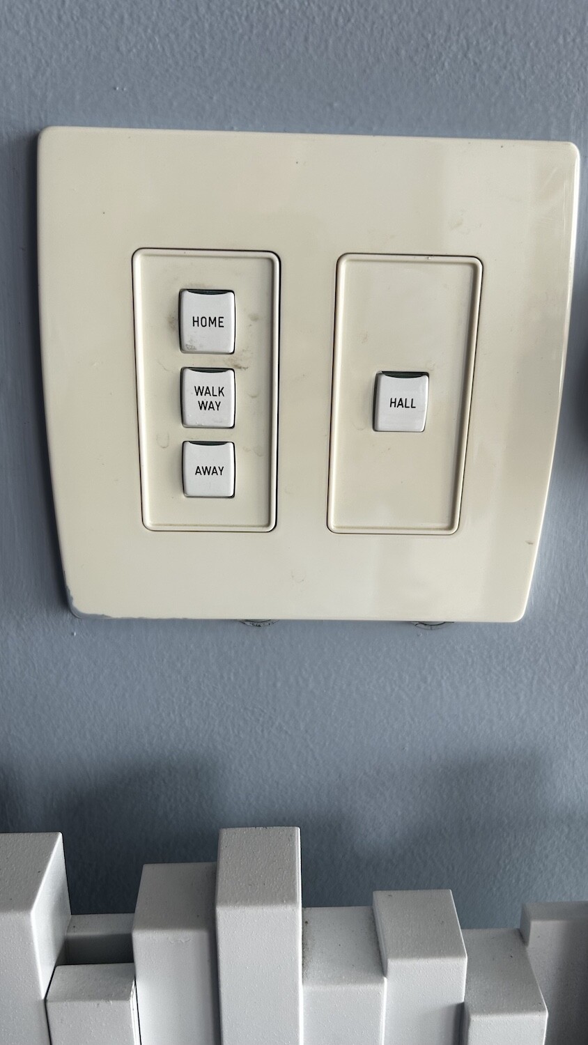

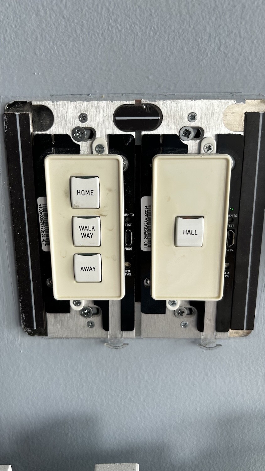

See attached pics of what I know I have.
If it's still possible that this is wired in a way that can't just swap out for Zigbee, and is low voltage , is there a way for me to find out?

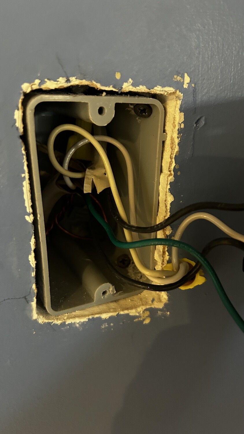

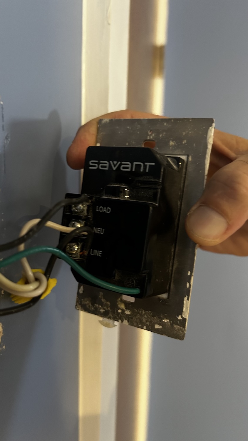

Can you pull one of the switches off the wall and take a photo of the wiring behind the switch.
I think my assumption is correct? Load, Line, Neutral and Ground.
Looks good!

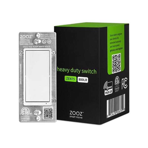

yeah, I've been looking at the Zooz switches. They look like they'd work, although I have one switch that controls a fluorescent tube light w/ ballast (I assume) which these say they don't work with. Maybe an Inovelli for that particular switch, or maybe I'll just change out that one fixture since it probably makes sense to convert to a normal fixture from tube light (its at the bottom of an exit stairwell where it doesn't need to be fancy).
There now is a Zooz switch that will control tube lights and other what they consider heavy duty loads. The ZEN75.
Thanks for all the suggestions. And great to know about the ZEN75. I'll be starting off small to replace some of my Savant switches and see how it goes. FWIW I'll post back here on the success (hopefully) of converting over from Savant.
I am a big fan of Zooz switches, they are reliable and well supported by Hubitat. I recently installed some Kasa switches and lights. They are WIFI and also work well.
