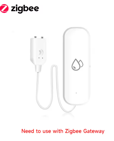

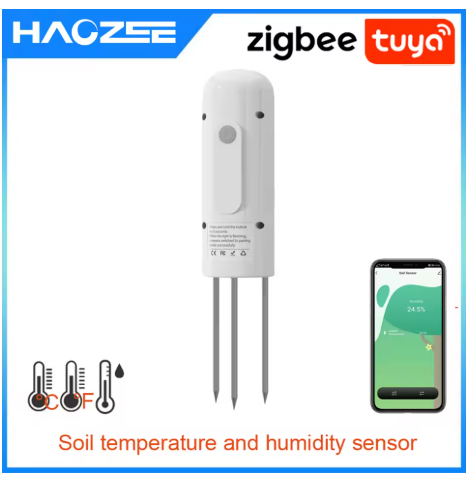

I have both of these type sensors referenced (bought on Aliexpress). Soil moisture was more expensive.
Both work well for their intended purpose. The water leak sensor responds to a damp finger placed across it's probe, so you maybe be able to use it as as a water level (in a water tray) or as a soil moisture (buried at desired depth in soil). It simply gives a wet/dry output.
The true soil moisture sensor reports the actual moisture content of the soil as a percentage. Others have reported issues with this particular sensor but they have worked for me.
Note I am not a professional gardener by any sorts. The soil moisture sensors were for some of my wife's house plants. While the leak sensors were to detect water leaks.
There are Hubitat drivers for both on the custom apps and drivers forum.
Water leak sensor.
Soil moisture: Note, this sensor is large, 1.75" diameter x 7.25" tall inc. probes
