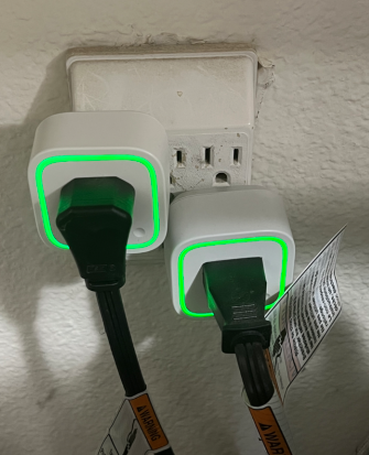

Looking for a wall outlet (not a plug) that is Z-Wave, does not require a neutral, and has power reporting for each outlet. Zooz has nothing.
These will be monitoring a washing machine and a gas dryer.
I am currently using 2 ZEN 15s and want to use those for another purpose. The outlet they plug into has a loose internal connection so it needs to be replaced anyway.

As others have said, you already have neutral in that box, so you can drop that as a requirement.
The ZEN15 is the best suited device for this application, so I'd just buy more (or use a less expensive option, if appropriate) for your other uses.
And if your outlet has an internal loose connection, replace it with a dumb outlet (for a dollar or two) before your house burns down.
Ok. How about using 2 plugs similar to the ZEN15 but in a smaller form factor that report power? Was searching on Amazon and found a few but not sure if they are supported.

They don't seem to be available any more and the 7 is expensive still. But they do look like they'd fit in a duplex outlet, without the need for the adapter I'm using.
Going to buy two more ZEN15 and replace the outlet.
Thanks for the help.
