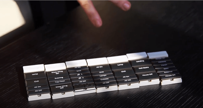

Anyone have any recommendations on switches that look like the ones below. They were from a control4 video, so I assume will only with that system but is there anything similar that will work with Hubitat? Video was from here YouTube
How much are you willing to pay? Lutron has a few keypads that work with RA2 (the most similar to what you want are probably seeTouch and seeTouch hybrid, plus a tabletop model) that you can see here: Lutron RadioRA 2 Components and Compatible Products. Other systems like HomeWorks QS have similar devices. All can be engraved by Lutron if they come with the "engraving certificate," which they should if they're new. They're technically only available from professional installers (everything in their home line above "plain" Caséta is intended to be), but they are pretty easy to find on the secondary market. Most are just more than I want to pay.
For something cheaper, a Lutron Pico remote is pretty similar. You are supposed to be able to get them engraved, too, but I know only three things about that: it drives up their cost significantly (the light/dimmer pre-engraved 5-button model, 3BRL, is very cheap; I think engravings start closer to $100); it seems to be hard to find ones able to be engraved on your own (you might really need to go through a pro for this, though some online supply stores can probably do it with a rep); and that because of all this, I've never bothered and just used a Brother P-Touch labelmaker if I cared about the labels. :slight_smile: (They do have some "standard" pre-engraved model, like a 4-button scene-labled Pico, and a variety of 5-button Picos labeled for not just lights but also things like blinds, music, or a fan; most cost more, sometimes a lot more, than the lights/dimmer-looking one. Have I mentioned that I'm not opposed to the 4-button Pico--a tad more expensive but not usually insane--and a labelmaker?)
I'm sure others may have other ideas, but but basically, Lutron has a lot of options here. Most should be able to be integrated into Hubitat as long as you have at least a Caséta Smart Bridge Pro (non-Pro won't work) or an RA2 Main Repeater (or whatever the higher-end HWQS uses, which I'm not sure anyone has extensively tested on Hubitat but should be about the same). Most aren't cheap, but I can't imagine the above is either--and you can often find Lutron for less or even do it DIY-style with products from secondary markets, as I did with RA2 (my Main Repeater was maybe $150 tops on eBay--but I still don't care to pay seeTouch prices).

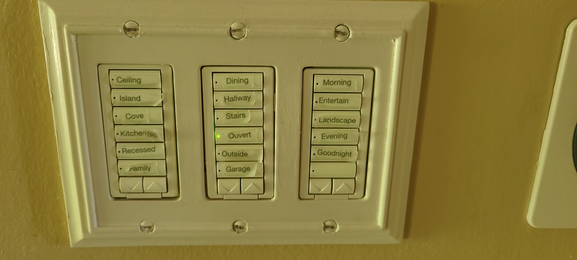

+1 for the Lutron RadioRA2 all the way! . We still have our "Prepaid Engraving Card" and use the stickies it comes with until we are REALLY sure what we want them to say.
Ouvert = Office around here. Odd that the pre-made stickers don't have "office"
