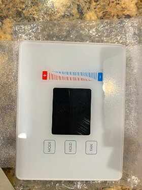

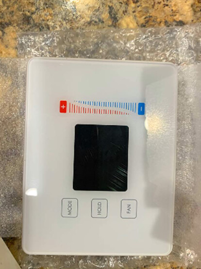

Centralite 3-Series Pearl Touch Thermostat, White https://www.amazon.com/dp/B01G99KR94/ref=cm_sw_r_apan_i_6JJTW88ZNTXZ0QEVN1GC?_encoding=UTF8&psc=1
It's just too bad you can only mount it vertically like that... :wink:
Lol, you said barbones which means cheap. You want cheap or horizontal. All seriousness I have it and it works great, though it doesn't have to do much since Hubitat is the brains of the operation. Can't remember the last time I even looked at it.
The older CentraLite HA 3156105 (xfinity branded) are battery operated and can be had for as little as $20 on ebay. Not fancy, but I've been very happy with one in my shop so i recently bought another for the garage.
