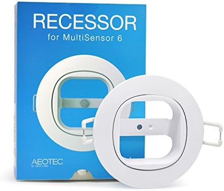

Has anybody used the Aeotec sensor with the recess kit and run USB power to it? If so, how did you supply the power? Or, any other builtin project for that matter?

If you plan appropriately then POE is your best friend. Otherwise you're going to be installing an outlet if one isn't already accessible.
Thanks, I just realized PoE was a possibility. I found this on a quick search.
https://www.amazon.com/UCTRONICS-802-3af-Splitter-Ethernet-Raspberry/dp/B01MDLUSE7
I certainly don't need Ethernet in my bathroom ceiling but I can use an old Ubiquity PoE injector and not have to worry about a high voltage transformer stuffed in the ceiling.
Yup those work. I run lots of devices off of POE. There are others available tp-link, trendnet are a couple that offer voltage selection and you can use different connector plugs for different devices.
You want to think about the microUSB ends...
The Aeon Multisensor comes with a unique right angle VERY low profile plug on a long wire. I'd really suggest finding a microusb that fits will be hard.
I'd look at something like:
https://www.amazon.com/gp/product/B073P7J1KR/ref=ox_sc_act_title_1?smid=A2Y9R0VEAYJBWE&psc=1
and just use the supplied white wire from Aeon.
You can get a POE switch, and have Multisensors all over the house.
Yeah that was just the first adapter I found. I hadn't even considered PoE for USB. Now that I realize that is a thing there are so many other projects that come to mind.
For an initial one-off I can re-purpose one of my AP injectors. I definitely don't want to use a port on the Ubiquity switch just for power.
All my runs go to a central location so the injector for the initial power is fine. I can later add a better solution if I get multiple devices setup.

The MultiSensor 6 comes with an internal microUSB connector and a specially designed right angle USB cable of about 6 ft.
I've purchased all the parts for a whole home solution, but have yet to climb into the attic to do that portion.
It starts with the idea of getting a big power supply and distributing 12v out to a number of locations. The 12v is converted to USB power by these:
https://www.amazon.com/gp/product/B07SQ4FV61
A power supply would look something like this:
https://www.amazon.com/gp/product/B07DL43LTJ
and you'd want a spool of wire:
https://www.amazon.com/gp/product/B077MHW8QH
100% usb powered MS6's means the option for a recessor goes way up...
Is that the answer you were looking for?? Or did I misread it completely?
The 12v is soldered into the Buck Converters in the ceiling/wall (behind the recessor) and the Aeon supplied power cable plugs in.
If All of your MS6 are in a tight circle, you can look at something like:
https://www.amazon.com/gp/product/B00YRYKEYM
but the 6ft Aeon usb power cable would need to reach.
What I’ve done is run cat5e or cat6 cable to each location where I have a sensor mounted (with the flush wall mount). You plug the cat cable into this:
PoE Texas GAF-MICROUSB | Gigabit... https://www.amazon.com/dp/B019BLMWWW?ref=ppx_pop_mob_ap_share
And then plug that into the MultiSensor 6. The other end I run to a closet where I have an 8 port POE network switch that provides power to each of the sensors around the house.
TP-LINK 8-Port Gigabit Ethernet Poe+ Unmanaged Energy-Efficient Switch with 124W 8-Poe+ Ports | Plug and Play | Metal | Desktop/Rackmount | Lifetime ( https://www.amazon.com/dp/B00E6LID0S/ref=cm_sw_r_cp_apip_asgUlOV6gKBkZ
Hope this helps.
