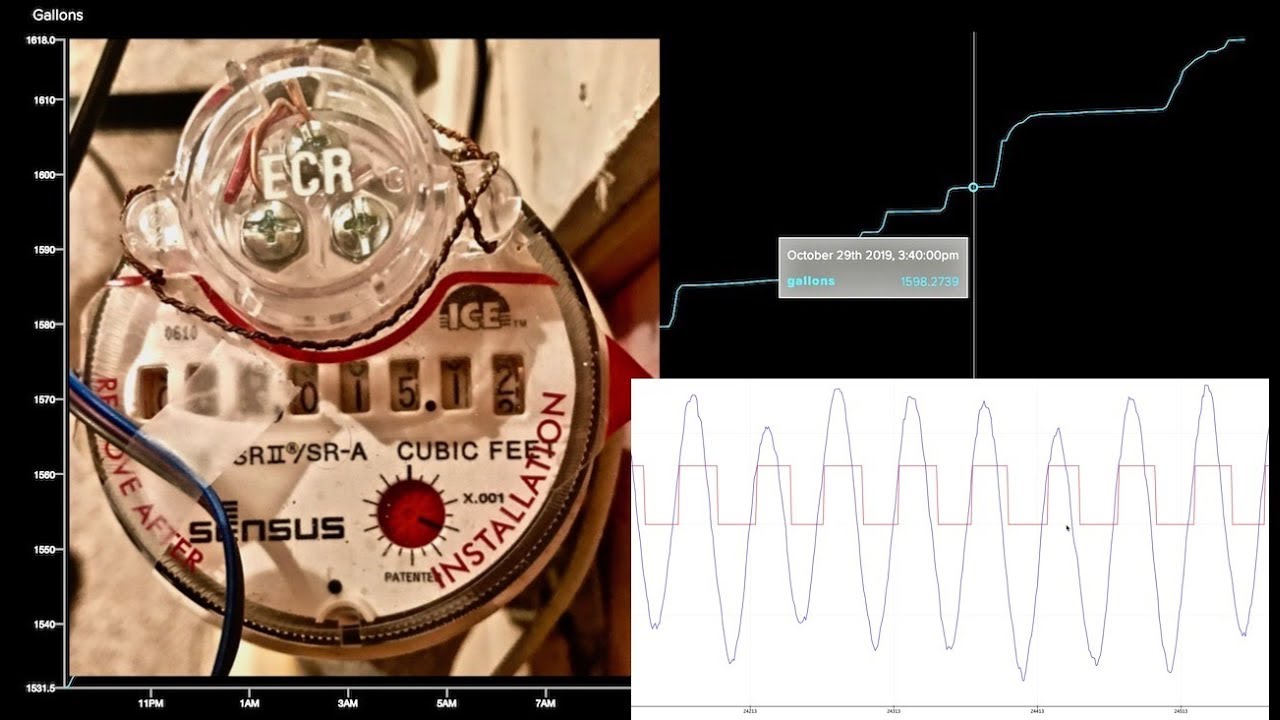

Readout for pulsed water meter
Thanks @ogiewon . Per your post I moved a couple PID controllers I have to ESP8266 and ESP32, I wish I tried Arduino sooner as it is much faster than Labview or using Beaglebones etc.
I got a water meter pulse counter that uploads to io.adafruit working with an ESP8266 and am now trying to get your HubDuino project going as this seems to be the holy grail of customized control with Hubitat. Now that I understand what it is, thanks for pointing me in your direction.
