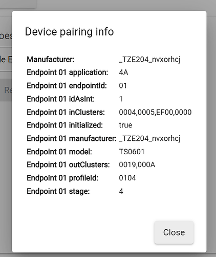

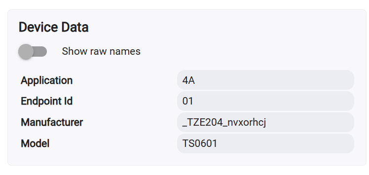

Thanks for the quick turnaround! It's still not working, unfortunately. I'm seeing the following warning, even if I don't touch the switch:

Infos about this specific 8 gang switch:
application 4A
endpointId 01
manufacturer _TZE204_nvxorhcj
model TS0601
