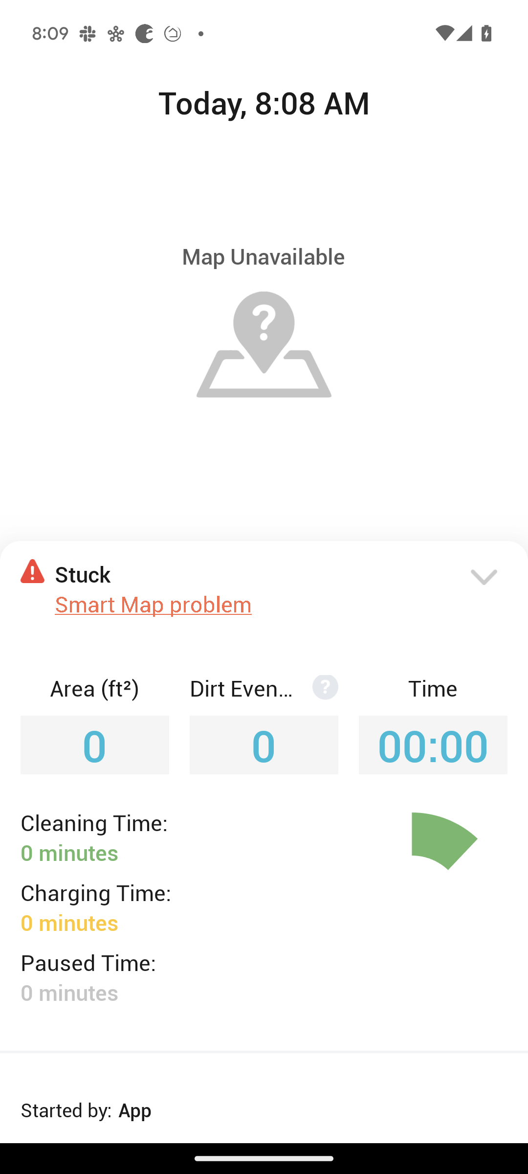

I'm having an odd issue that I haven't been able to fix. When I run a clean command from Hubitat or Postman, it will work one time. For instance, I send to rest980 a command for a single room, the request looks something like this:
    "ordered": 1,
    "regions": [
            "region_id": "16",
            "type": "rid"
    "pmap_id": "6_9UWjCsQ-6TUYRBkyveLw",
    "user_pmapv_id": "240216T205652"
pmap_id and user_pmapv_id are retrieved from the Roomba's state right before the command is sent. The Roomba starts cleaning and all is wonderful.
After it completes, I start another cleaning. However, this time, the Roomba reports and error and tells me to refer to the app for more details. More details:
Stuck - Smart Map problem - j Series Error 32 - Smart map version on robot does not match map saved on App.
However, if I start a new job via the iRobot app, it works just fine. The help article also goes on to tell me to reboot and "clean everywhere/clean all". After the Roomba completes cleaning everywhere 2 hours later, commands from Hubitat/Postman will work again, but only once. The cycle repeats, clean commands from Hubitat/Postman fail with the same error until I reboot the Roomba and tell it to clean everywhere. This is occurring on both Roombas.
My hunch is this may be related to the fact that I'm running the latest firmware version, but can't confirm. Any idea what's going on?
