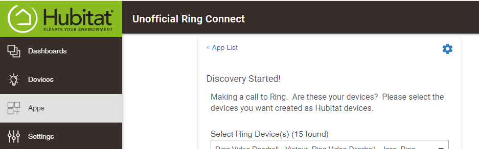

I assume you have installed the Unofficial Ring Connect app. To add a new device, open the app and click on "Discover Devices".
From the next screen, you should see a drop down that shows you the found devices.
Open the drop down, and ensure that all the devices you want are selected:
Click on "Next", and then "Next" again.
The new device(s) will then be visible under "Installed devices" on the App's home screen. They will also be added to your Hubitat Elevation (HE) "Devices".
Let us know if that worked for you!
