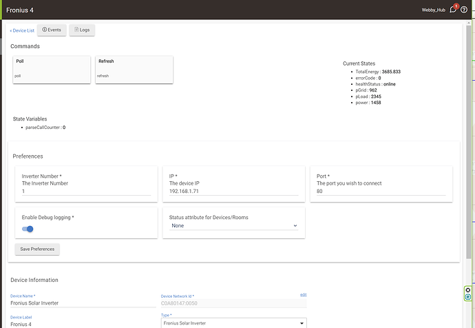

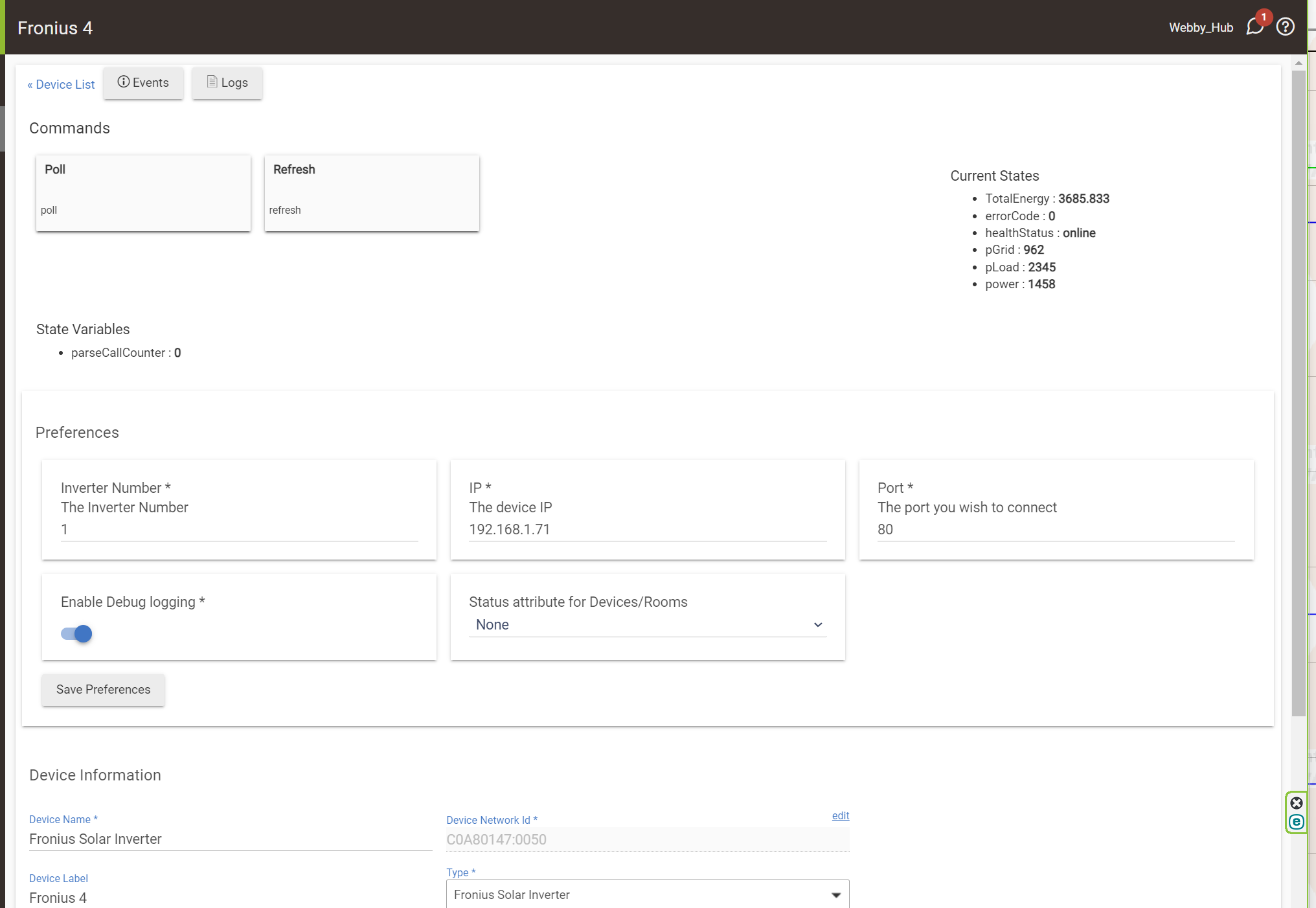

Hi Derek
We fixed Dave’s problem.

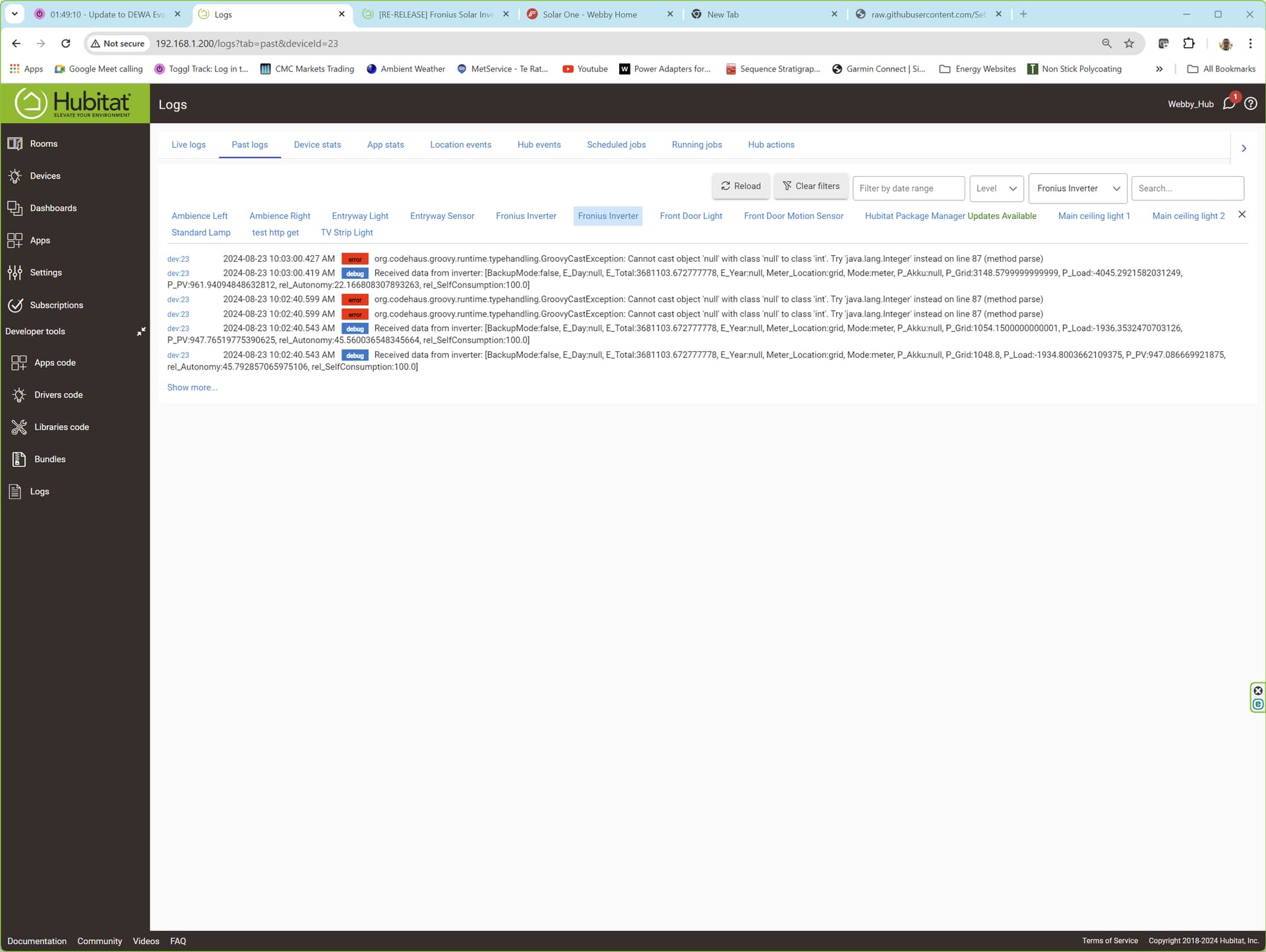

We determined that Hubitat was retrieving data OK from the Fronius.
The problem was an error caused by null values coming from Fronius in the E_Day and E_Year fields. These null values caused this error
“GroovyCastException: Cannot cast object 'null' with class 'null' to class 'int'”.
I found in the API manual that eDay and eYear are always null in GEN24 inverters.
We worked on Sabastian’s code which was returning the above errors where yours was displaying Connect Timed Out. We removed lines 87, 88 and 98 of Sabastian's code which all refer to year and day. After that, it works fine.

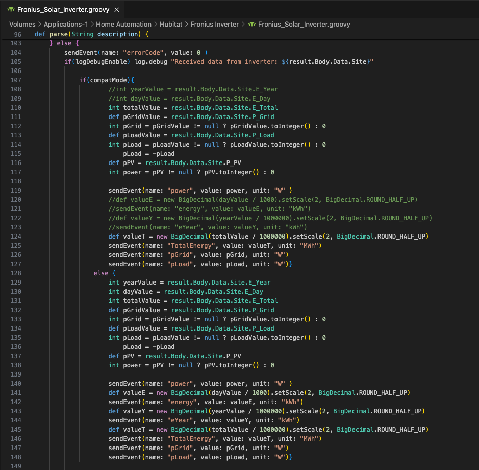

Ok, I've just uploaded v2.3.0 with a GEN24 Compatibility mode:
v2.3.0 - added GEN24 Inverter compatibility mode
SCR-20240824-kkjr
it's a pretty simple implementation to make it easier to tweak if needed:

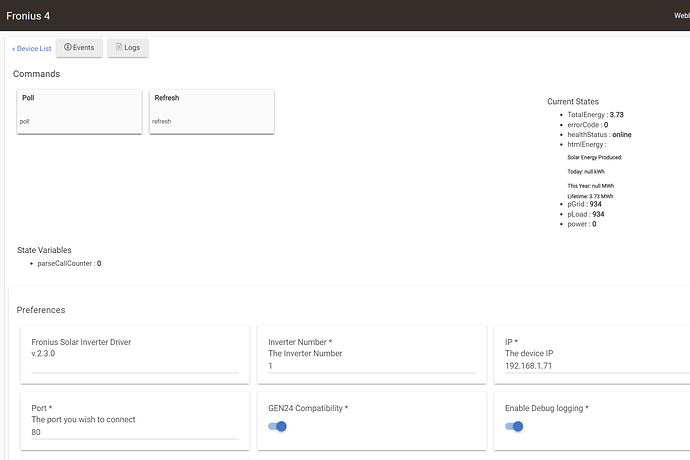

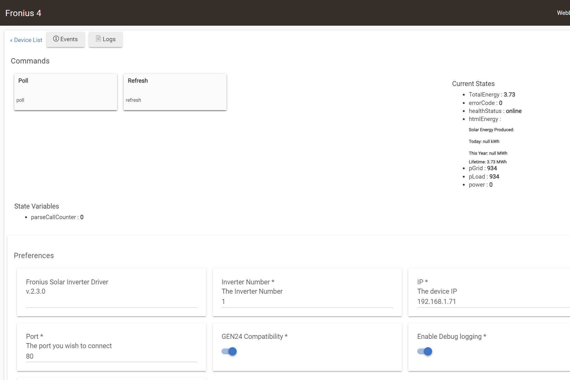

@dJOS , yes Derek it does work, Thanks Very much. My main objective is to use the data from this to establish when there is excess solar to start the car charging - I can call on the power value to do this.
Thanks very much for your help.
