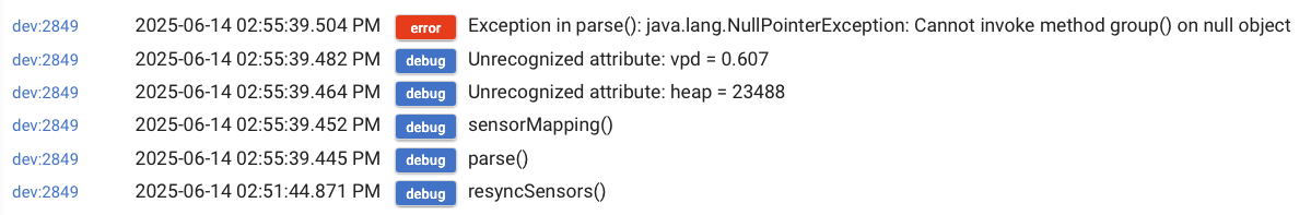

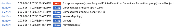

I visited your GitHub site linked above and grabbed the raw files. I opened each of the two drivers files and pasted your new code and saved. I didn't do anything with HPM. I think I did things right, but please direct me if I made any mistakes here.
Thx!

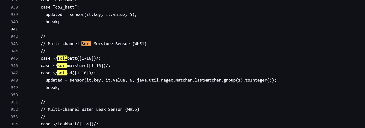

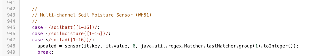

the gateway file should look like this so sho9uld not ever show unrecog attribute for those
Strange, here's mine:
Do I need to do anything to reinitialize the device or refresh somehow?
weird i am at a loss i would have expected an error.. but not it to say unrecog. attrribute..
Yeah, very strange. I may play around with it a bit and see what I can come up with. Thanks for helping out!

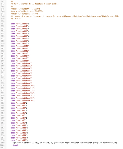

maybe it doesnt like the two digits there for testing you could hardcode like this

  updated = sensor(it.key, it.value, 6, java.util.regex.Matcher.lastMatcher.group(1).toInteger());
  break;

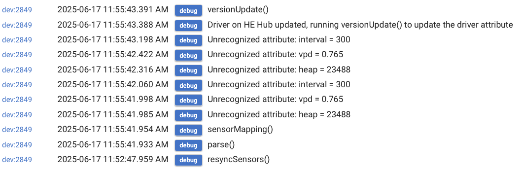

also confirm is the uncreg attribute warning coming out from the gateway driver or the sensor driver.
The attribute warning is coming from the Gateway. I don't seem to have any. logs from the sensor driver.
I also changed the code to use the explicit case statements, and I get this error:
2nd try.. try the new files posted above again.. i made some changes...

I think your latest update has things working for me! I only have 9 sensors, but all 9 now appear to be added and functional with regard to the moisture percentage. Awesome!!

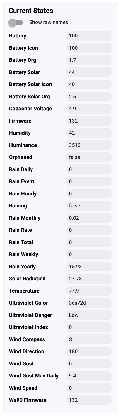

I also have a Wittboy with rain gauge, and here are all the values that are recognized by Hubitat:
I'm very happy with the integration, it's been a lifesaver for my gardens during hot dry stretches in Northern California.
