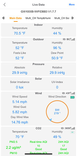

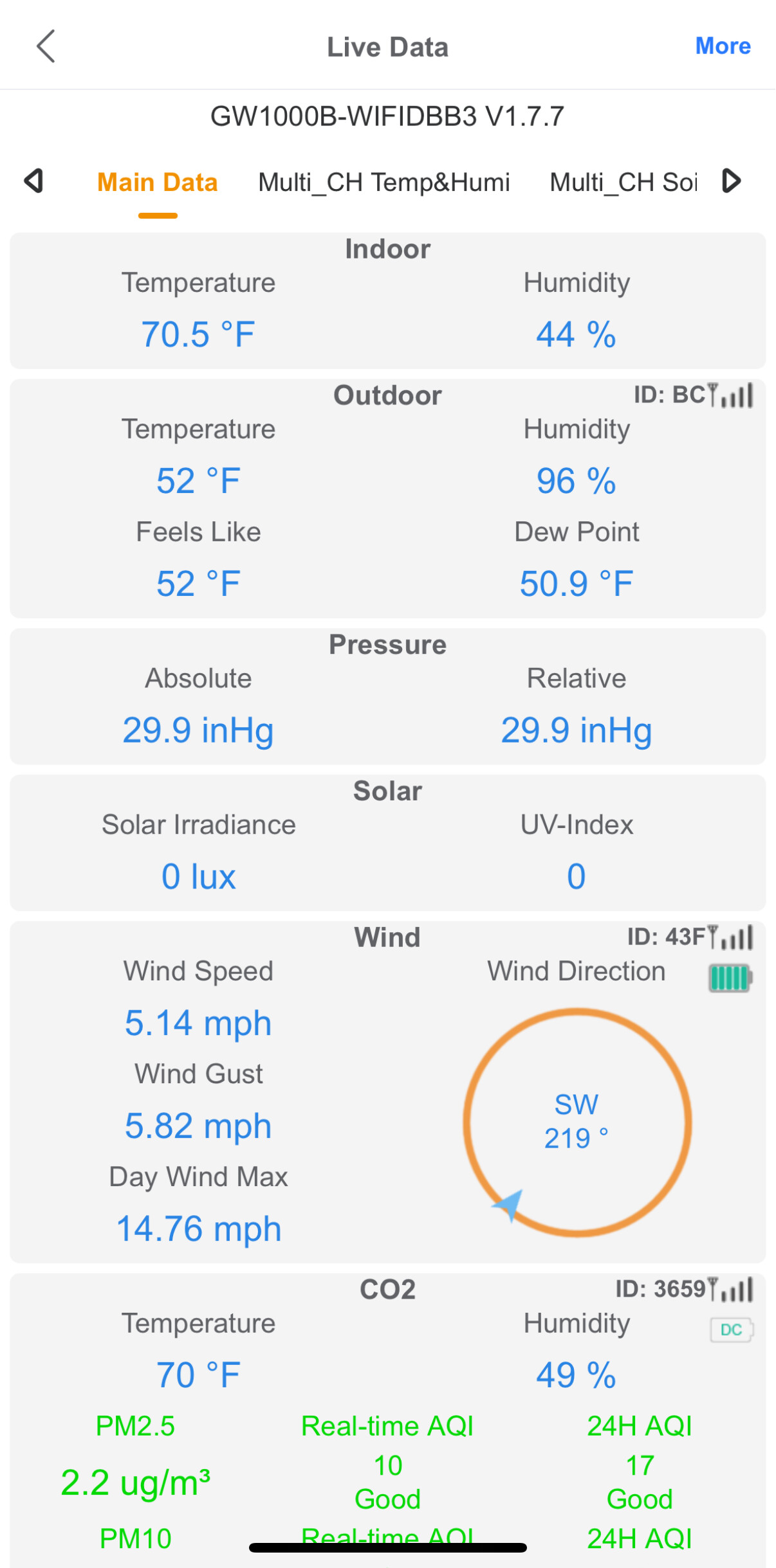

I use Ecowitt’s WS View app, and AFAIK the live view of sensor data is a local connection between the app on my phone and the ecowitt WiFi gateway on my LAN. See partial screenshot below.

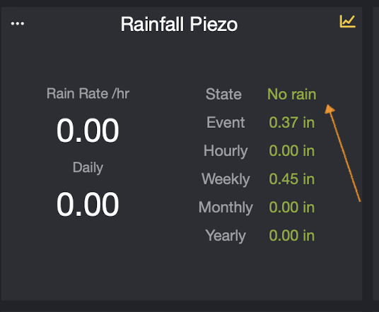

The Ecowitt client has a "state" that tells whether it's currently raining or not. Example:
Is this value available to Habitat somewhere through the integration? I can't find it.

its the new attribute that i added above. raining but hasnt been fully integrated by @sburke781 yet..
