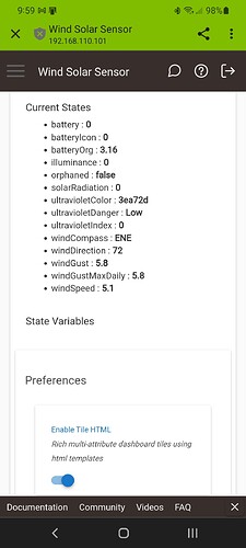

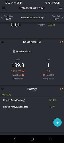

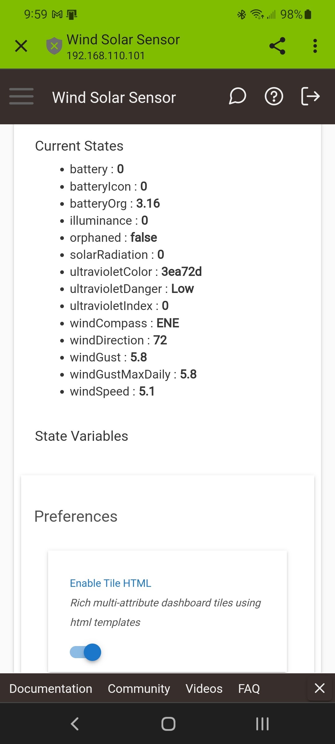

Edit 12/1/2022: Looking at the devices, it looks like I may be missing a few other pieces of data even though I don't see an error in the logs:
There's no data showing for battery, batteryIcon, illuminance, solarRadiation or ultravioletIndex in the windsolar device.

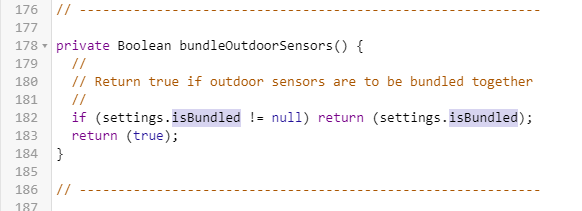

I may be able to help with the PWS combined part. I looked at the code and I think this might be simple. In the Gateway code the variable for bundled sensors is "bundleSensors" however in the driver code the variable seems to be "isBundled". I used the driver one and changed the one in the gateway code. Unchecked and then re-checked bundle sensors and then did a resync....my PWS came back. I'm not going to say that is the ONLY thing that needs changed but maybe I helped a little.

Parent lines 141 & 182 - highlighted in that post. I ONLY changed the variable name as it was different in the child driver code. If you want me to change it back, I can.

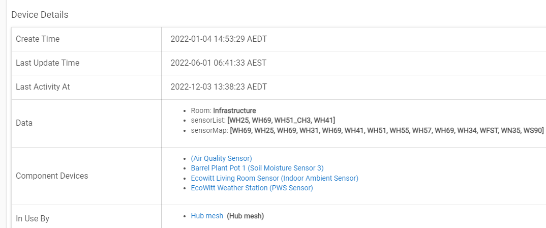

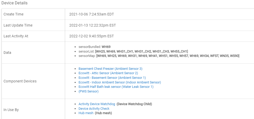

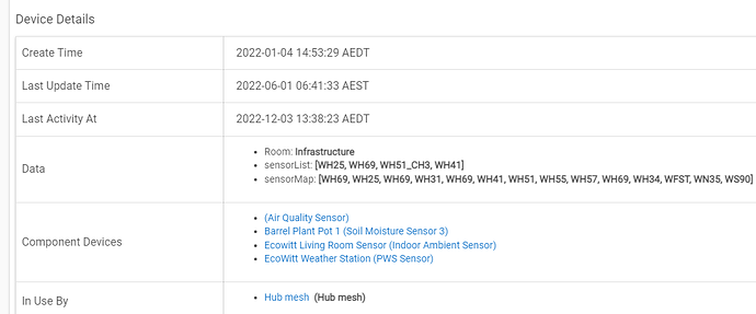

Do you still have the combined device? Or have they split out again?
still combined. In fact when I turned off the combined device...it was still there
The devices would only be re-evaluated when the resync happens, they wouldn't change immediately after turning off the setting I don't think...
