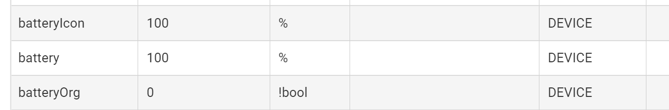

Looking at this, it seems the WH32 - Outdoor Ambient is pooched as well. The batteries are at least a year old and not likely still at 100%.
My outdoor batteries in my wh32's have lasted over a year. If u are using lithium that is normal, they will read 100 till a day or two before they die. To the guy who posted his device page... Is it a wh31 or 32 and can u post the events ..their may be no events (my guess). In which case your battery is really dead.

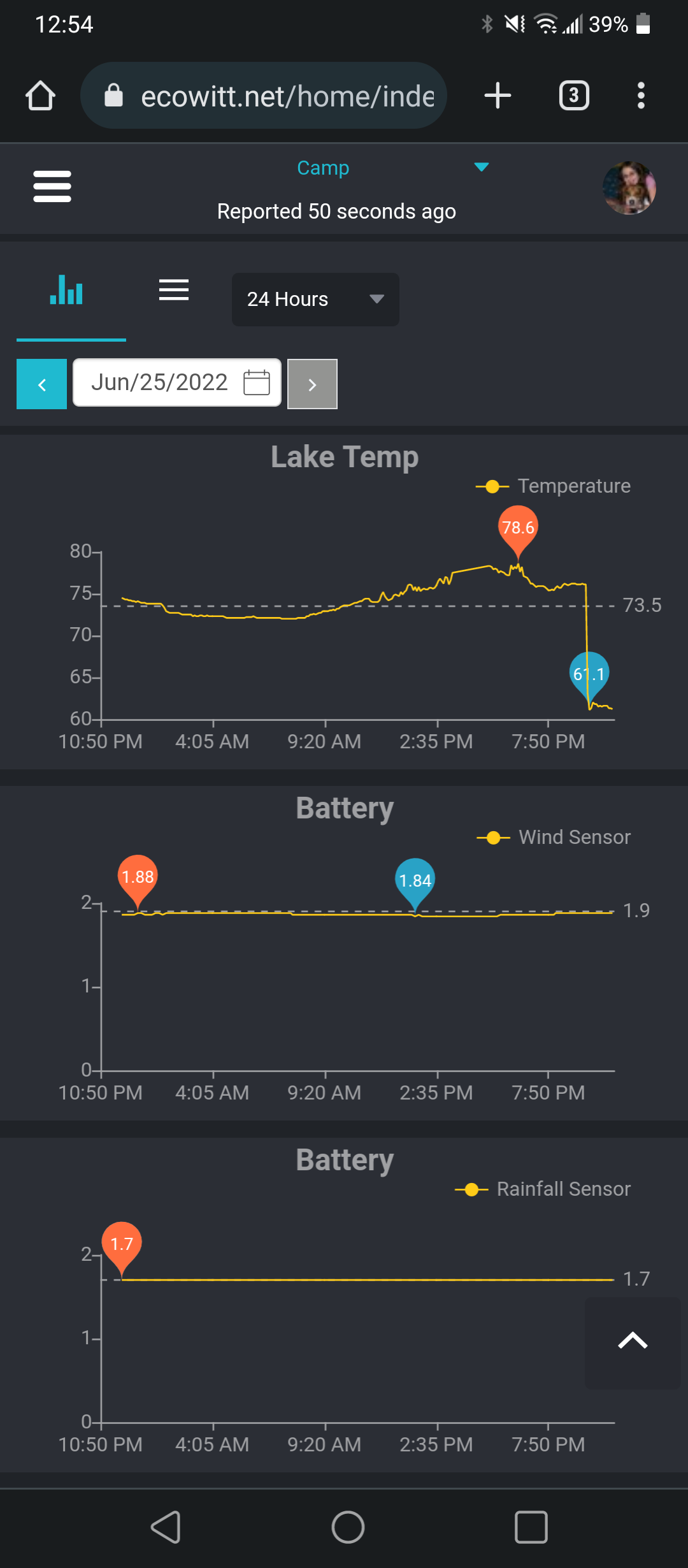

The ecowitt app has no battery info except for wind sensors. The ecowitt.net has battery info for all sensors if you goto your info there. Ie

Thats not what i am looking for.. if there are no other actual temp events the batteries are dead.
I have at least 20 wh31 between 5 weather station installs and all are reporting battery correctly. My guess is something wrong with the stall or the version you are running if all show that try reinstalling.

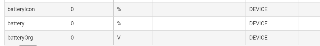

I have the WH31 multi channel sensors. I have 8 of the sensors around my house and all 8 started reporting 0 battery on the 19th of June. I am still getting temp and humidity readings on all the sensors. The Ecowitt webpage says al l the batteries are NORMAL.
