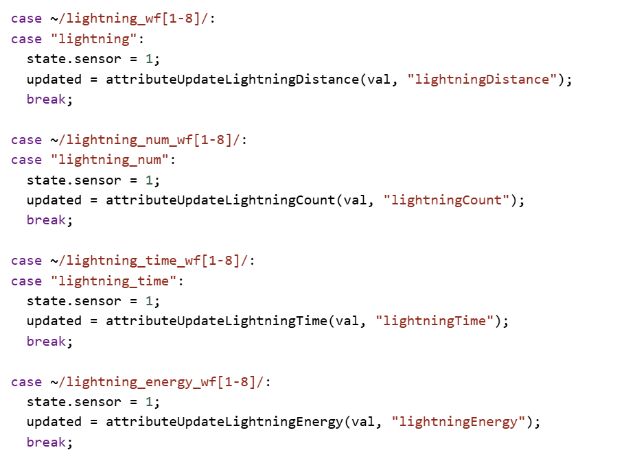

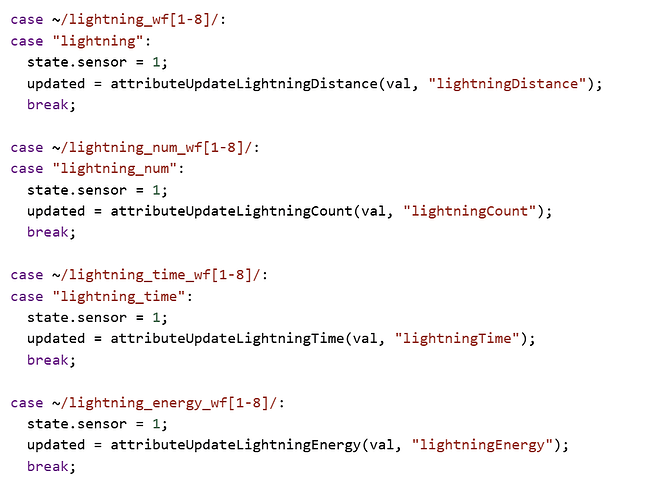

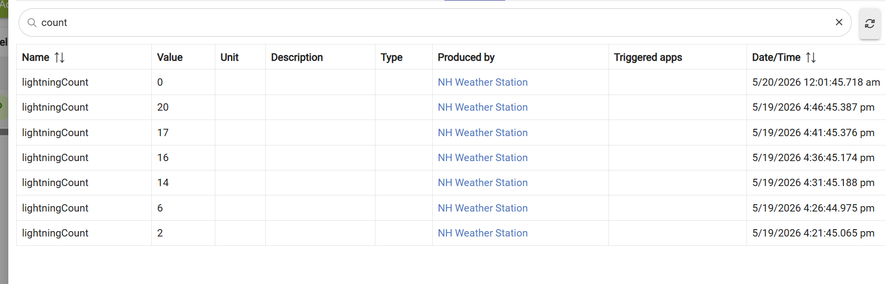

The app is subscribed to lightningDistance on your lightning sensor (line 706), but looking at the Ecowitt RF Sensor driver, the attribute it actually fires events on is lightningCount — not lightningDistance.

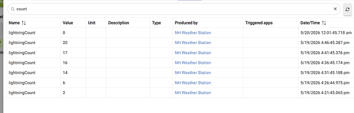

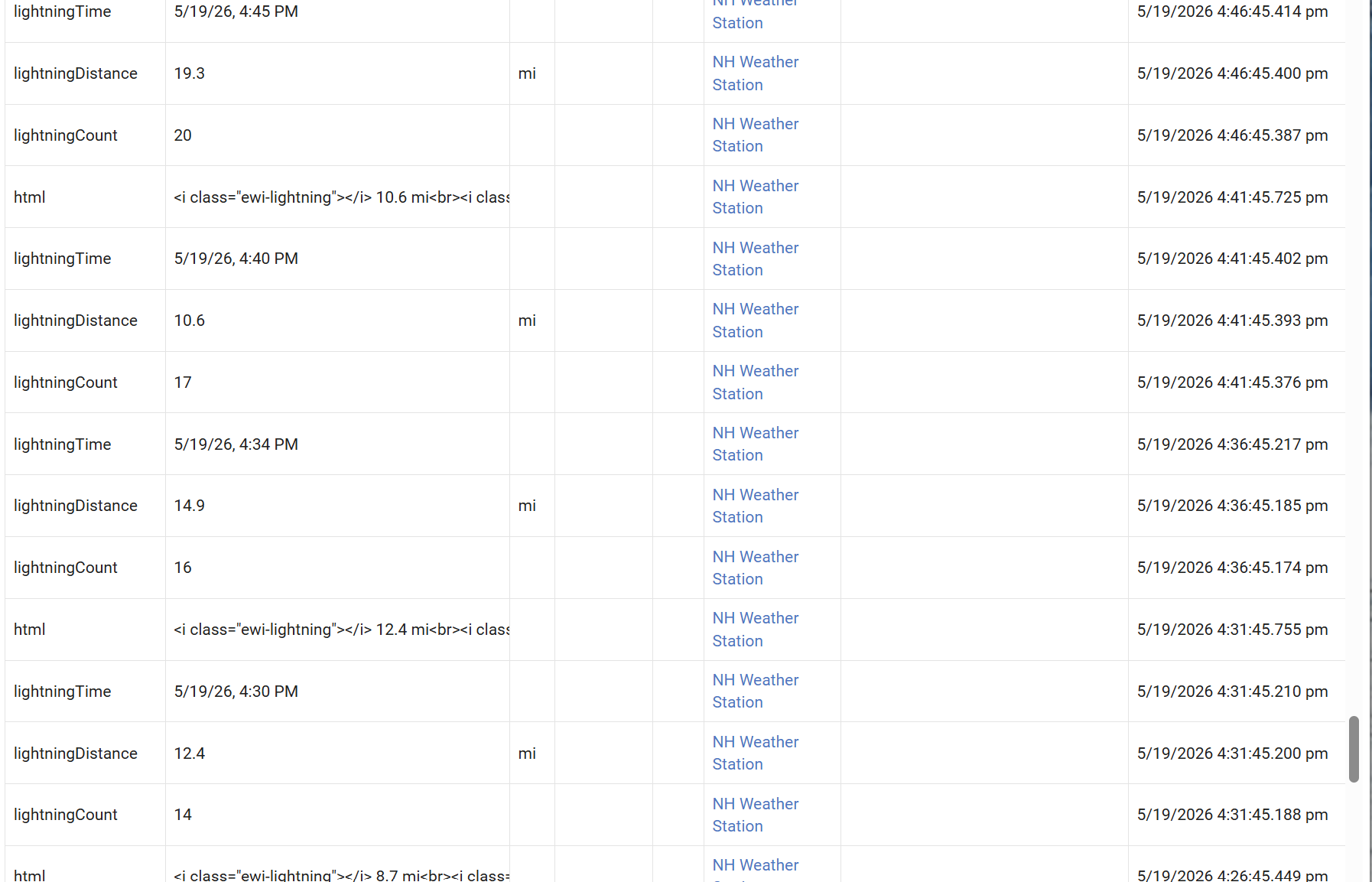

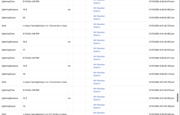

From the Hubitat events screenshot, you can see your sensor is emitting lightningTime and lightningCount events. The lightning handler is simply never firing because it's listening for the wrong attribute name.
There are actually two bugs here:
Bug 1 — Wrong attribute subscribed:
groovy
// Line 706 - what the app does:
subscribeMulti(sensorLightning, ["lightningDistance", "distance"], "lightningHandler")
// What your Ecowitt driver actually emits:
"lightningCount" ← this is what triggers
"lightningTime" ← paired timestamp
Bug 2 — lightningCount is a cumulative daily count, not a per-strike event. The app's lightningHandler treats each event value as a distance reading for storm vectoring, which won't work correctly with a count attribute.

- Handles the daily reset when count goes back to 0 at midnight.

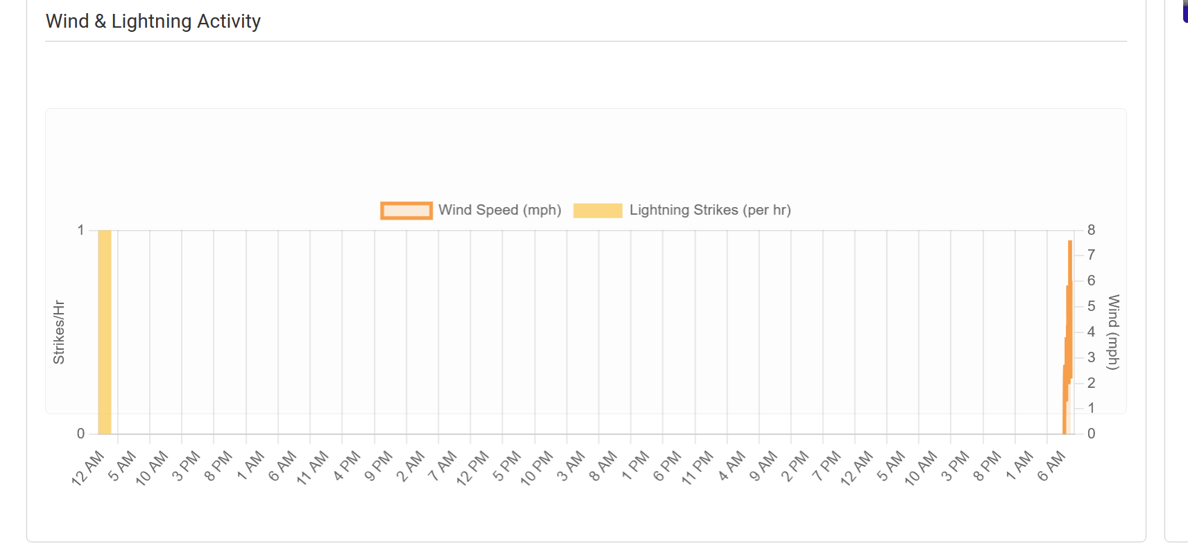

Force Matrix Evaluation to confirm it picks up your sensor
You should then see the Light[] counter in the diagnostics telemetry bar start populating when lightning is detected, and the thunderstorm matrix will react in real time rather than only on the timed poll cycle.
