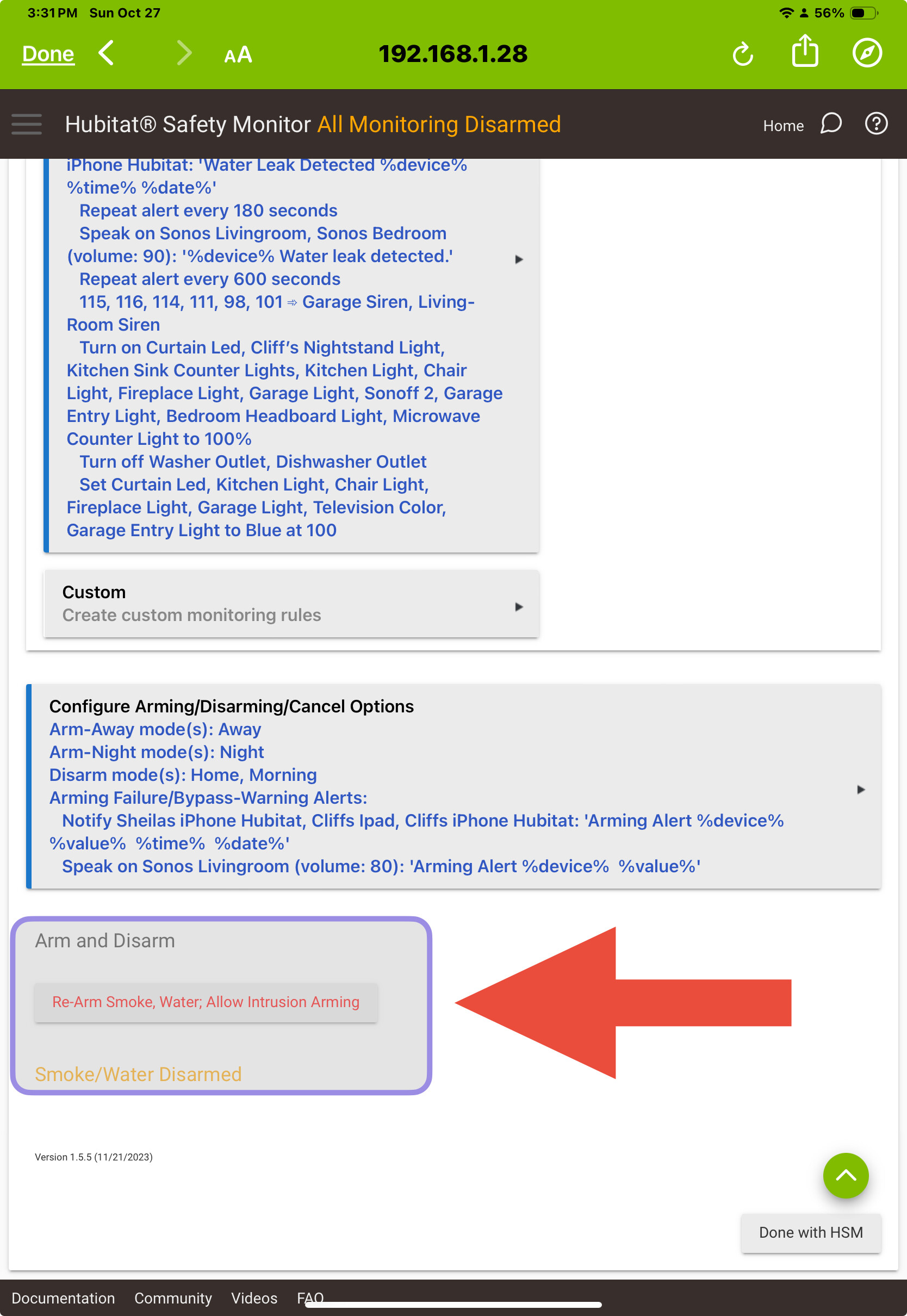

Is there any way to write a rule or other to trigger or activate this button in HSM, other than to fumble around on the app to get to this button and manually activate? If not, WHY NOT? Hubitat is about automation, and you cannot automate any device to trigger this button currently. I’ve been told this is not possible by those in the know. I would surely like to know why.

Yea, I just can’t understand why this can be a part of a drop down in a rule. Seems so pointless not to have this option.

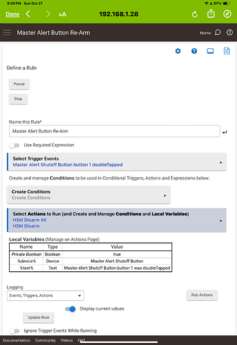

It is, although you may need at least two actions, depending on your end goal. Did you try the solution posted in your other topic? I'm not sure why you created a duplicate topic:
If you are still having problems, I suggest sharing your entire rule plus logs.

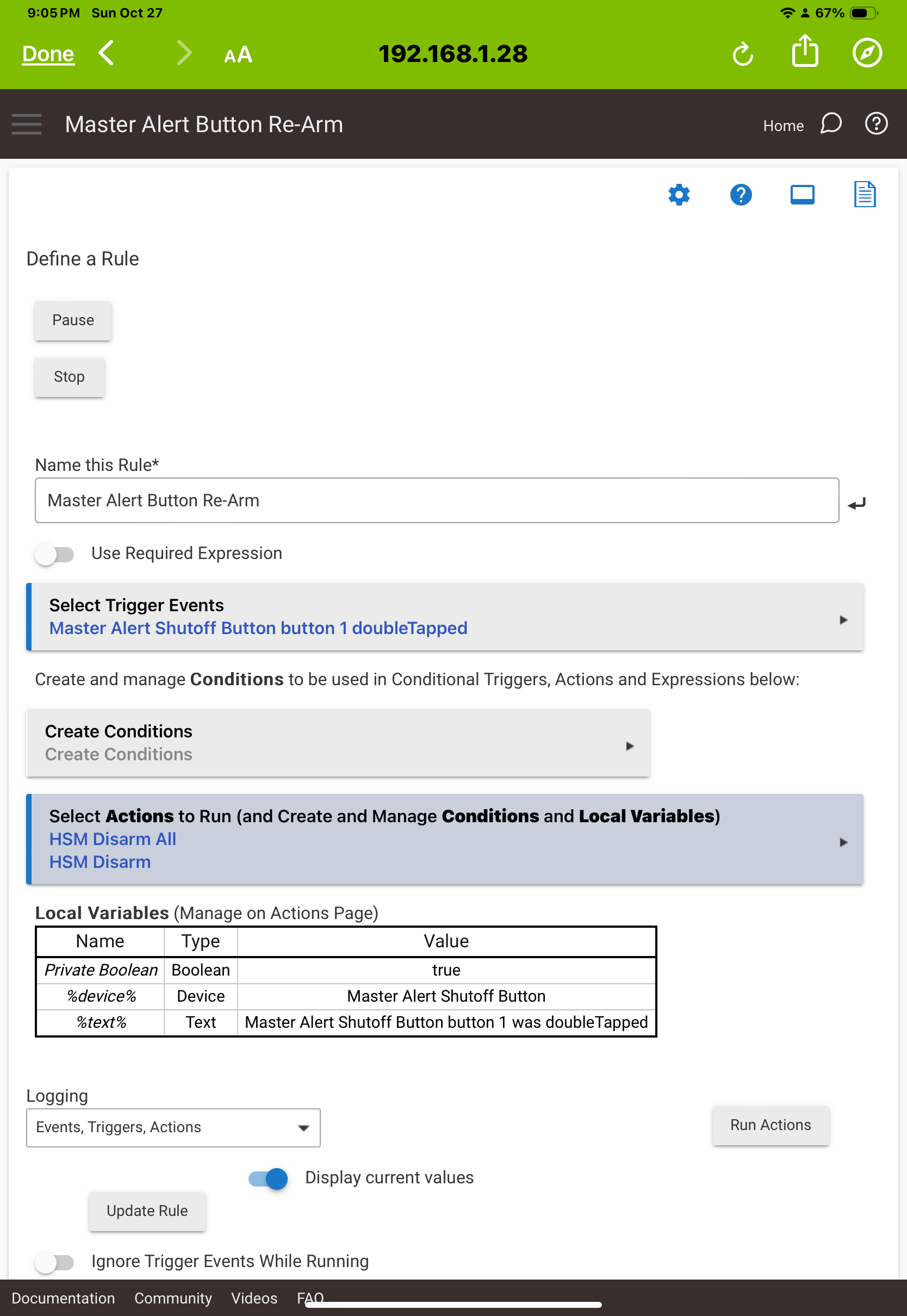

Okay so this works to “re-arm” smoke and water like I wanted. I’m just confused as to why we are using a “disarm” function to “Arm”. Seems a bit confusing.
Maybe. :slight_smile: But that's the difference between the outcome behind "Disarm" and "Disarm All," per the explanation in the other topic.
