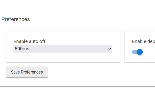

A virtual switch can do auto off in 500 ms (half a second).
I just tried it on a GE switch.

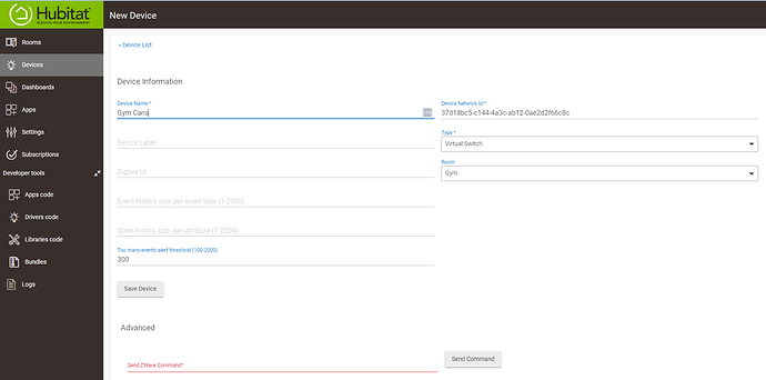

How do I do a virtual switch?
you go into Devices and Add Device. Then on the next screen you choose virtual, and then pick switch on the dropdown.

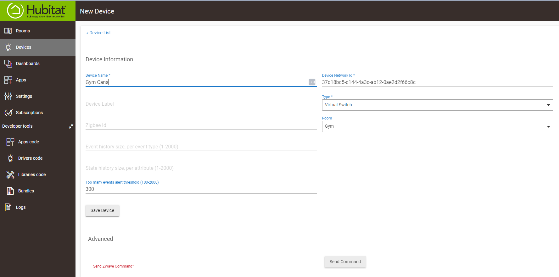

I'm not seeing the preferences, or anything that makes sense. Sorry, I'm new to this. Here is my screenshot:
I think you have to save device first.
It's under Preferences.
