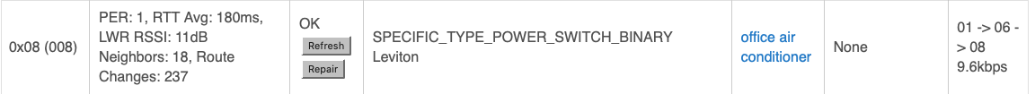

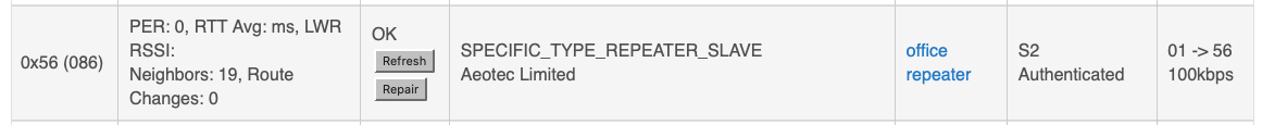

This is my favorite example... I have a Leviton ZWave outlet controlling my office air conditioner. It has a crappy connection and changes routes constantly. Device 06 is a mains-powered repeating device that sits close to the hub.
And in the same room, maybe 6 feet away, I have a repeater... that the Leviton outlet won't use! I've repaired, I've even excluded and re-included. Usually after I do one or the other it starts using the repeater for a while and then reverts to a repeater right next to the hub.
