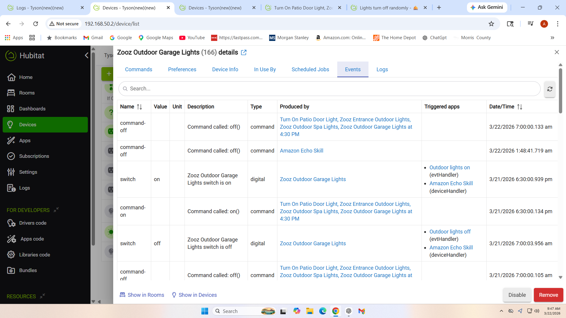

I had this problem before and it was Alexa hunches. Alexa hunches are turned off and the problem has returned. 3 lights grouped together and one of the three turn off at different times. I notice on the event on second row that command (off) issued by Alexa.

Yes I checked and there are no routines. Strange thing I asked Alexa if there were any activities last night or this morning and reply was no but when I went on the app it showed activity. Is so random and only happens with the outdoor lights. I have a dozen indoor and no problems.
