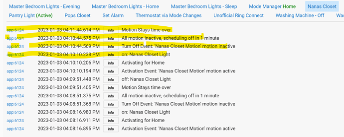

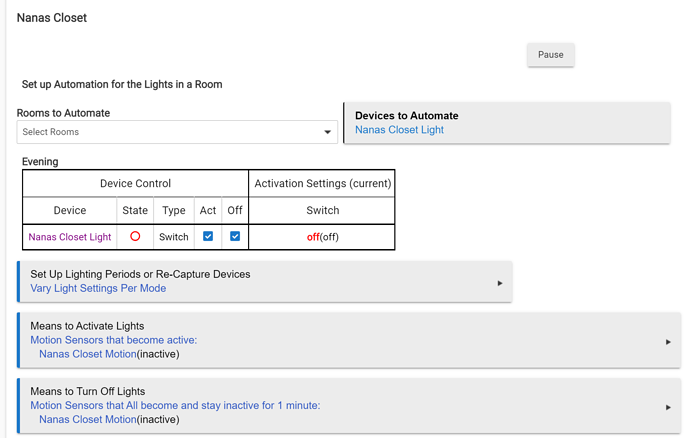

My wife's closet light, turns on with motion, off after 1 min of no motion

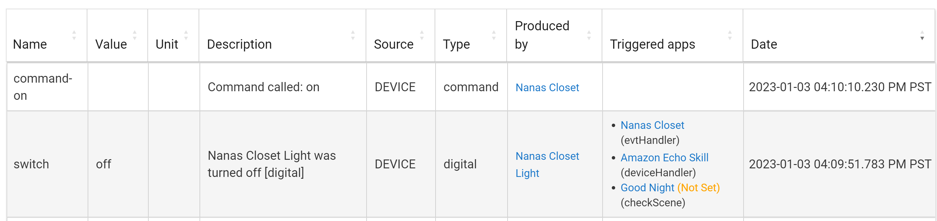

Light came on at 4:10pm, motion stopped less than a min later, timer ended about a min later yet the light was never called to turn off

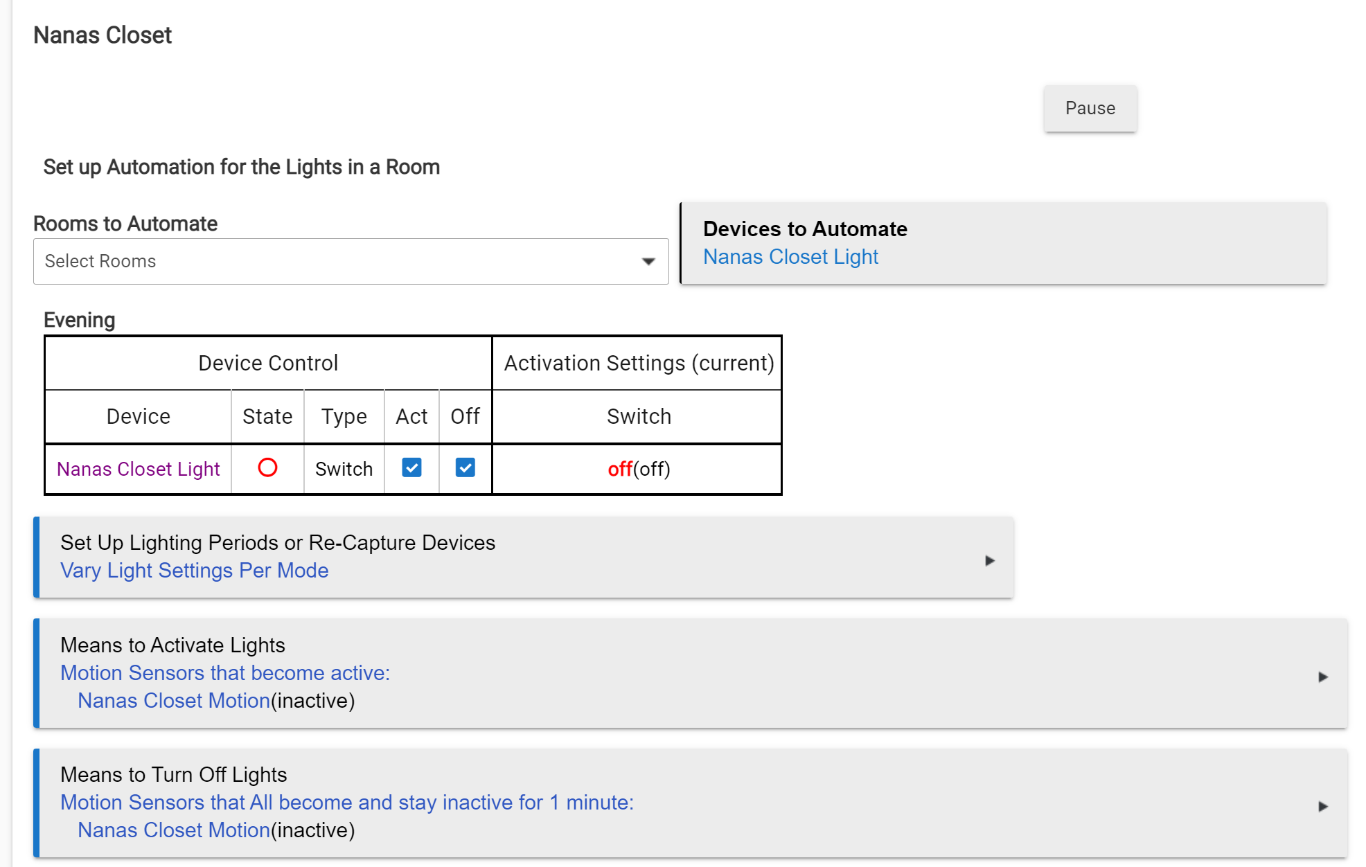

Here is the RL rule

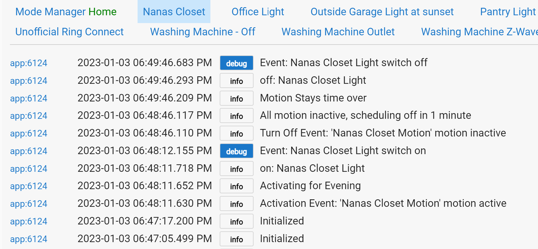

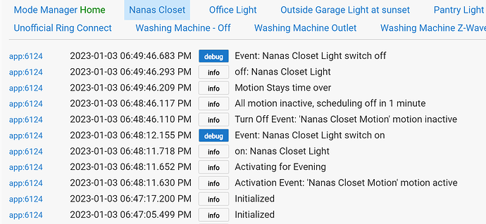

Here is the log
Here is the device log
In this case, I turned off the light via the RL Rule and that isn't showing in the low either....

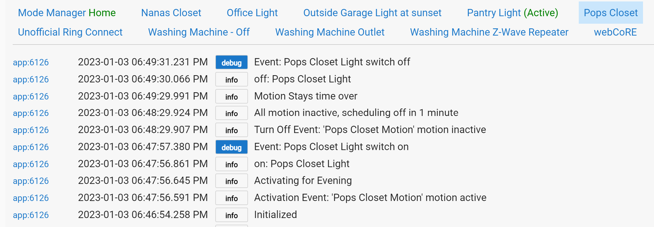

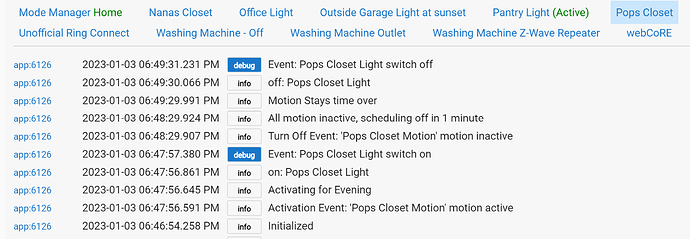

Last week it was my closet light same setup
C3 running 2.3.4.128
Am I missing something here?

Before I saw your post, my closet light did the same thing...
Turned on debug on both RL Rules and they both ran just fine and the lights turned off, go figure
