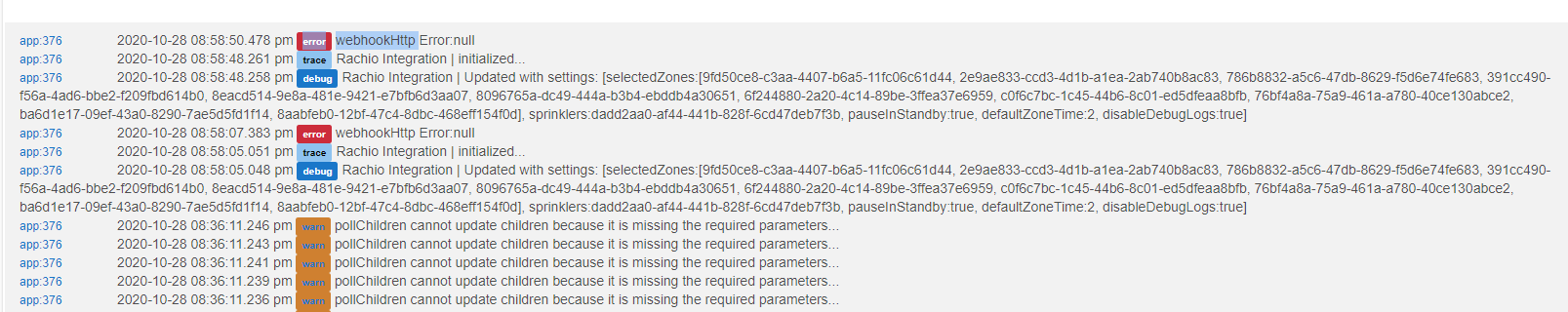

Rachio integration suddenly broken
this is using the built in driver..
any ideas
When a cloud integration suddenly stops working, I would first suspect cloud availability or an unannounced API change.
except this is the built in stock app, how do i get someone from support to look into this.
still ocurring anytime i try to save the app

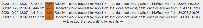

I've been getting these also as well as what've been reported here. I do not have app 1141 or 1231 anymore on my HUB. I think those are old instances of the Rachio Integration app. Not sure how to get rid of this since it seems to be from Rachio cloud.

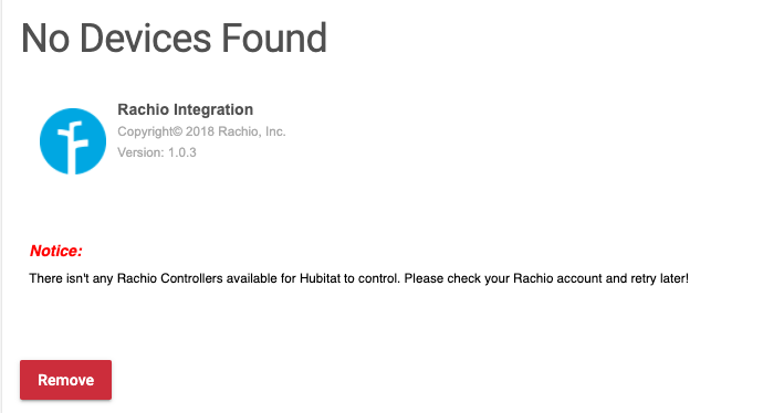

I'm having the same issue. Here's what the app shows:
Screen Shot 2020-10-31 at 10.26.48 AM
Well, I solved it for me. Removed the app then added the app back in. Of course, that also meant I had to put all my zones back in dashboards and apps - fun.
