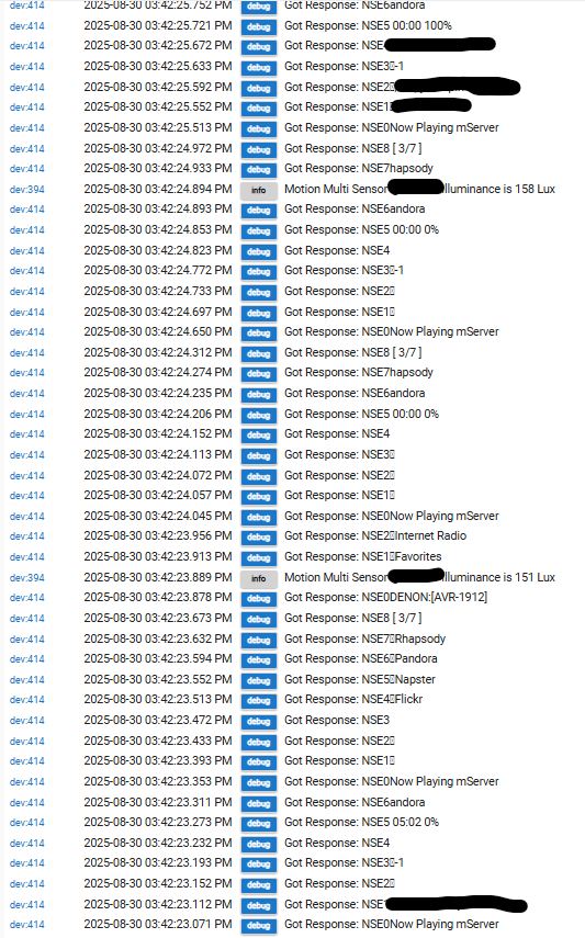

Today, for the first time ever, I happened to look at the logs while the receiver is playing and was shocked at the amount of activity the Hubitat is logging while the receiver plays. I presume I have something incorrectly configured, but since I barely got the thing connected, I'm now throughly beyond my expertise. What setting do I need to fix?

Here is an image of the Log:
(All of the Debug entries are the AVR-1912; the blacked out entries are where the artist, album or song are reporting on the Hubitat log;
the only other entries are changing lux at a MultiSensor; blacked out part is part of name)
Turn off debug logging

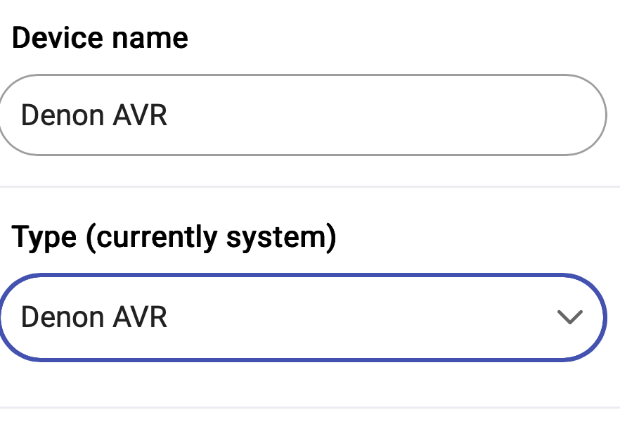

In addition to what @marktheknife noted:
First, while this forum regularly refers to drivers, there is no data within the device details labeled "Driver." The driver is on the Device Details tab, under "Type." So Hubitat calls a Driver a "Type."
Second, I also know if you select a user created driver, you get a little blue note to the right of "Type" labeled user which you can click on and will take you directly to the driver code. But if you select a Virtual or System driver there is no note detailing that (or link to it for that matter).
Third, the name of the driver is insufficient for people to clearly recognize whether it is a System or Community driver.

And I'm still trying to figure out how to stop the Denon receiver from sending 18 messages per second to Hubitat whenever the receiver is on....does anyone have any additional ideas?

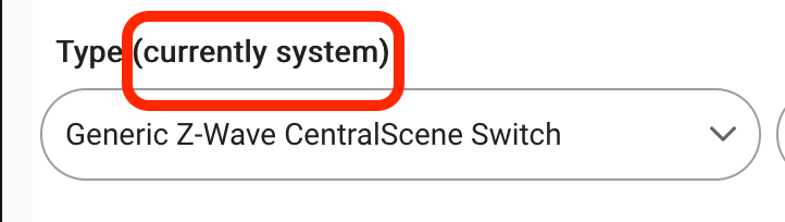

There is a note detailing this:
There is no link in this case because this does not make sense for built-in drivers. User drivers are custom code you have added to your hub. Their source code is visible to you, and this is what this link points to. Built-in drivers (and apps) are included with the hub software and closed-source.
This can be confusing, but I think less so now that the hub notes this for you.
This detail was probably just missed by whoever asked. There's always a lot of information to go through when dealing with peer-to-peer help like this, so you'll find that once in a while. This information is also fairly new to this location in the UI, so not everyone may know to look for it. Never hurts to provide whatever information you know, however!
