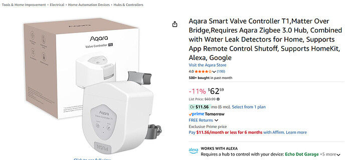

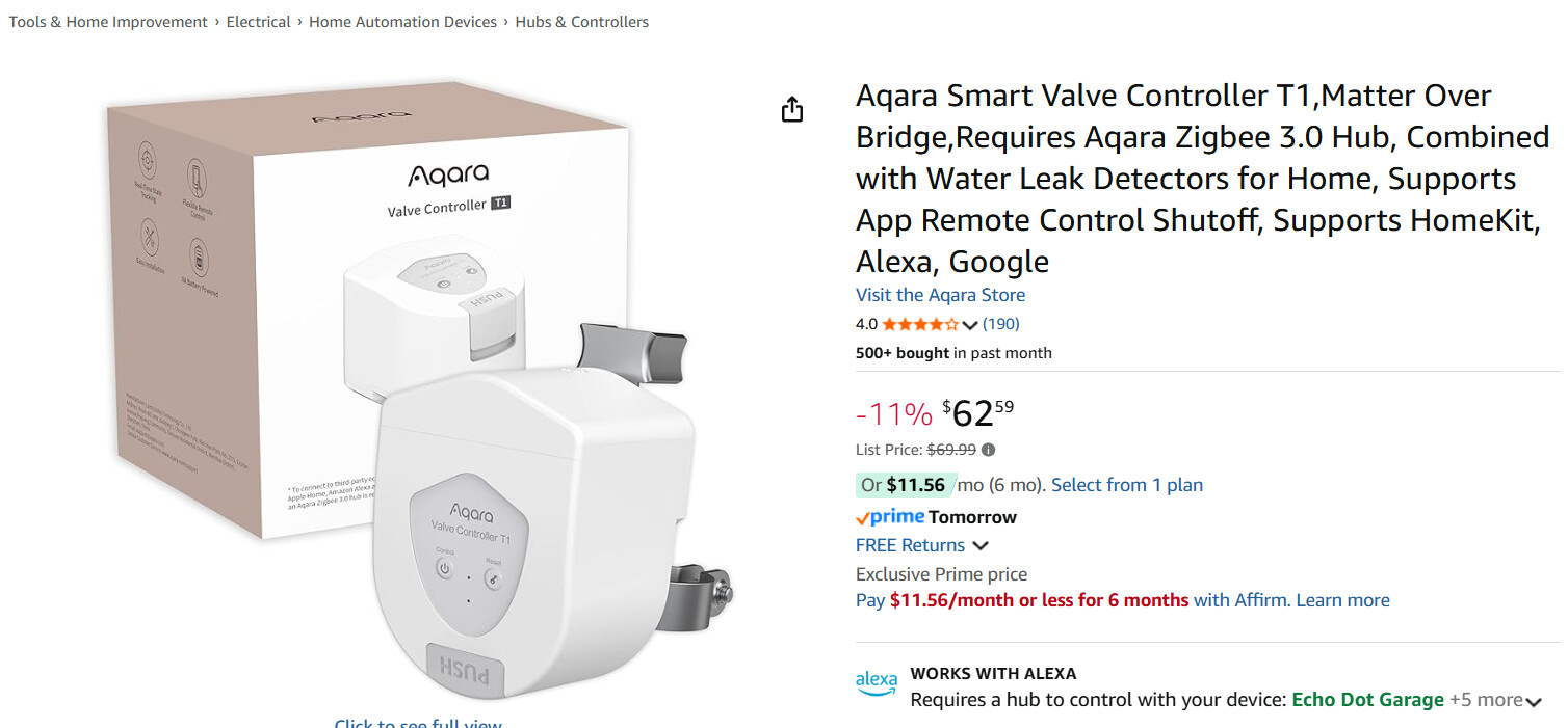

Question regarding the Aqara Smart Valve Controller and Sensors
I read that the Aqara leak sensors can connect directly to the Aqara smart valve. That sounds like a good idea if there were a power outage. Can anyone tell me if while connecting the sensors directly to the smart valve, you can still configure and control them from the Hubitat?

This is incorrect information. The Aqara T1 valve and sensors are both zigbee end-devices that must be paired to a zigbee coordinator, like an Aqara hub or Hubitat.
Automations run on the coordinator control the valve.
What that is referencing is if you connect the sensors and the shutoff valve to an Aqara hub, then inside the app in the valve options section you can link the sensors to the valve by choosing them. This means not having to write an automation to shut off the valve if the sensors detect water.
This means they can't be connected to HE because they are connected to an Aqara hub.
