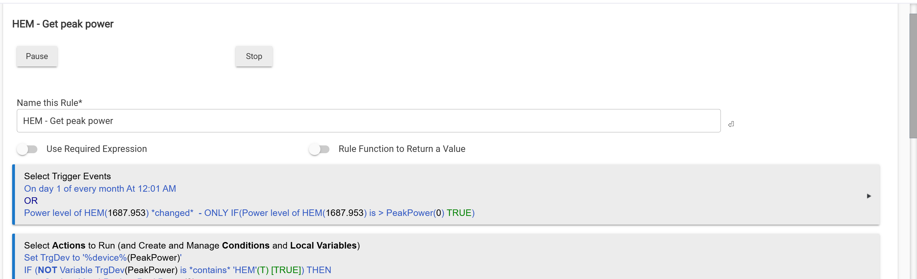

I have a rule that had been working. It is pretty simple. It monitors the power reading from my HEM and stores the max power reading for the month.
I don't really look at it that often, but I had a issue with the HEM due to my recent migration from a C8 to C8pro. I have been checking out all my rules and I noticed that I had not got a notice of a max power update in a while.
See trigger below. The first action of my original rule set a string variable to %device%. If the variable did not contain HEM then it should be Triggered, I couldn't remember for sure what %device% would be equal to for the time trigger, so my rule assumes if %device% did not contain HEM then it's the monthly trigger.
The problem is that %device% is also being set to PeakPower when ever the PeakPower variable is changed. I am pretty sure it did not do that originally. Since %device% is PeakPower and does not contain HEM, it does the month end reset and PeakPower is set back to 0.
It was a simple fix to account for the extra trigger, but is this a change or has it always been that way? I am sure the rule worked when I originally created it. It was some time ago so not sure when it stopped working.
tldr: In the trigger below, should PeakPower changing trigger the rule?

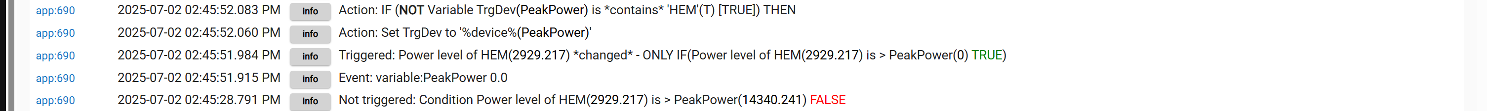

The first screenshot shows the trigger. It is now a conditional trigger that says trigger if HEM changes but only if it's value is > PeakPower.
In the second screenshot, it shows the log. The first line that says not triggered was a change of power on the HEM. The second line event occured after I manually changed the PeakPower hub variable to 0. The HEM did not change only the PeakPower variable, yet the rule triggered. Setting TrgDev to "PeakPower".

It seems easy enough to test for %device% being set to PeakPower and exit the rule, or use two rules, or check the condition in the rule actions.

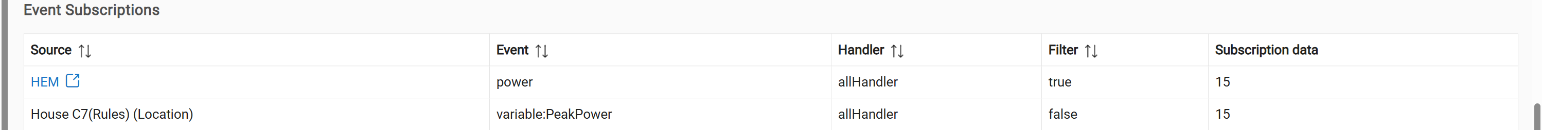

Please show the Event Subscriptions for this rule. Did you hit Update Rule after changing the trigger??

I did hit update. I just made sure. I opened rule, hit update rule and then clicked done. Same thing rule triggered when PeakPower set back to 0.
That's odd, and not right; the variable subscription is wrong. I just created a trigger like yours, and there is no Event Subscription to the variable. Please remove the trigger completely, hit Update and then check the Event Subscriptions. If there is still one for the variable, you will need to remove the entire rule and recreate it.
Apparently a hold over from original rule. I am pretty sure I deleted the original trigger before creating the new one.
This time after deleting the condition I closed the trigger page and checked to make sure the event subscription was gone and it was. I then tried to recreate the new trigger. The condition still existed but it would not let me use it as a conditional trigger. I could select it as the condition, but it would not give me the done with trigger button. I had to go to the condition manager and delete the condition. Then when I added the new trigger and recreated the condition again, it worked. The event subscription to the variable was gone and it did not trigger when I updated the variable.
