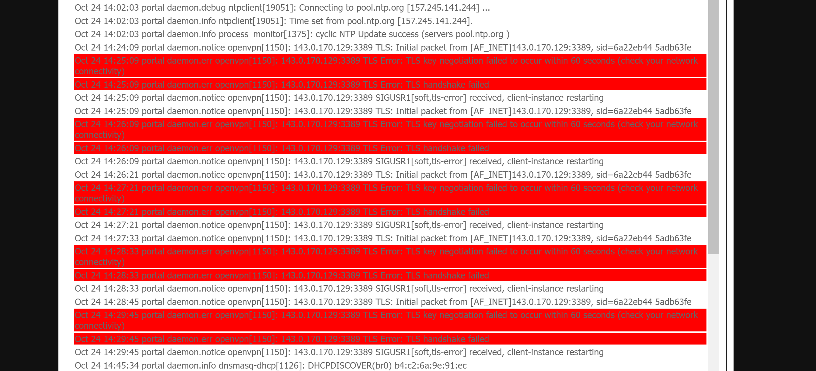

i am getting lots of hacking attempts on my router which maps one public ip to privates via nat..
they are tls packts looking to hack a openvpn server. unfortunately they are on ports that i need to leave open for devices on my private network that uses these like 53 (dns) 123 (ntp).. Anyone know of a way in iptables firewall to block these.. i see a lot of hacking attempts in my router log.
I dont think i can be hacked this way as my openvpn requires certs and not just user name passwords, but i try to block any attempts like this. I have given up just adding the ips to my blacklist as it is a never ending task.

@kahn-hubitat You should close all inbound ports. Set up a rule for anything initiated from a trusted port can go external. That way when DNS is updating (changing it's cycle) it can reach out and read from whatever global dns you have set. Same with NTP. As to your VPN is that done at the firewall or behind it?
Right, so do I (have 2 actually. One on a windows domain, one on a linux box) both are closed inbound so no port redirection from outside in. They're both allowed outbound and automatically update from globals every 24hrs.
VPN is at the firewall itself (L2TP or ikev2) so that handles external authentication. I don't like opening any port redirects for anything. It's un-needed. If you're running a seperate VPN server, I'd put that on a DMZ with a tightly controlled rule from DMZ to trusted.
