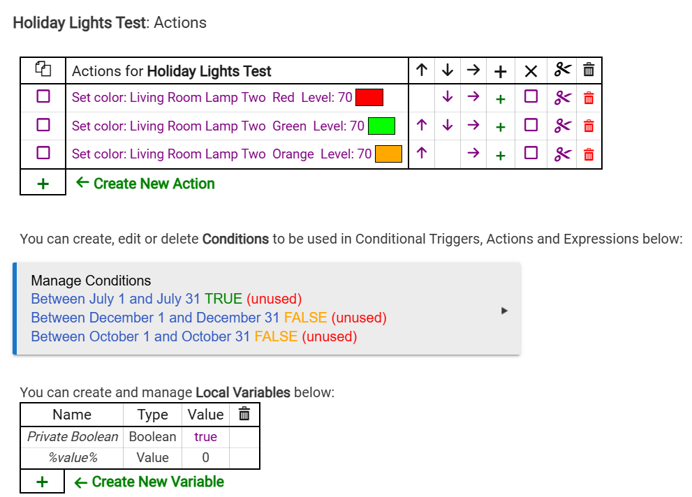

I'm trying to create a rule which will turn a Kasa color bulb a certain color depending on the month. I have several actions, but I don't see how to connect them to the conditions I've defined. For example orange in October, green in December, and red in July. Am I going about this the wrong way?
-Thanks

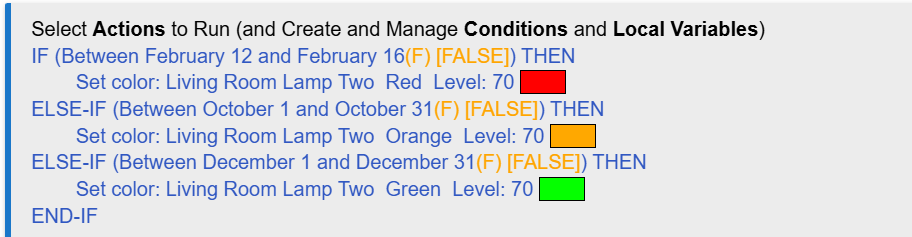

You need to add logic in the actions that use the conditions you set...
For instance, add an "if-then" above the red action, using the condition you set. Then add an "elseif" before the green action, and another "elseif" before the orange action. Then add an endif at the end.
Thanks! It took me a bit to learn how to nest the IF statements.

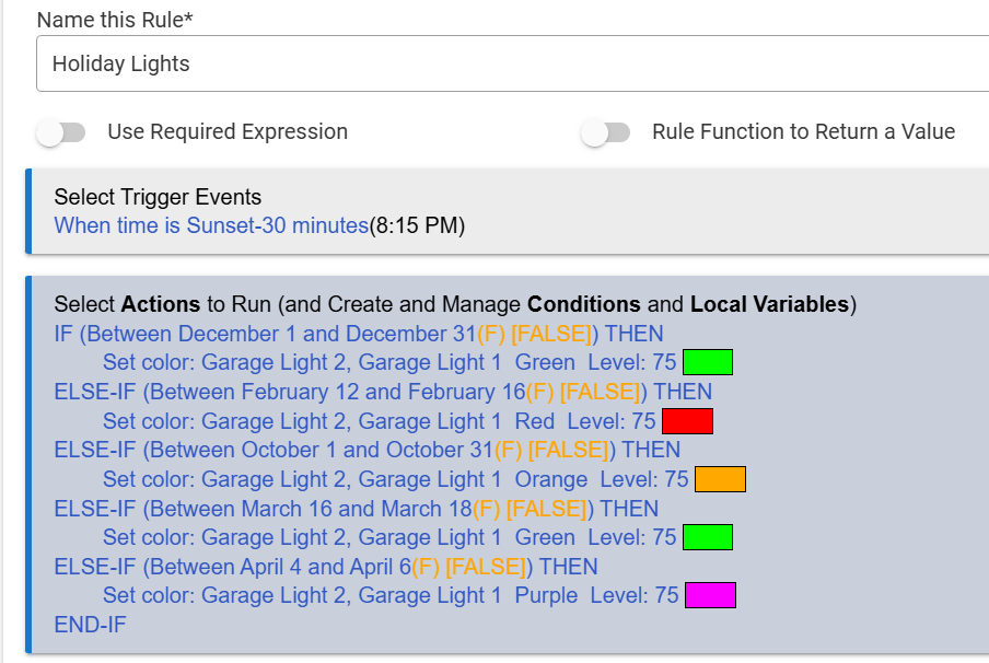

Have you created a trigger for the rule?
Yes, I had the trigger. I found it easier with the conditions already intact, to just create the rule actions from scratch.
