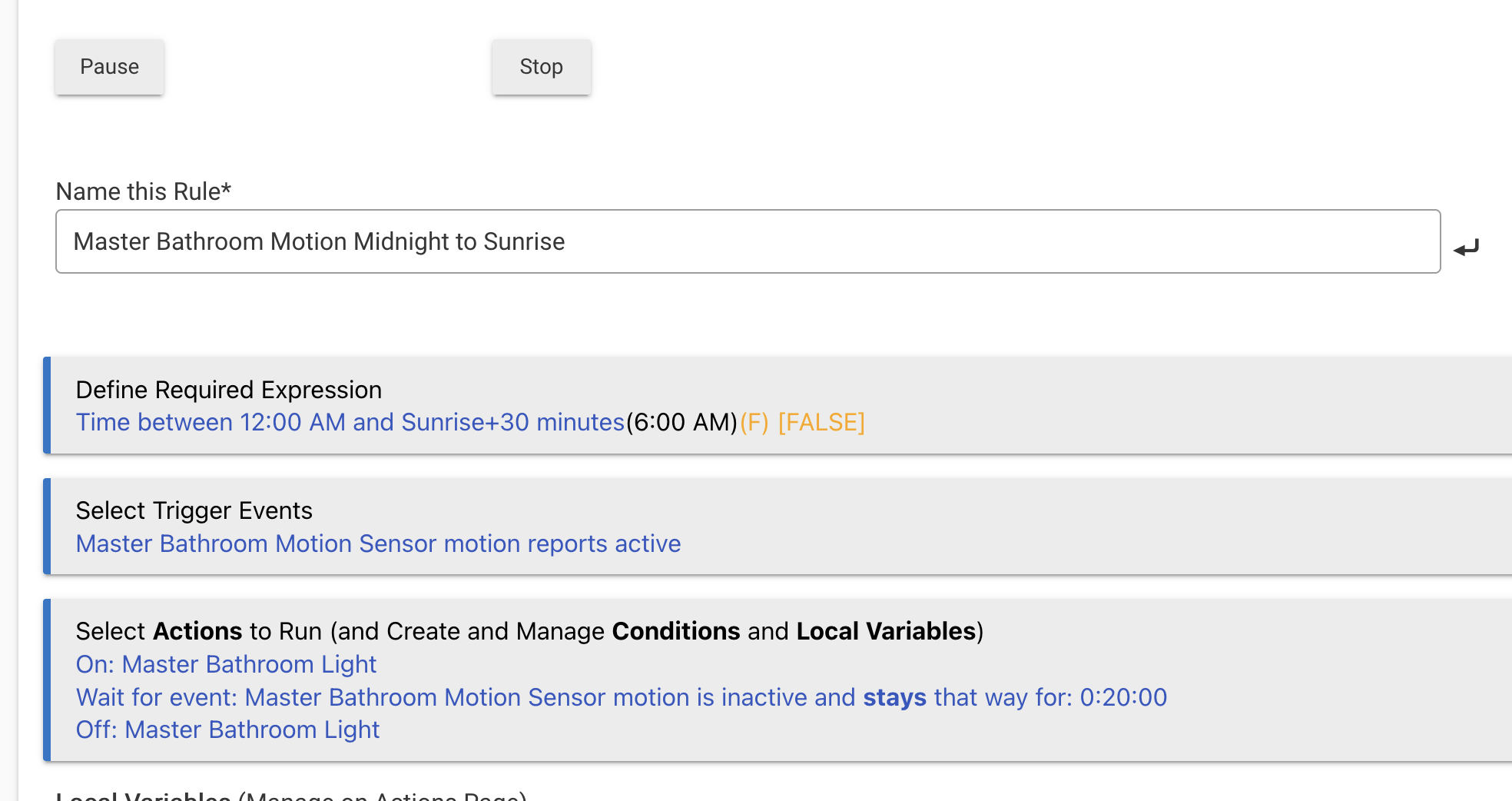

I am using a Sonoff snb03p motion sensor with the Tuya multi sensor 4 in 1 driver in the master bathroom. All night long it randomly senses motion and turns on the light when the door is closed and no one is in there. I am getting frustrated with the light coming on all night long. What could be causing the false motion and is there anything I can do to prevent it? This is the rule that I am using.

You might try requiring that the trigger event "stays that way" for X seconds (e.g., 2 to 5 seconds).
Alternatively, use the Private Boolean = True as part of the trigger, reset the PB from "true" to "false" at the top of the actions, then set the PB back to "true" at the bottom of the actions, so that triggers during the "lit" period don't affect the lights.
