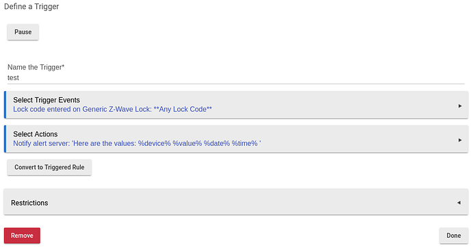

I'm using Rule Machine to send a notification when someone has opened the door with a lock code.
How do I send a notification with the lock code?
Like this by selecting "Lock Codes" not "Locks" in devices:
Result from my txt msg is this (I added separators for clarity):
Here are the values: Generic Z-Wave Lock | Main House Code | 02/25/2019 | 09:30 AM
Hope this helps!!!
E.
