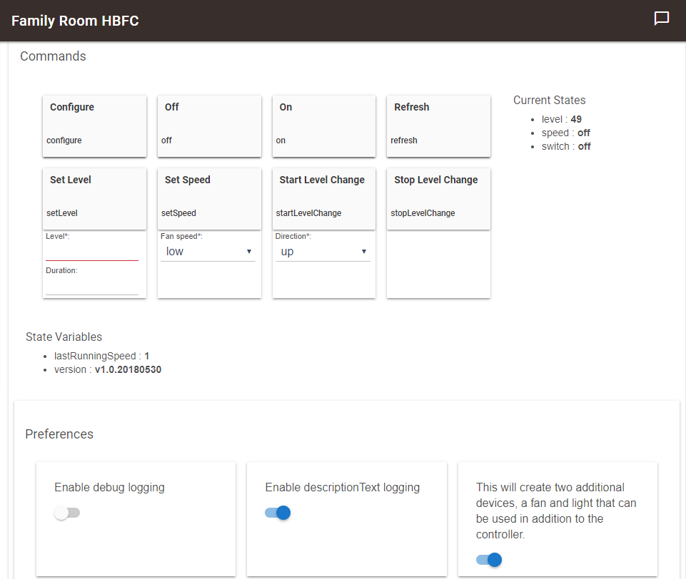

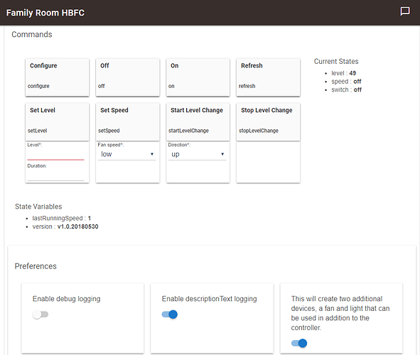

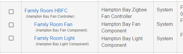

Using the built-in driver for this device, you will initially get once device. Within the user preferences, there is a switch to enable the creation of two child devices, one for the fan and another for the light. It works very well.
Great. Exactly what I was looking for. Guess I need to get a couple of them then :slight_smile:
