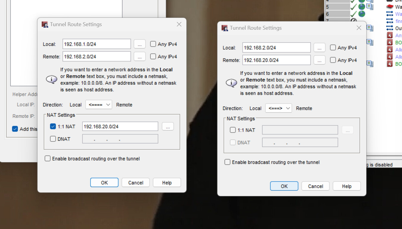

@j715 You can do it with a Watchguard. You can either do 1:1 via vlan or VPN... Here you can see on the left the destination network is .1.x but maps to .20.x and the one on the right just goes to .20 (you can set this up both way either for the full subnet or just individual ip's
